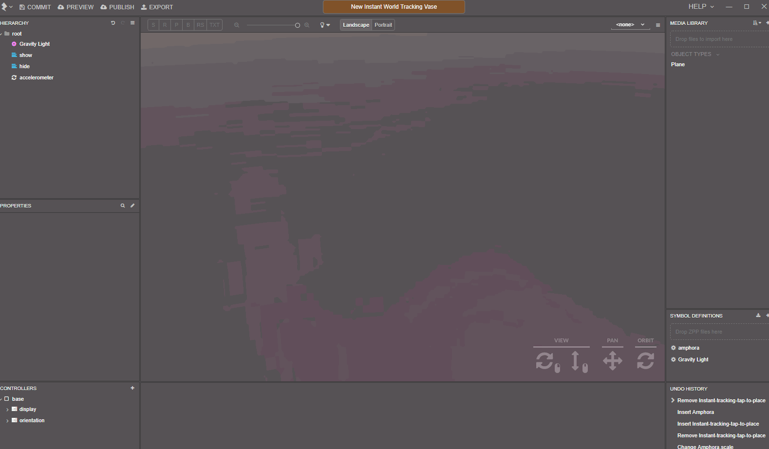

- Once downloaded, drag this subsymbol into the Symbol Definitions panel.
- Drag the Instant World Tracking subsymbol into your Hierarchy.
- Add your content into the exposed Ground attachment point.
- Preview / Publish.

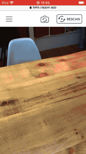

Section titled “Using Instant World Tracking”Once you’ve previewed / published your ZapWorks Studio project containing Instant World Tracking, you’ll need to scan the experience in one of the WebAR sites listed below:
- https://arweb.app (Lite Branded Distribution)
- https://beta.zappar.app (Beta Zappar branded Distribution)
- An Enhanced WebAR Distribution site
Simply head to a web browser and open one of the sites listed above, scan the trigger and your Instant World Tracking experience will launch.

Section titled “Using Instant World Tracking Beta”To use the beta version of this tracking type, follow the same method found above. Once your project is previewed / published, go to https://wtbeta.arweb.app on your mobile device and scan your projects trigger as usual.
