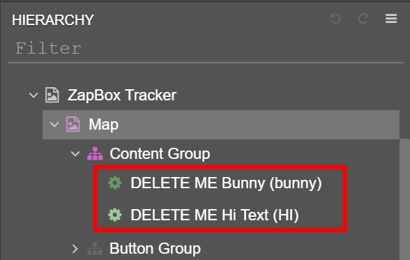

- Delete the Bunny and Hi Text nodes from the Hierarchy.

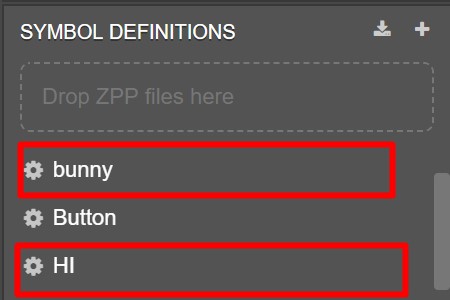

- Delete the Bunny and Hi Text nodes subsymbol’s from the Symbol Definitions.

- Drag the resulting symbols into the ZapBox Tracker > Map > Content Group in the Hierarchy.
