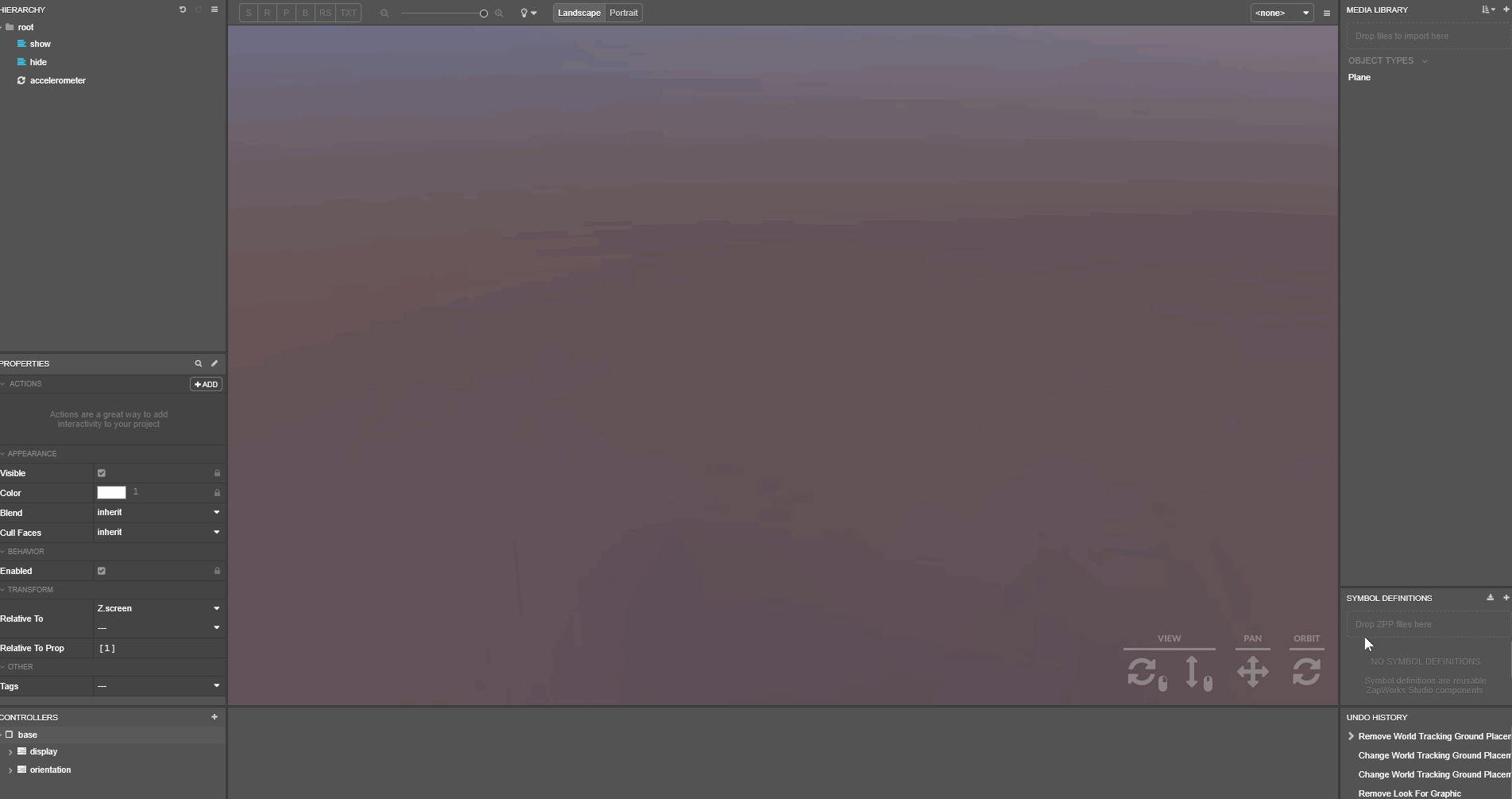

Studio provides a template for creating world-tracked experiences. This is available from the Tracking tab found within the Symbol Definitions import menu.

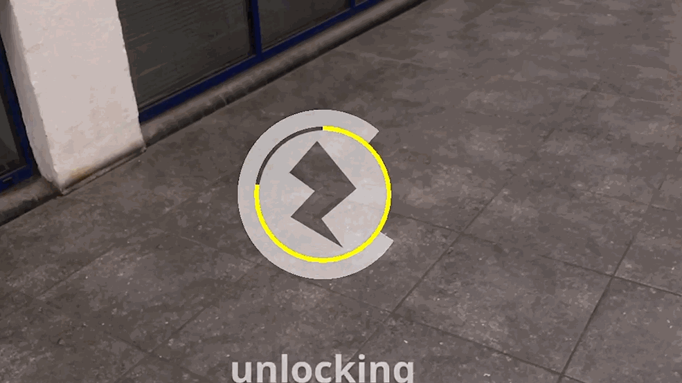

World Tracking Ground Placement symbol
The world tracking ground placement symbol automatically detects the most suitable ground plane in the user’s environment, at which point the user is prompted to position the content in their environment.
This symbol is ideal for creating experiences that require objects to be displayed at real-world scale, such as furniture.
For further information on how the subsymbol can be used and edited, please refer to the World Tracking: Ground Placement symbol article.
The symbol is disabled after the position of the content is set. Content cannot be re-positioned while the experience is running.
