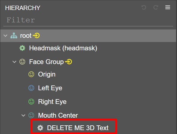

- Delete the 3D Text node from the Hierarchy in the Mouth Center group.

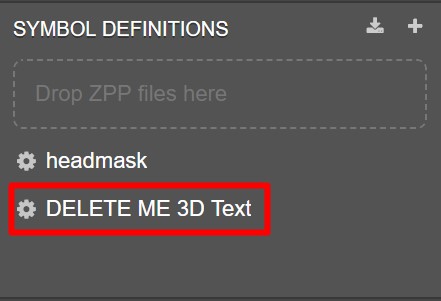

- Delete the 3D Text subsymbol from the symbol definitions.

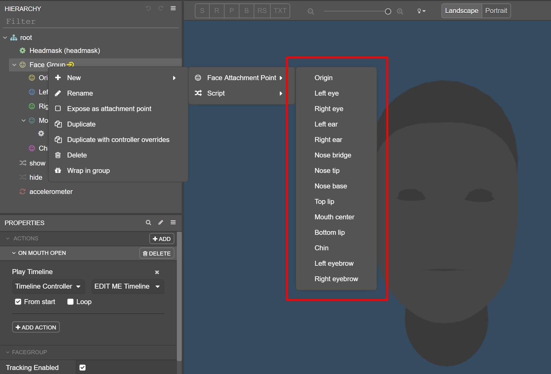

Right clicking on the Face Group node in the Hierarchy allows many more attachment point locations to be added to the face! An article explaining the different attachment point positions can be found here - Face Tracking.

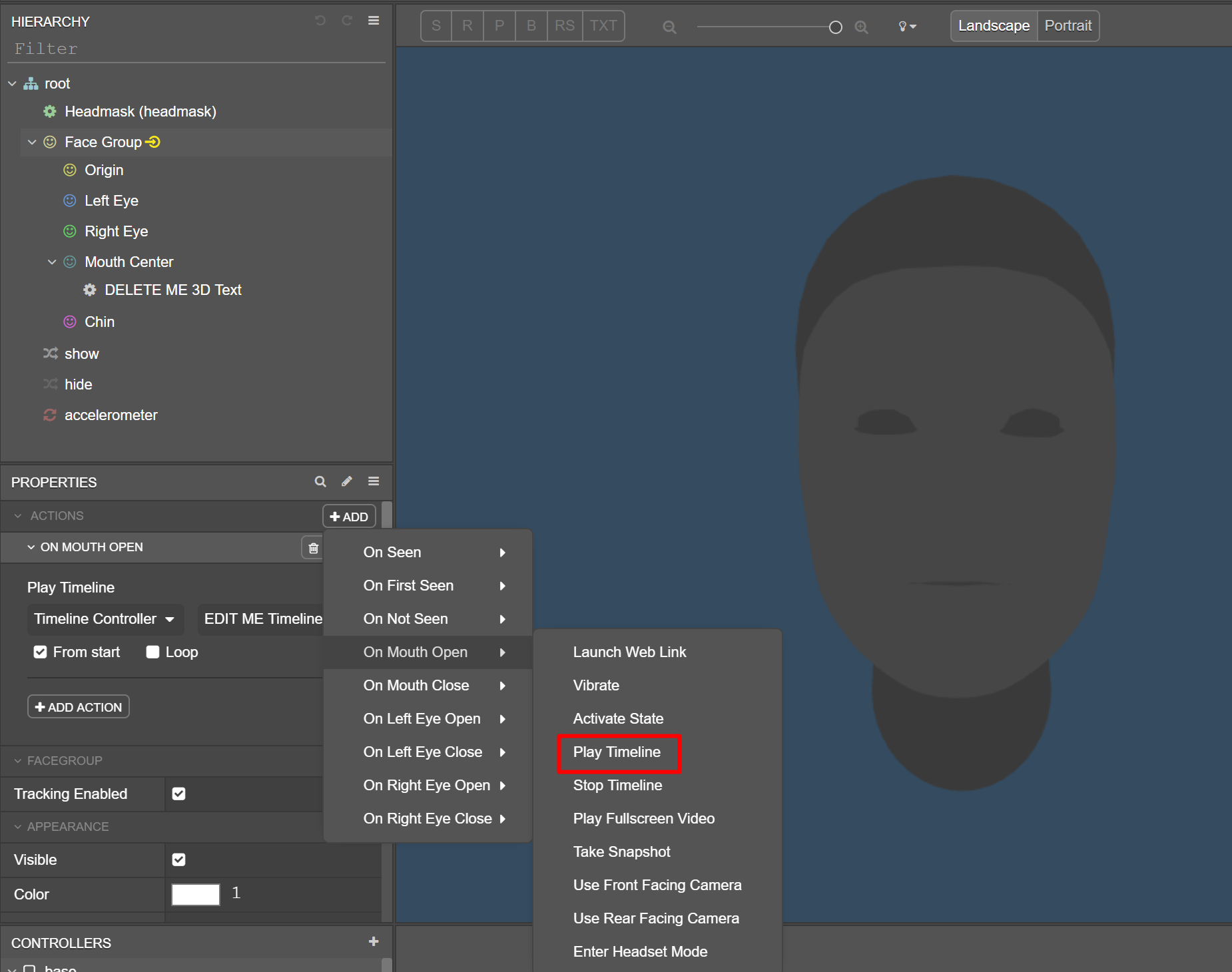

- To modify the face movement trigger, select on the Face Group in the Hierarchy and Click on the + to add an action.
- Select the face movement that will activate the Play Timeline action.
- Add the Timeline Controller and the Timeline to the action properties.
