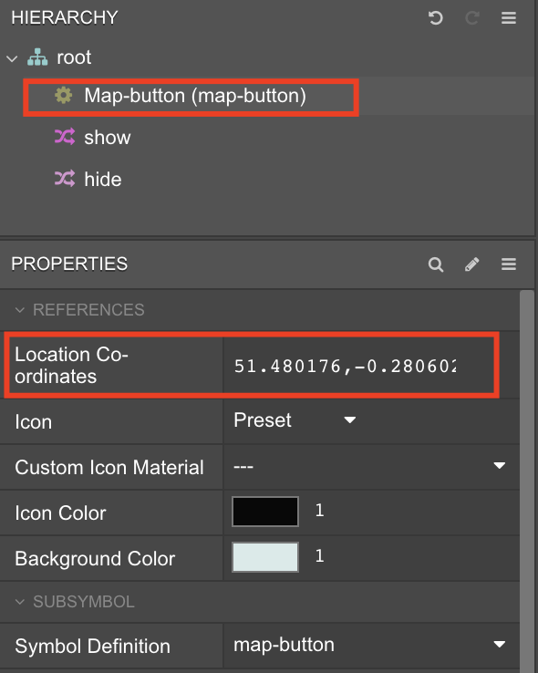

  1. Drag the Map subsymbol from Symbol Definitions, into the Hierarchy in the parent symbol.
  2. Select the Map node and input the coordinate values of the location you'd like to launch to the Location Coordinates property, with the two values separated by a comma.
You can find a location's coordinates from its Google Maps URL, as shown below.
