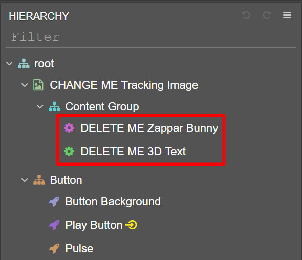

- Delete the Zappar Bunny and 3D Text nodes from the Hierarchy.

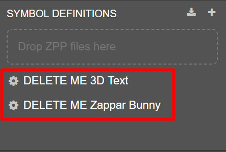

- Delete the Zappar Bunny and 3D Text subsymbol’s from the Symbol Definitions.

- Drag the resulting symbol into the Content Group in the Hierarchy.

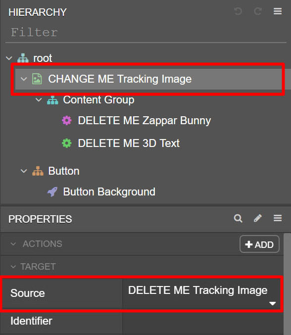

- Select the Tracking Image node in the Hierarchy and, within its Properties, update its Source to that of the newly trained target.
