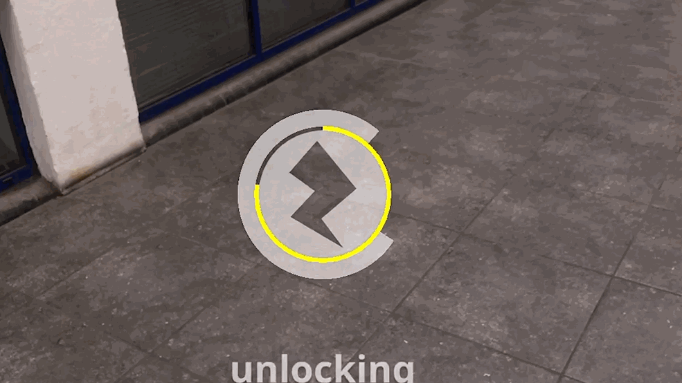

Section titled “How it works”When this symbol is first activated it will attempt to find a suitable ground plane in the user’s environment.
If a good quality surface is detected, the content will become visible and the user will be prompted to position it along the ground plane.
Once the position of the content has been confirmed (with the Tap to Place option), it will remain constant for the duration the experience.

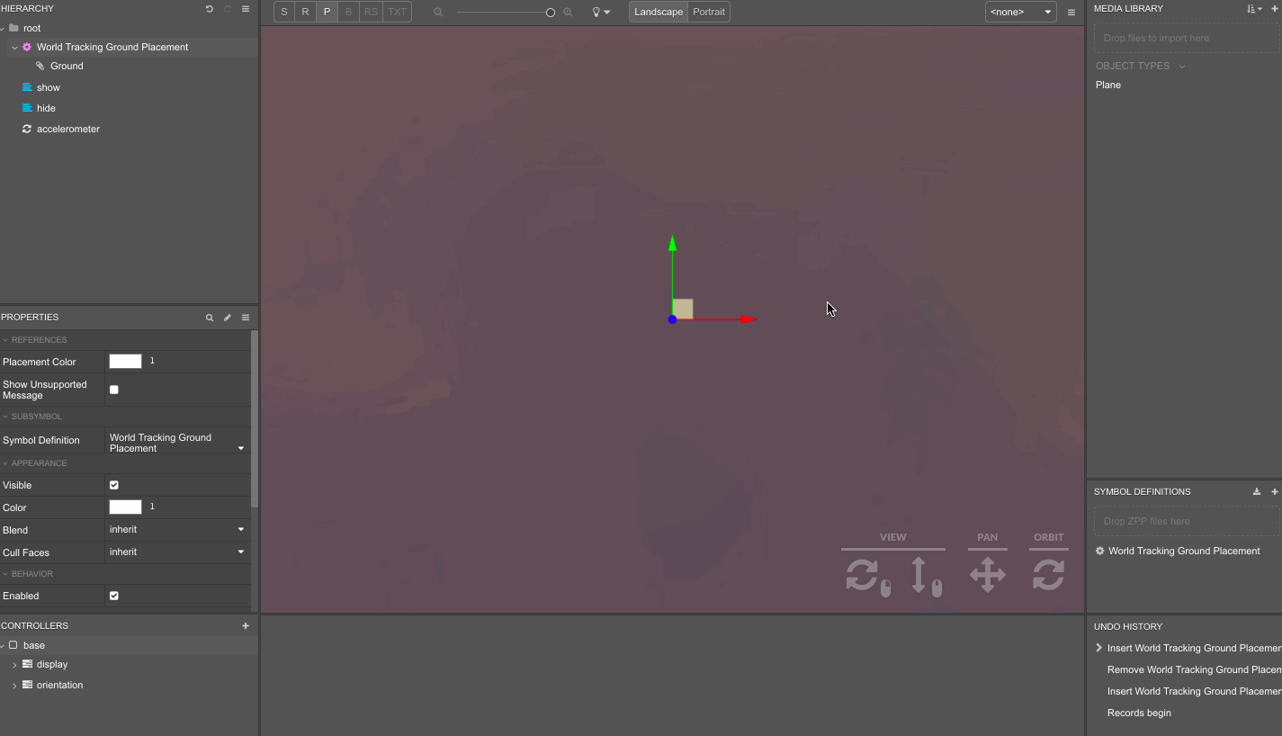

Section titled “Creating a World Tracking Ground Placement symbol”A World Tracking Ground Placement symbol can be added to a project by clicking on the plus icon + from the Symbol Definitions panel, and selecting the World Tracking Ground Placement component.
How to use the World Tracking Ground Placement
Section titled “How to use the World Tracking Ground Placement”- Once the World Tracking Ground Placement subsymbol is added from the Symbol Definitions panel, drag it into the Hierarchy.
- Next, place content into the newly exposed Ground group.
Content placed within this group becomes relative to the ground anchor. To see the content in the viewport, make sure the Ground Anchor is selected from the Viewport Target options.
- Edit the World Tracking Ground Placement subsymbol referenced properties.
