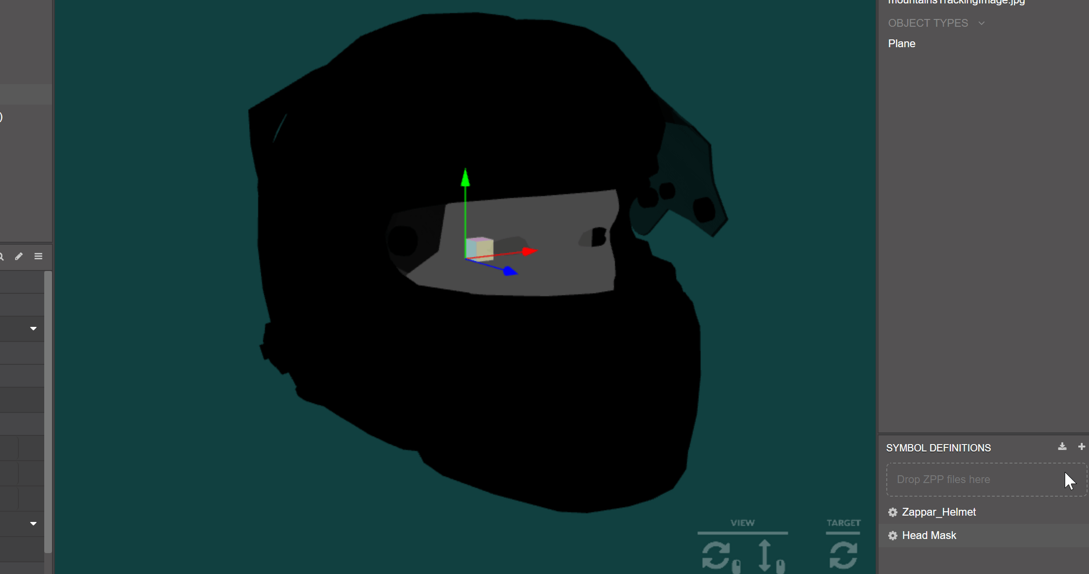

Creating a Gravity Environment Light Symbol
Section titled “Creating a Gravity Environment Light Symbol”A Gravity Environment Light can be added to your project by clicking on the plus icon + from the Symbol Definitions panel, and selecting the Gravity Environment Light component.

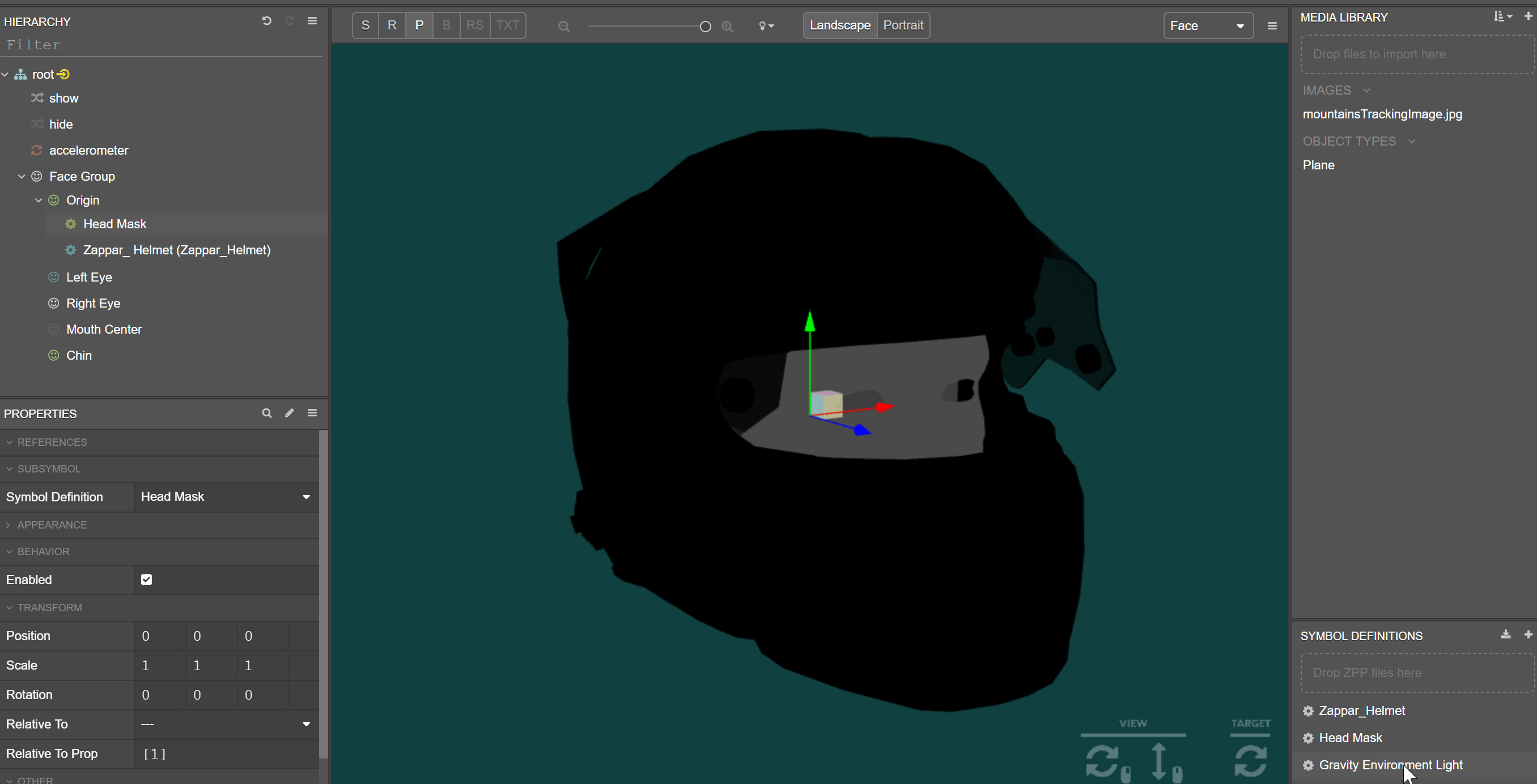

Using a Gravity Environment Light Symbol

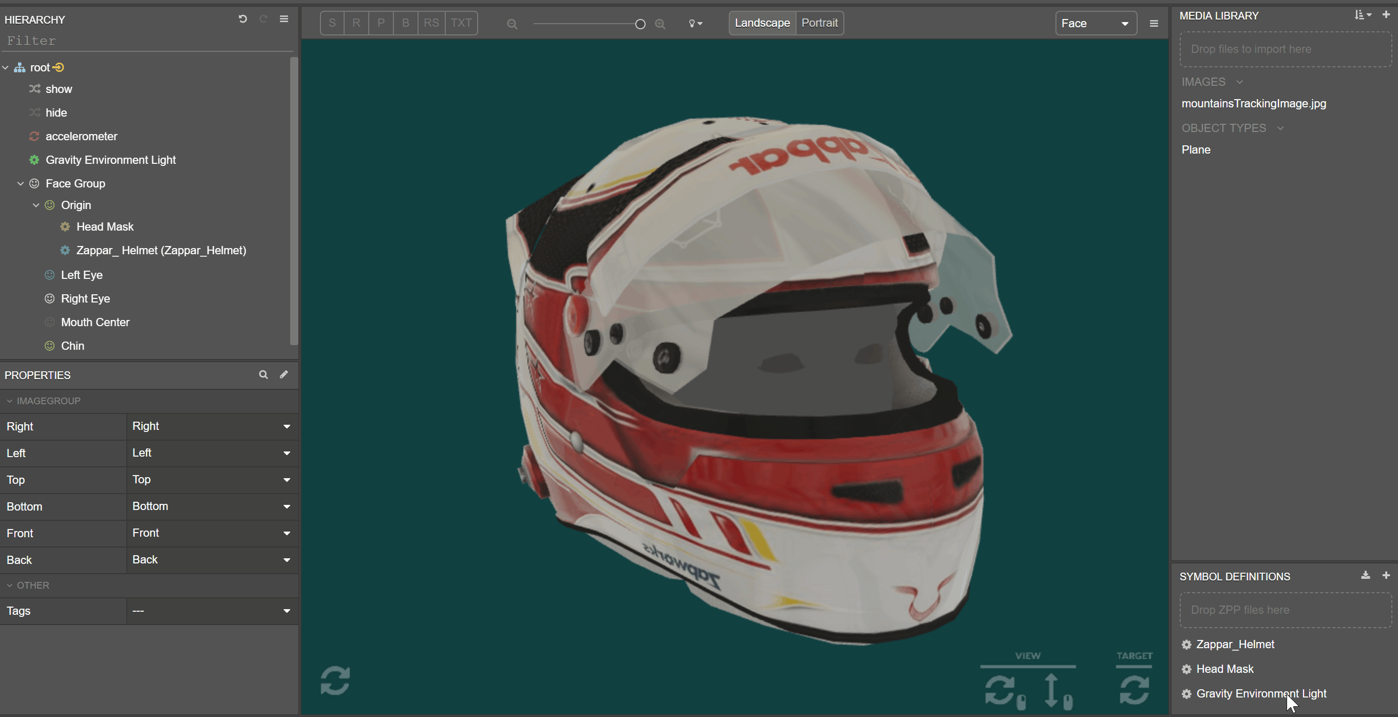

Section titled “Using a Gravity Environment Light Symbol”Add the Gravity Environment Light to the scene by dragging it from the Symbol Definitions panel into the Hierarchy.
