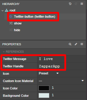

Drag the Twitter subsymbol from Symbol Definitions, into the Hierarchy in the parent symbol.
Select the Twitter node and add your message to the Twitter Message field.
If you’d like to tag a specific Twitter handle in your message, add it to the Twitter Handle property without the @ symbol. The example below will prepare a tweet with the message I love, and the @ZapparApp handle tagged at the end.
