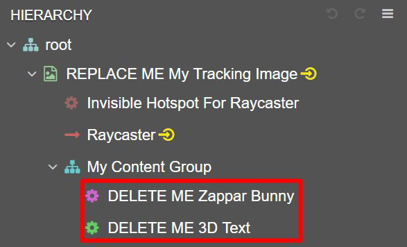

- Delete the Zappar Bunny and 3D Text nodes from the Hierarchy.

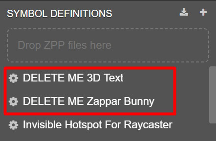

- Delete the Zappar Bunny and 3D Text subsymbol’s from the Symbol Definitions.

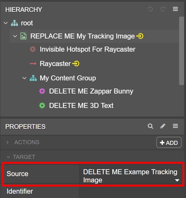

- Train up a new tracking image within your project.
- Select the Tracking Image node in the Hierarchy and, within its Properties, update its Source to that of the newly trained target.
- Preview the experience and watch your 3D model come to life when it’s looked at!
