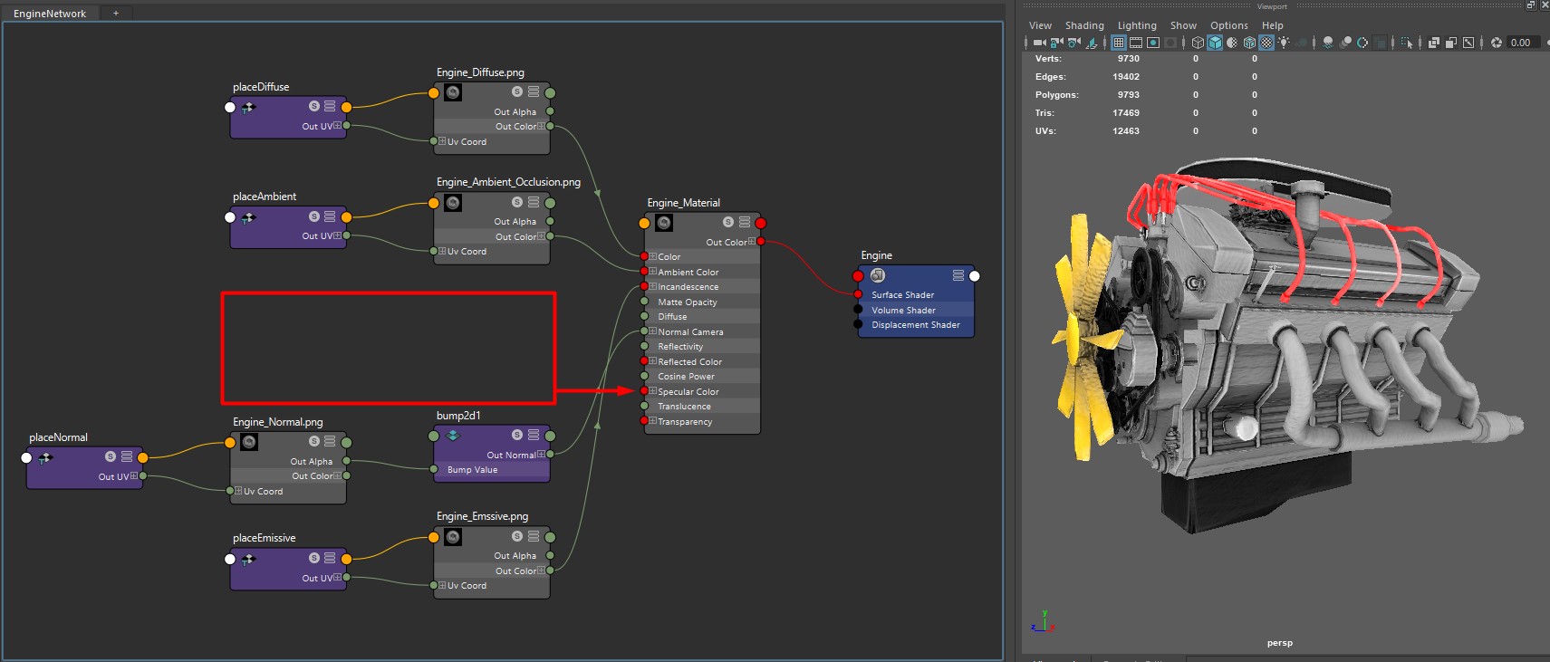

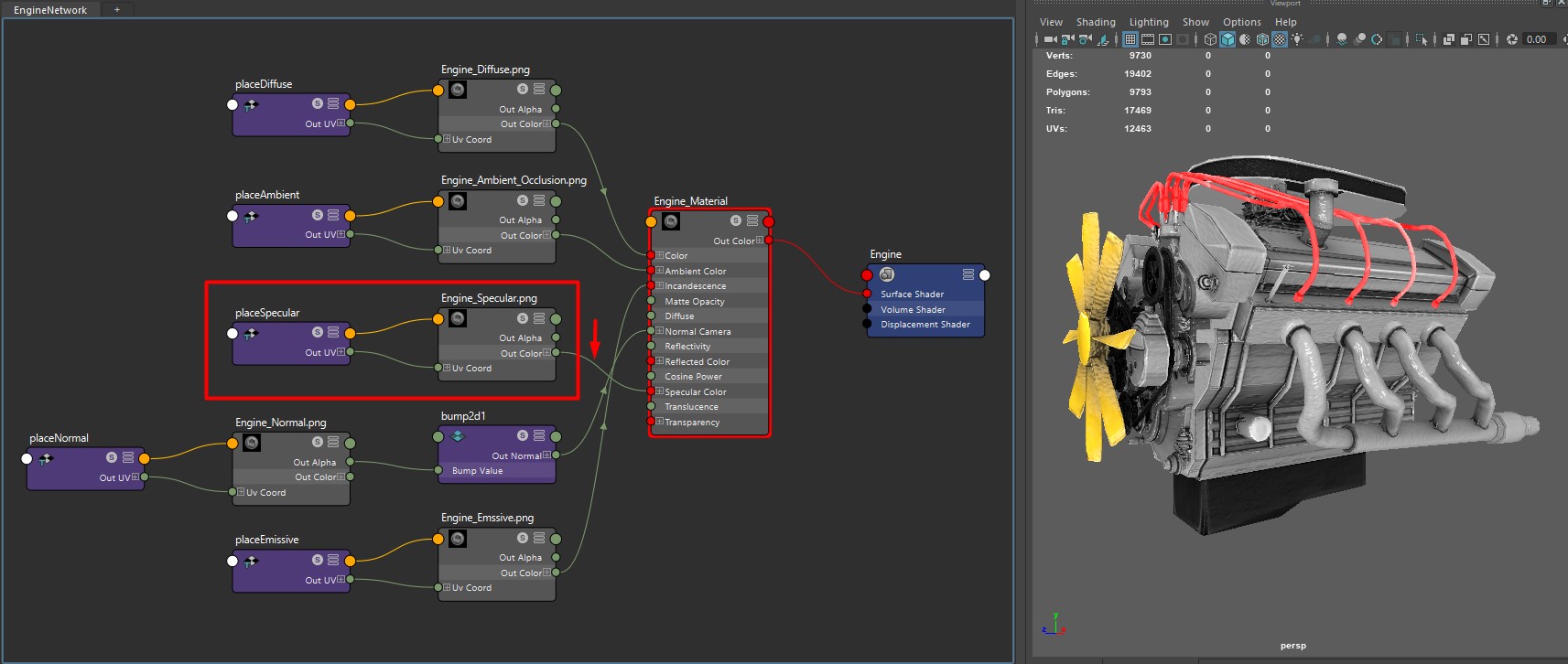

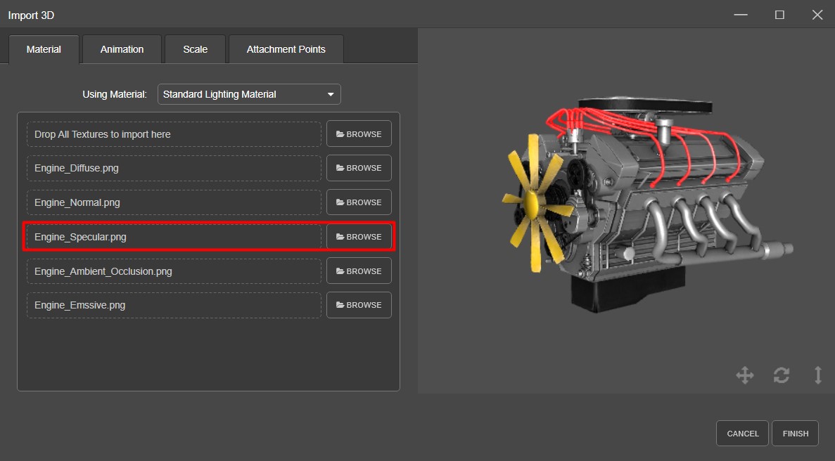

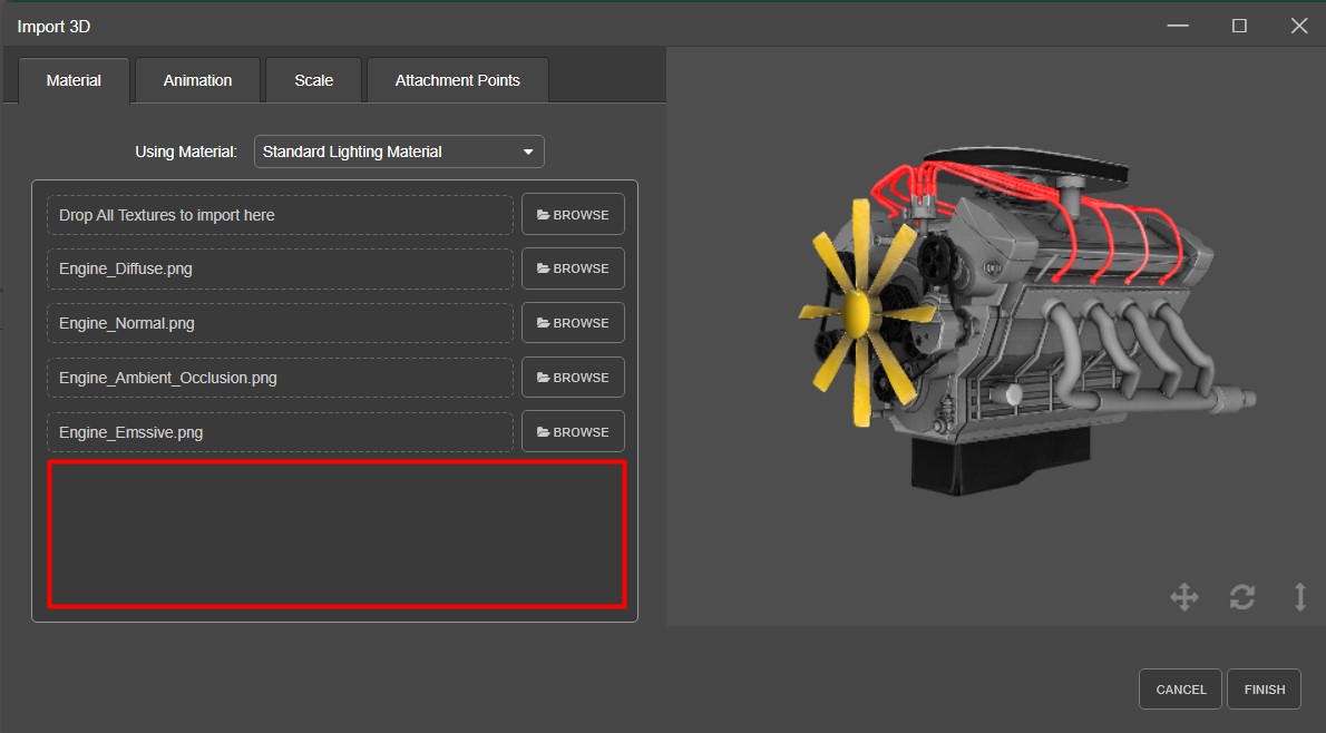

Why weren’t the texture files detected when I imported the 3D model?
Section titled “Why weren’t the texture files detected when I imported the 3D model?”When a model is imported to Studio its texture channels are detected, and the import pop-up will ask for the texture maps linked to the detected texture channels.
If a texture file is missing from the list, it’s usually due to a missing assignment in a texture channel within the 3D software.
To fix this navigate to the material editor within your 3D software and ensure that the model’s texture maps are assigned correctly to the texture channels.

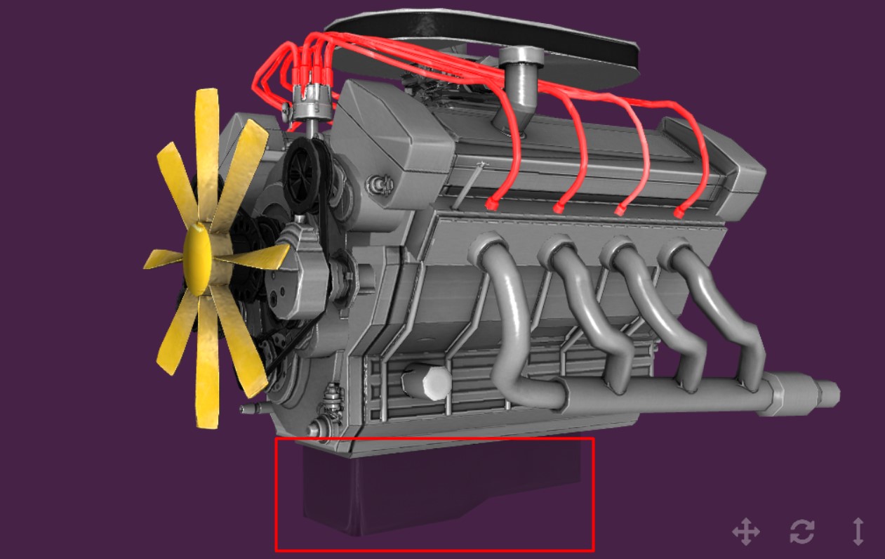

How do I prevent back faces from rendering through translucent sections of my model?
Section titled “How do I prevent back faces from rendering through translucent sections of my model?”Sometimes transparent areas of the model defined by the opacity map may render unwanted geometry in the background.
This can be fixed from within the model’s subsymbol. Select the 3D model’s node in the Hierarchy, then in the Properties panel change its Cull Faces value to back.
