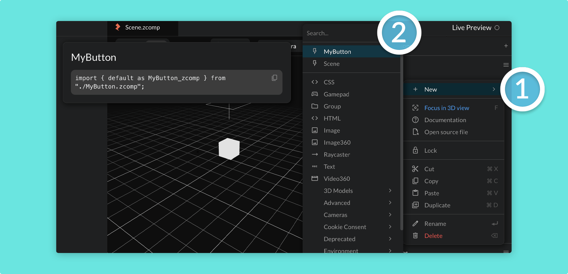

Adding a zcomp to a Scene
Section titled “Adding a zcomp to a Scene”To add a zcomponent to your Scene, right-click on the Hierarchy and go to + New. At the top of the menu, there will be a list of your zcomponents. Simply click on one to add it.
Each zcomponent will be its own instance and can be scaled, rotated, and positioned accordingly.
