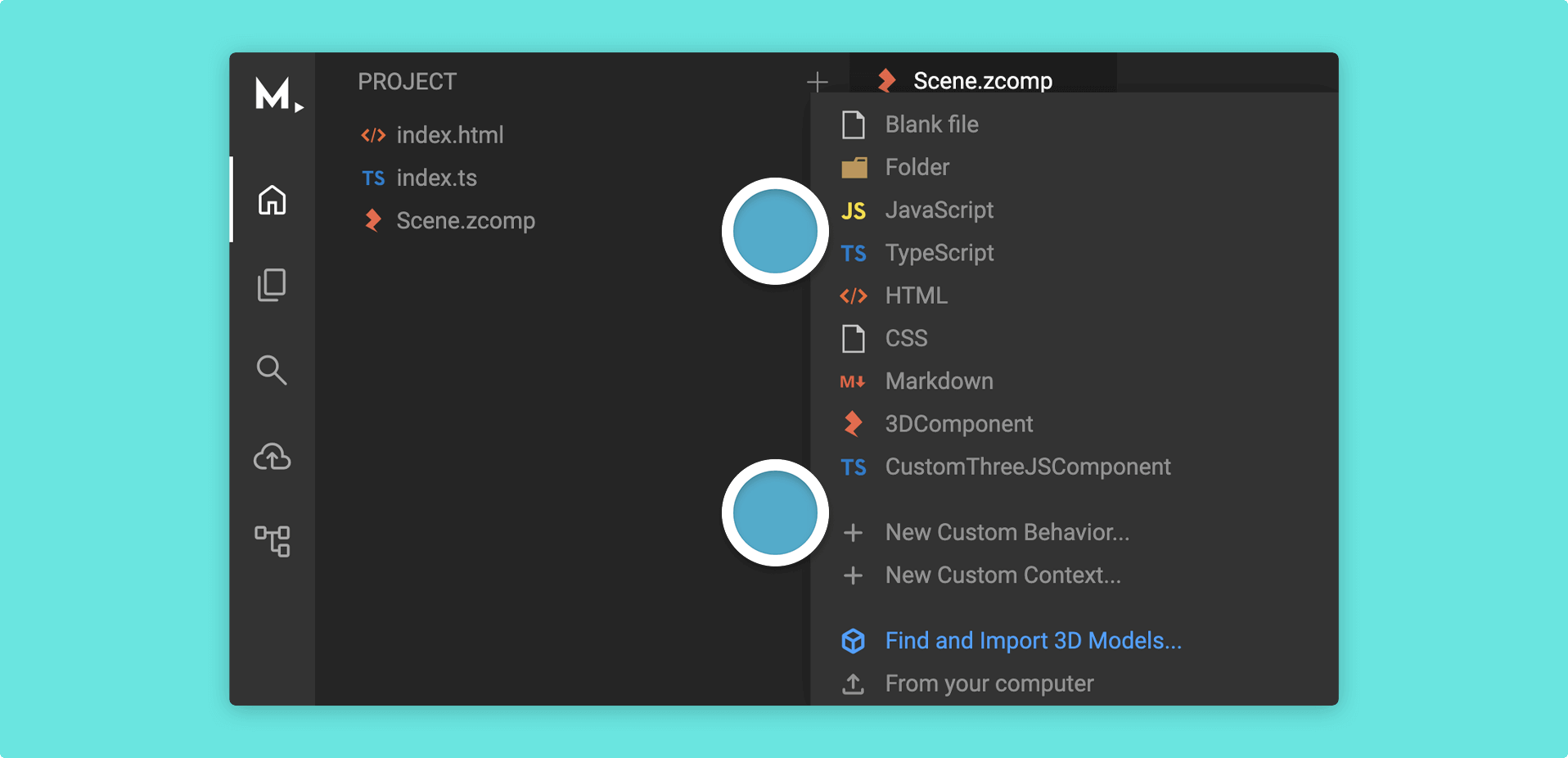

Creating a Script
Section titled “Creating a Script”Scripts can be added by clicking on the + (plus) icon found at the top right of the Left Menu. You can also add custom Behavior Actions from the Behaviors Panel.
You can either create a blank script or select a templated one:

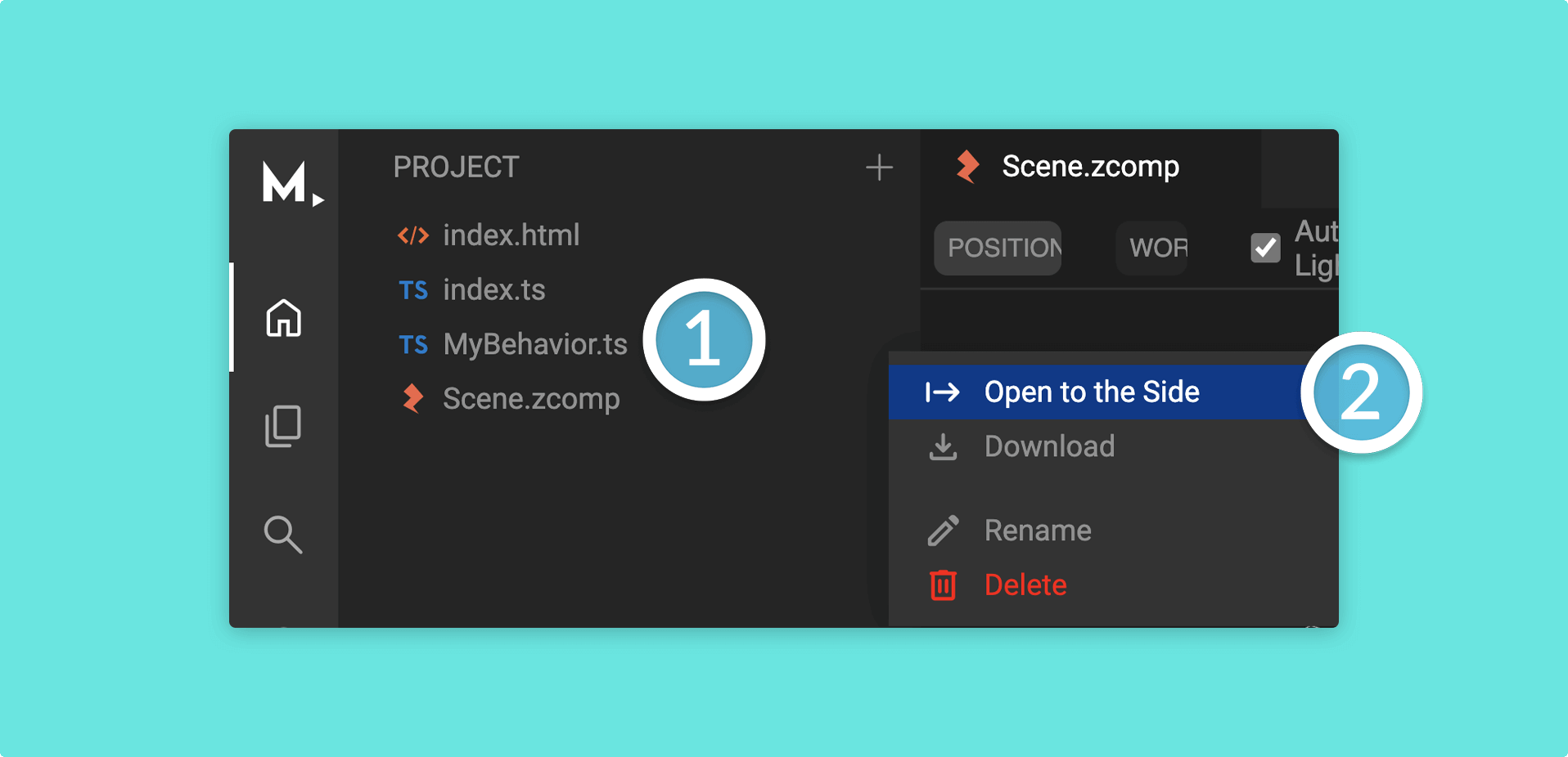

Double clicking on a script file in the Left Menu will reveal its code in the central area of Mattercraft. You can also right click on the script file and select Open to the side to open your script in a new tab in the editor. This will allow you to see both your zcomp (Scene) and script at the same time.
