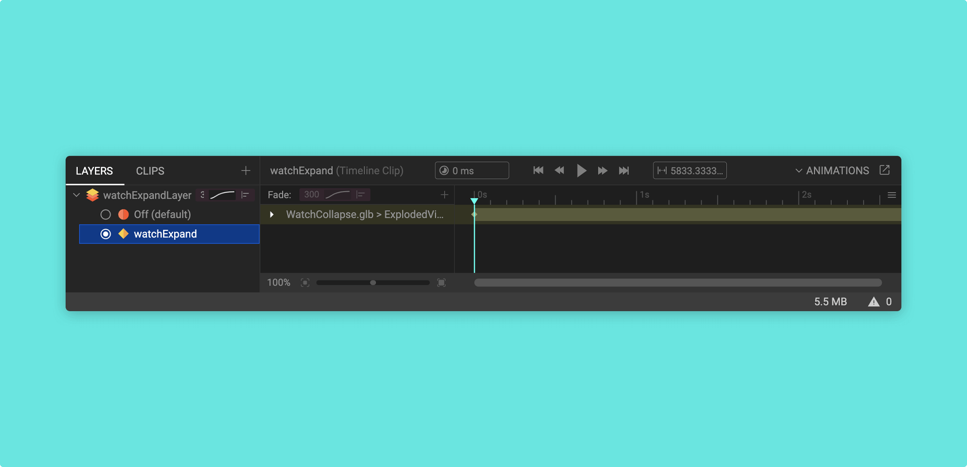

To add a stream track to a timeline, you can use the following steps:
- Click on the Animations panel to open it up
- Click on Layers if your Timeline is inside a layer or Clips if it is independent
- Find and click on the Timeline you wish to add the Stream Track to
- Go to the Timeline Clip editor and find the + (plus) icon
- Find Streams and then click on the Stream Track you wish to add to the Timeline
- Mattercraft will automatically add the Stream Track to the Timeline

To customize the playback for a stream track, you can use the following instructions:
- When the Timeline Clip editor is open, right click on the stream instance and left click on Modify stream playback…
- Adjust the values of the Stream Track’s properties and click on Done when you have finished

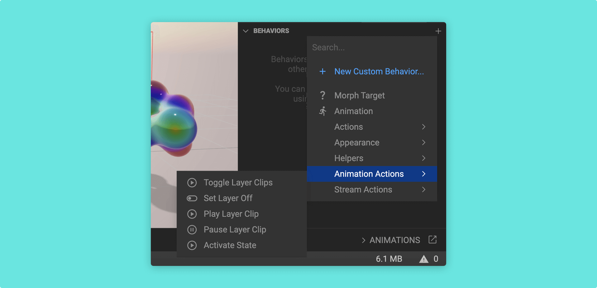

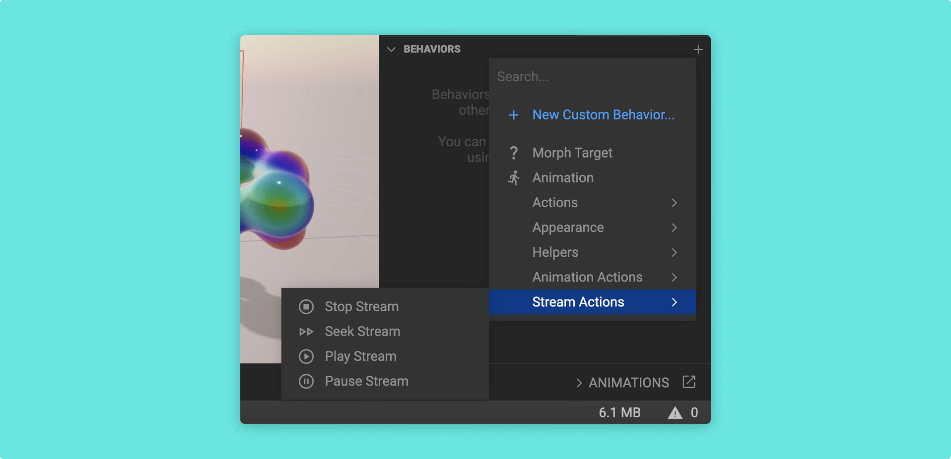

- Find the Node you wish to play the Stream Track with inside the Hierarchy Panel and select it
- Head to the Behavior Actions Panel and click on the + (plus) icon
- Find the Animation Actions category or the Stream Actions category and use any of the following Behavior Actions to activate the stream tracks:
| Animation Action | Description |
| Set Layer Off | Resets the chosen layer to whatever values are specified for the Off state. |
| Play Layer Clip | Plays the stream track’s timeline. |
| Pause Layer Clips | Pauses the stream track’s timeline. Unless reset or played from the start, the stream track will play from this point. |
| Stream Action | Description |
| Stop Stream | Stops the stream track from playing and sets the timeline Time to 0 (the start of the stream track). |
| Seek Stream | Sets the Time along the timeline where the stream track should play from. Useful if you want to replay a particular section of a stream track. |
| Play Stream | Plays the stream track along its timeline. Will play from whatever Time is currently set to, unless From Start is checked. |
| Pause Stream | Pauses the stream track. Unless reset or played from the start, the stream track will play from this point. |
