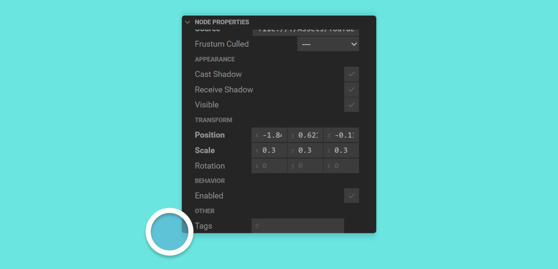

To set the tag for a trigger, you should:
- Navigate to the Properties Panel and find the Other section (near the bottom)
- Add the exact same tag name (using any naming convention) to the
Tagproperty for all triggers that should interact with each other.

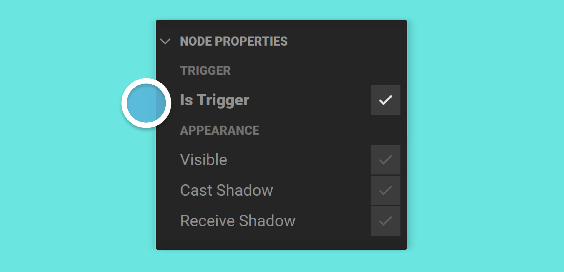

Is Trigger
Triggers can only emit events when they intersect with another trigger that is marked as a Trigger.
Only one trigger in the interaction needs to be marked as a trigger, typically the one for which you’ve set up the events.

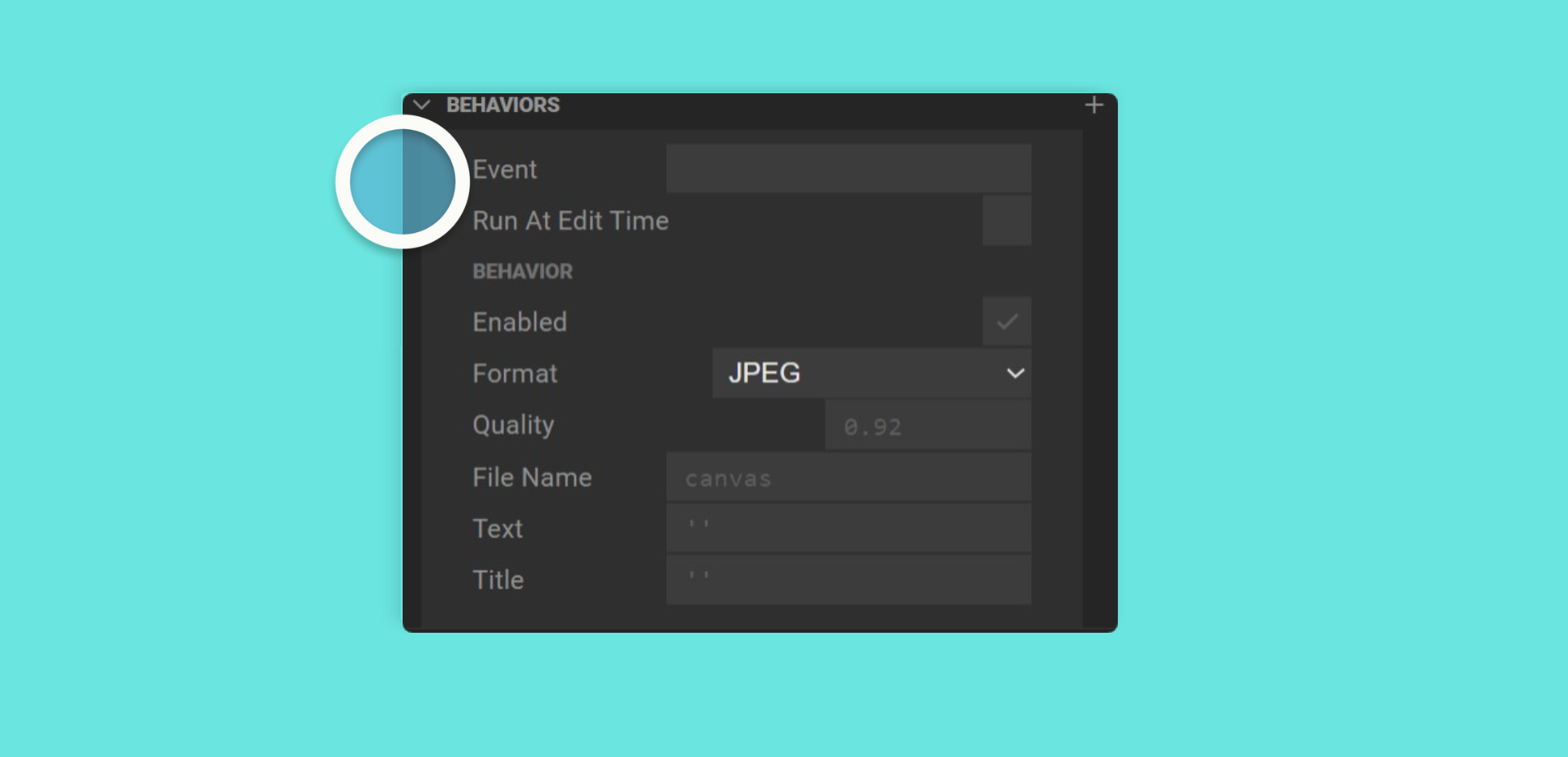

- Find the Trigger you wish to trigger events with inside the Hierarchy Panel and select it
- Head to the Behavior Actions Panel and click on the + (plus) icon
- Assign the desired Behavior Action and the trigger’s
Eventproperty
