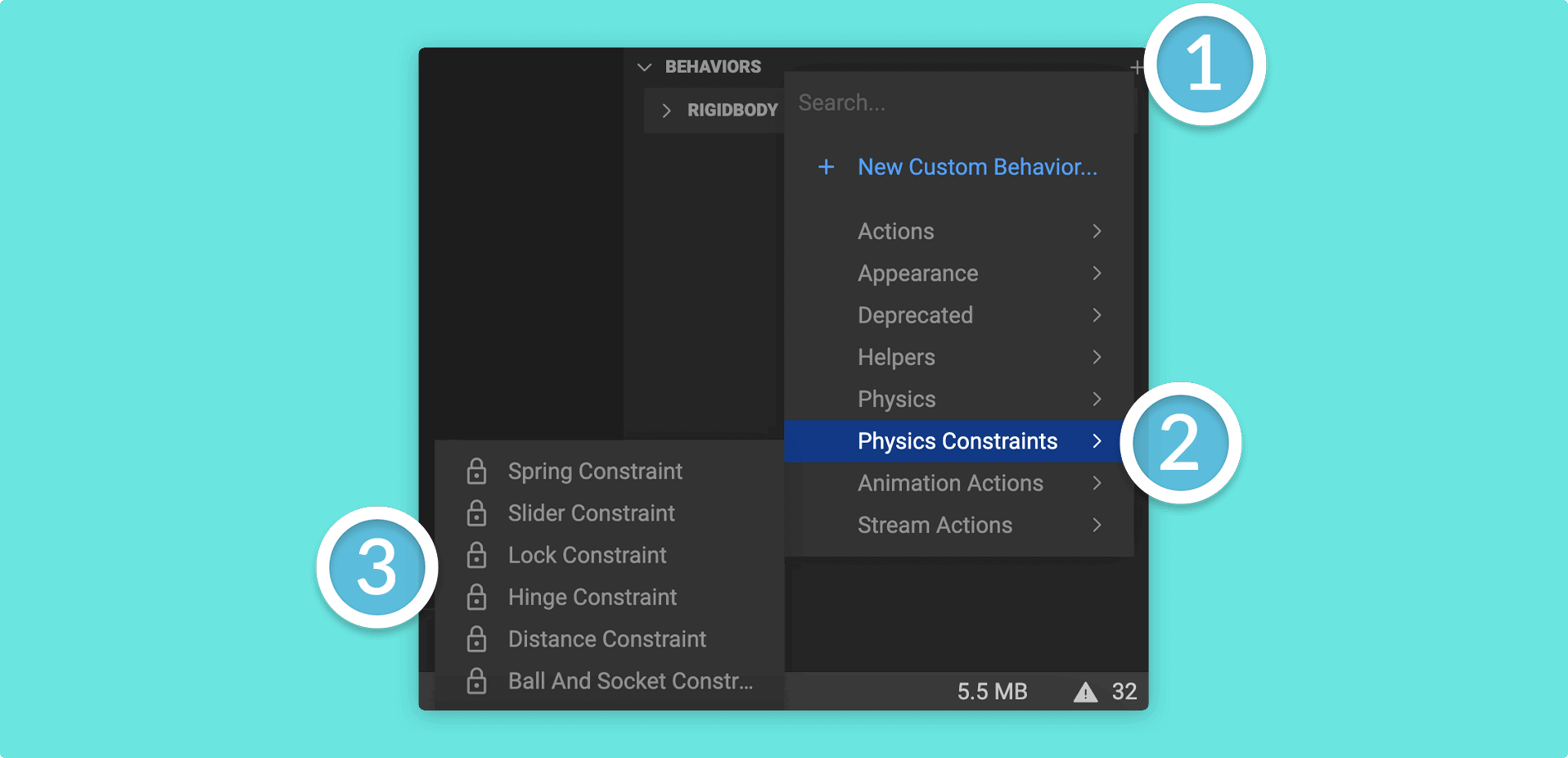

Section titled “Adding a Constraint”Mattercraft comes with a number of built in Physics Constraints
Behaviors for quick and easy setup.
Simply head into the Behaviors Panel, go to Physics Constraints →
and choose your desired Constraint.
The following constraints are available, click below to learn more:
