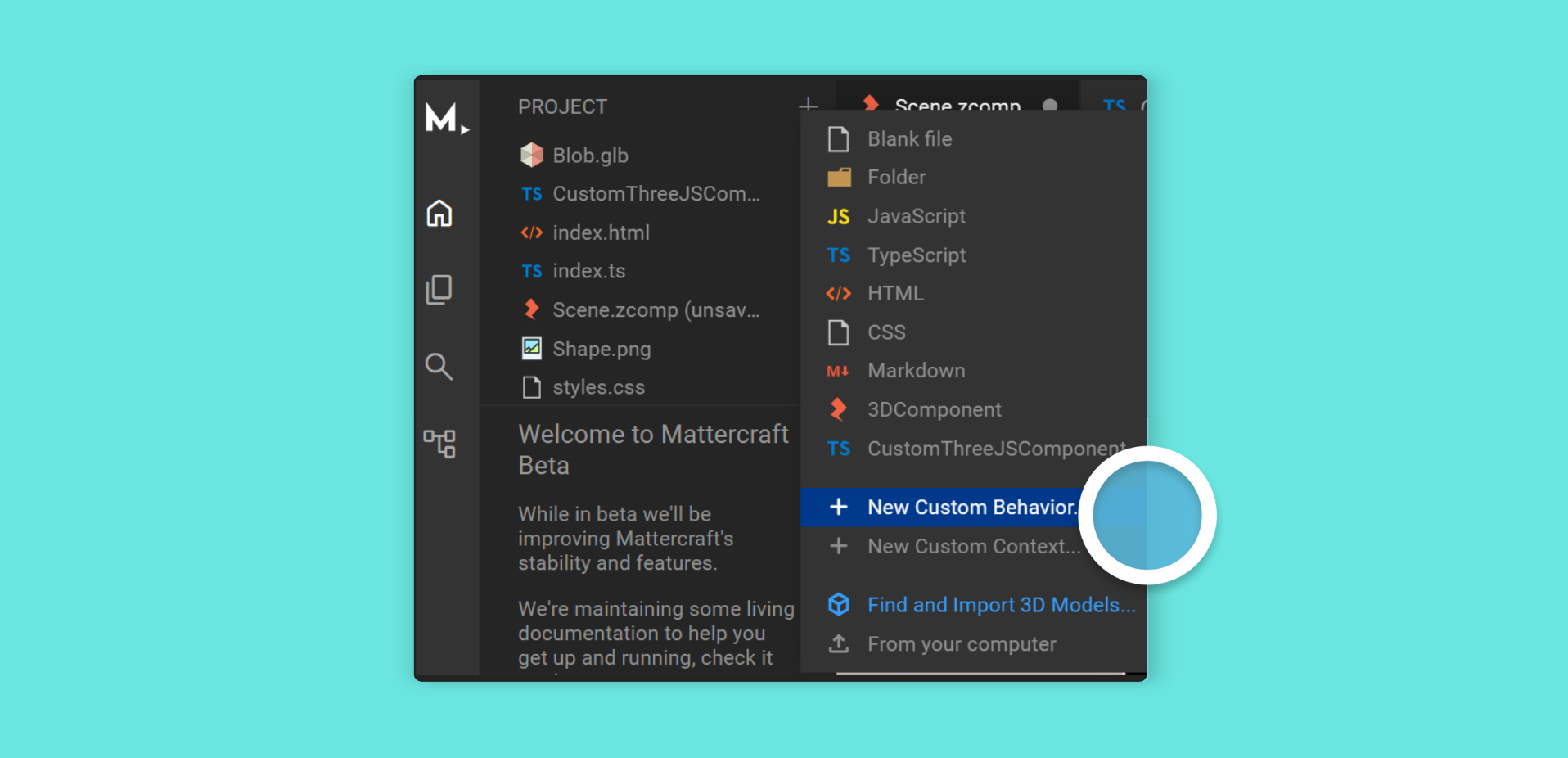

To add a new custom behavior to a specific node in your Mattercraft project:
  1. Click on a node in the Hierarchy
  2. Click the + (plus) icon button on its Behaviors Panel and Click + New Custom Behavior
  3. Type a name for the behavior then click Create
  4. The Project Panel will now have this behavior script file with the skeleton of a brand new behavior
You can also add a new custom behavior from the Project Panel and then specify which nodes you want it to affect.
Adding a Custom Behavior to your project

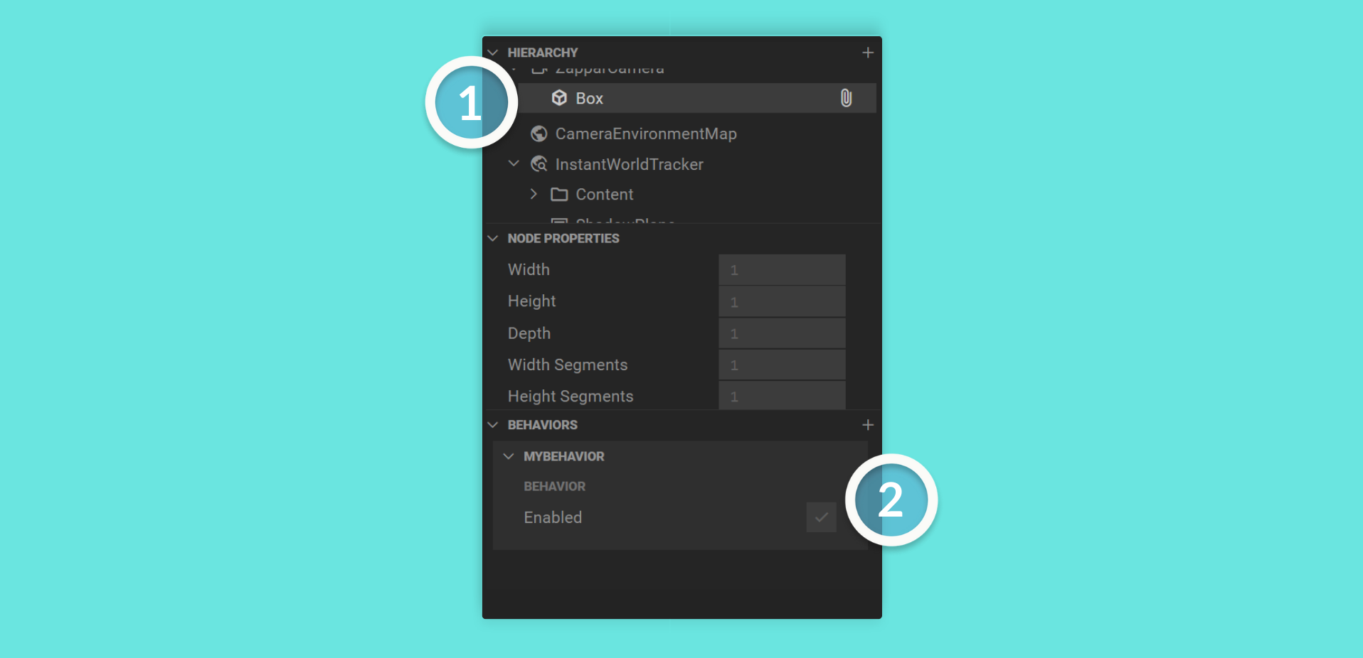

Creating an Instance
When your behavior runs, it’s passed a reference to the node in the Hierarchy that it’s attached to.
In the example above, we created our behavior and attached it directly to a Box node in our 3D scene. As a result, the instance variable in our MyBehavior class constructor points to a Box component.
A Custom Behavior attached to a Node

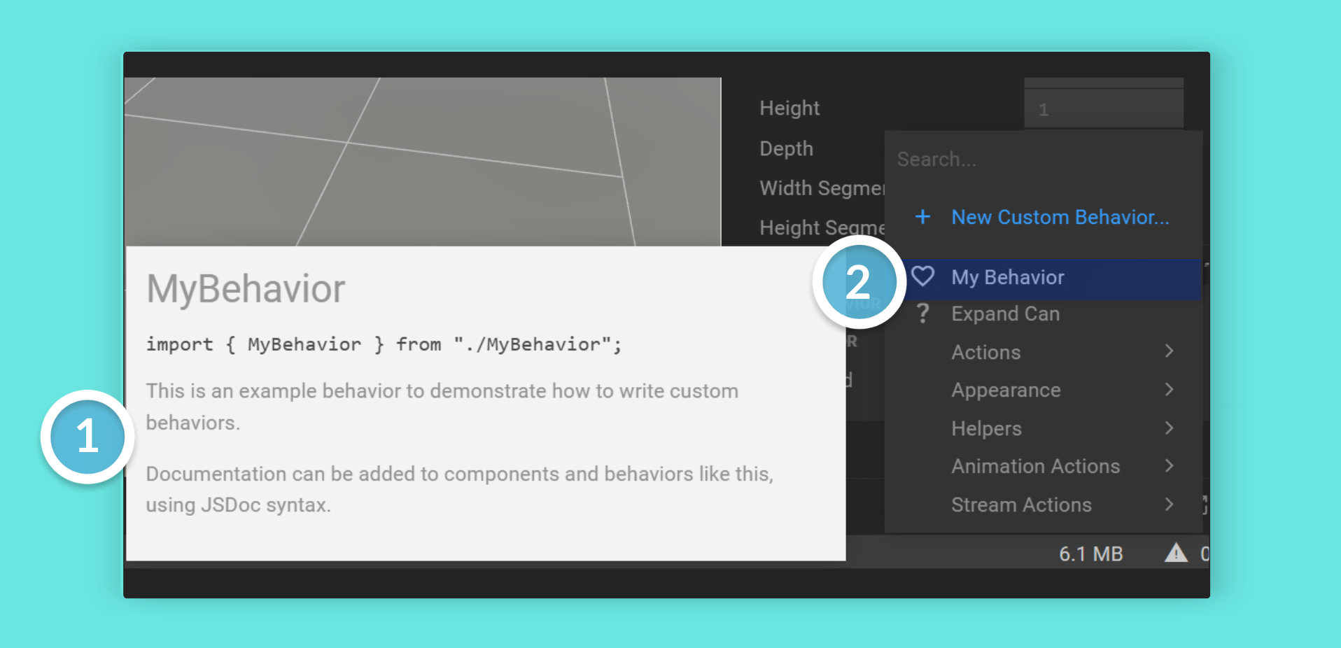

Documenting and Customizing Your Behaviors
To make it easy to use your behaviors in 3D scenes, it’s possible to add documentation in the script comment above your behavior’s class definition. Documentation is written using the popular JSDoc syntax.
* This is an example behavior to demonstrate how to write custom behaviors.
* Documentation can be added to components and behaviors like this, using JSDoc syntax.
* @zicon favorite
* @zbehavior
export class MyBehavior extends Behavior<Box> {
In addition, with the @zicon annotation, you can indicate what icon to show in the Behaviors Panel. Any of the icons from Google’s Material Icon Set can be used - just lowercase the name and replace any spaces with an underscore.
For example, the Google Material icon name for Check Box will become @zicon check_box in Mattercraft.
Here’s how the behavior documentation and the custom icon look in the 3D editor:
Documentation tooltip on a Custom Behavior within the Behaviors Panel
