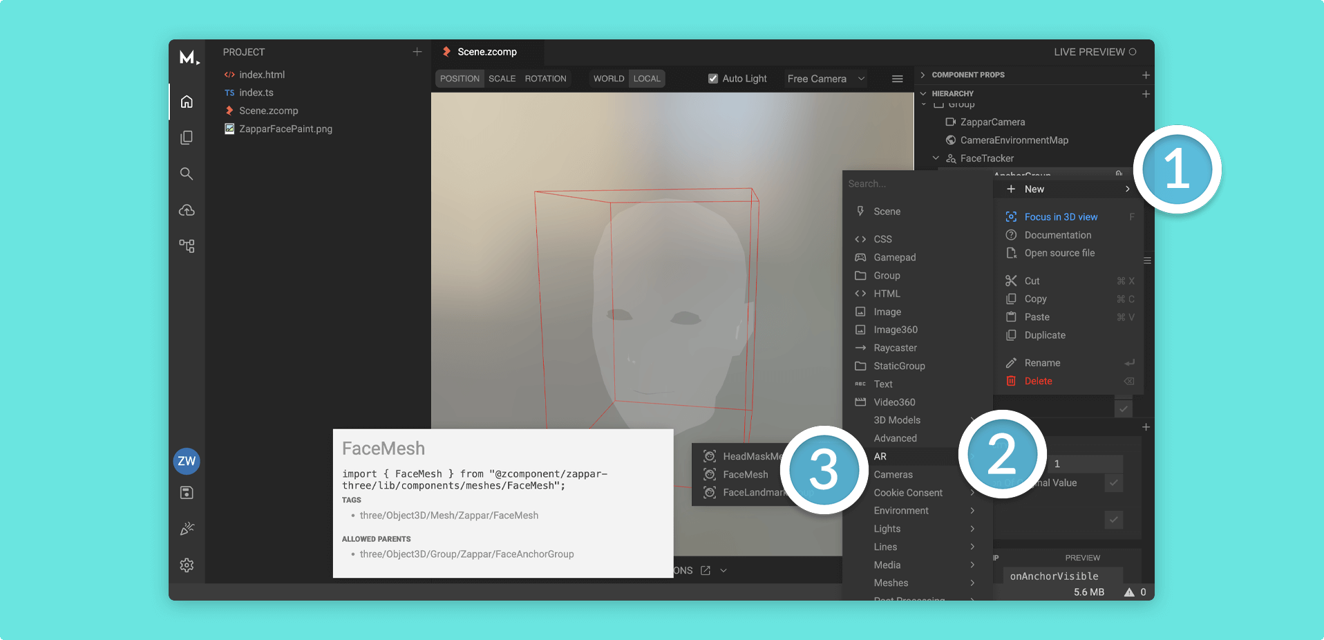

To add a face mesh, first make sure that there is a Face Tracker and a Face Anchor Group in your Hierarchy.
Then, you may use the following instructions:
  1. Right click on the FaceAnchorGroup and hover over New
  2. Find the AR component category and select the FaceMesh component
Adding a Face Mesh to the Hierarchy
