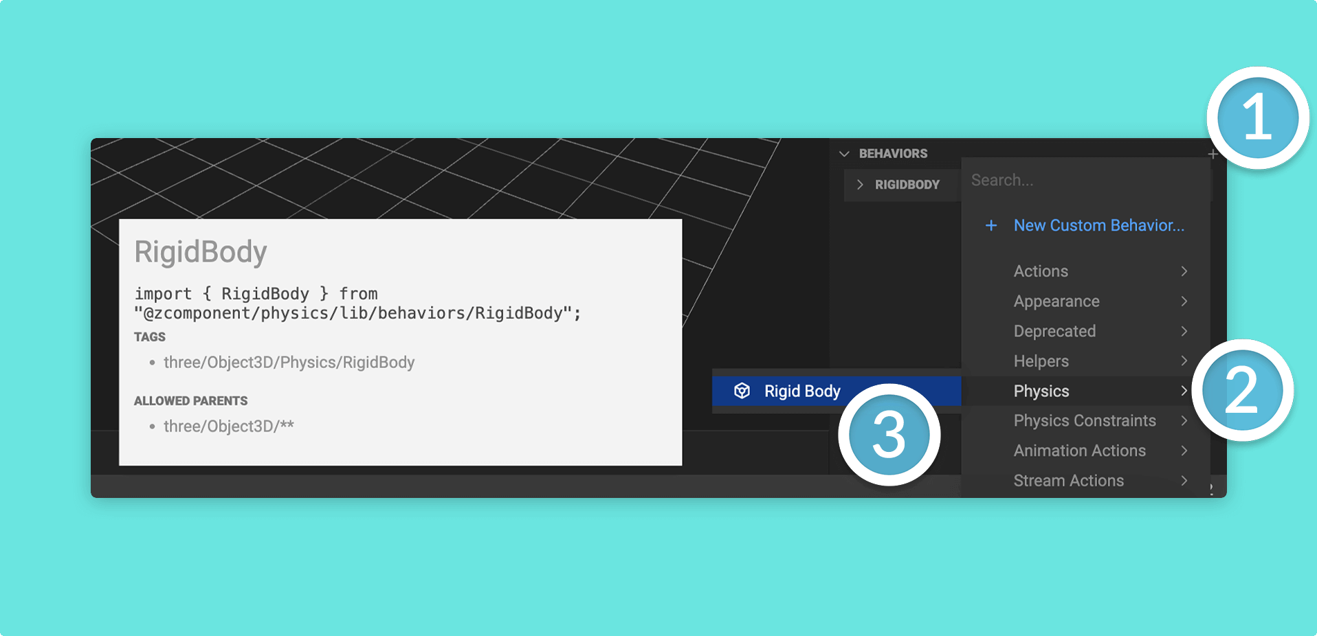

Adding a Rigid Body
Section titled “Adding a Rigid Body”Adding a Rigid Body to Mattercraft is simple and intuitive. Simply add a Physics → Rigid Body
Behavior to a component.
The Rigid Body Behavior sets up and exposes everything you need to get started with physics, including creating a default Collider (depicted as a green bounding box) to wrap around your component.
