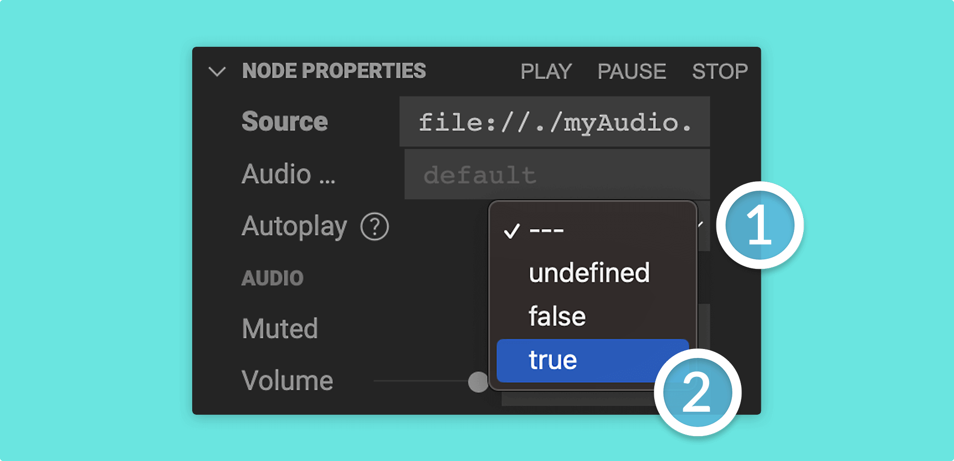

Autoplay
Enable the Autoplay option in the properties to automatically start the audio when your zcomp is loaded:

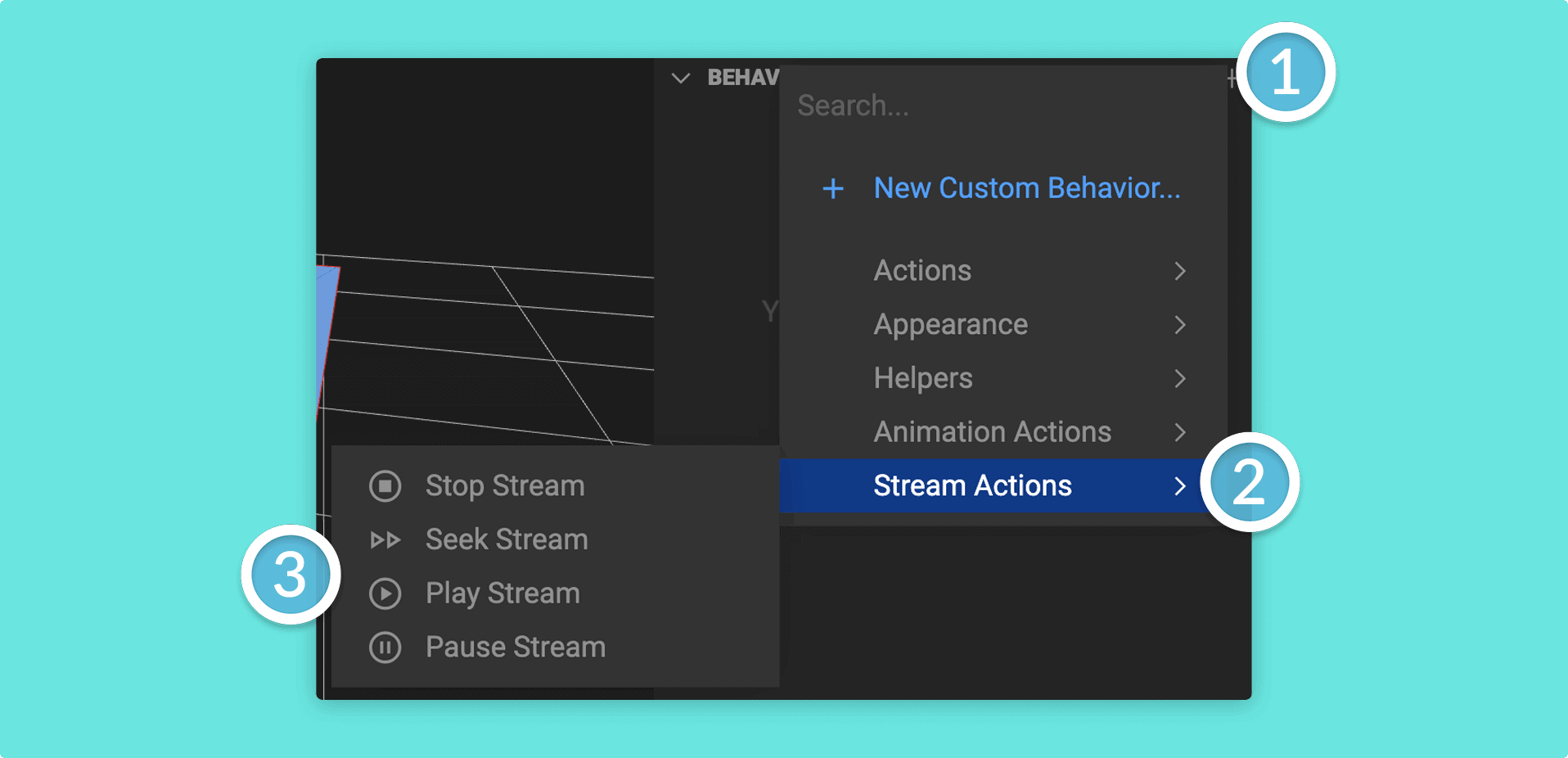

Stream Action
Use a stream track action to trigger audio playback via an event:
Select the node in the Hierarchy that you want the event to fire on, choose Stream Actions, and use the desired action (e.g., Play Stream).
To learn more about adding interactivity to your Mattercraft projects, see our dedicated Behavior Actions articles.
