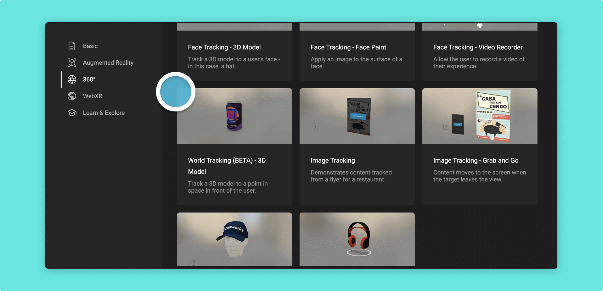

Customizing a template
When you open Mattercraft, you will be presented with a few Project Templates to help you get started.
Upon selecting a World Tracking template, your .zcomp
will display a project which includes a WorldTracker
component; as well as some simple content and basic behaviors.
You may customize any Mattercraft template like an ordinary Mattercraft project.
To learn more about getting started with Mattercraft’s templates, check out our dedicated Project Templates documentation.

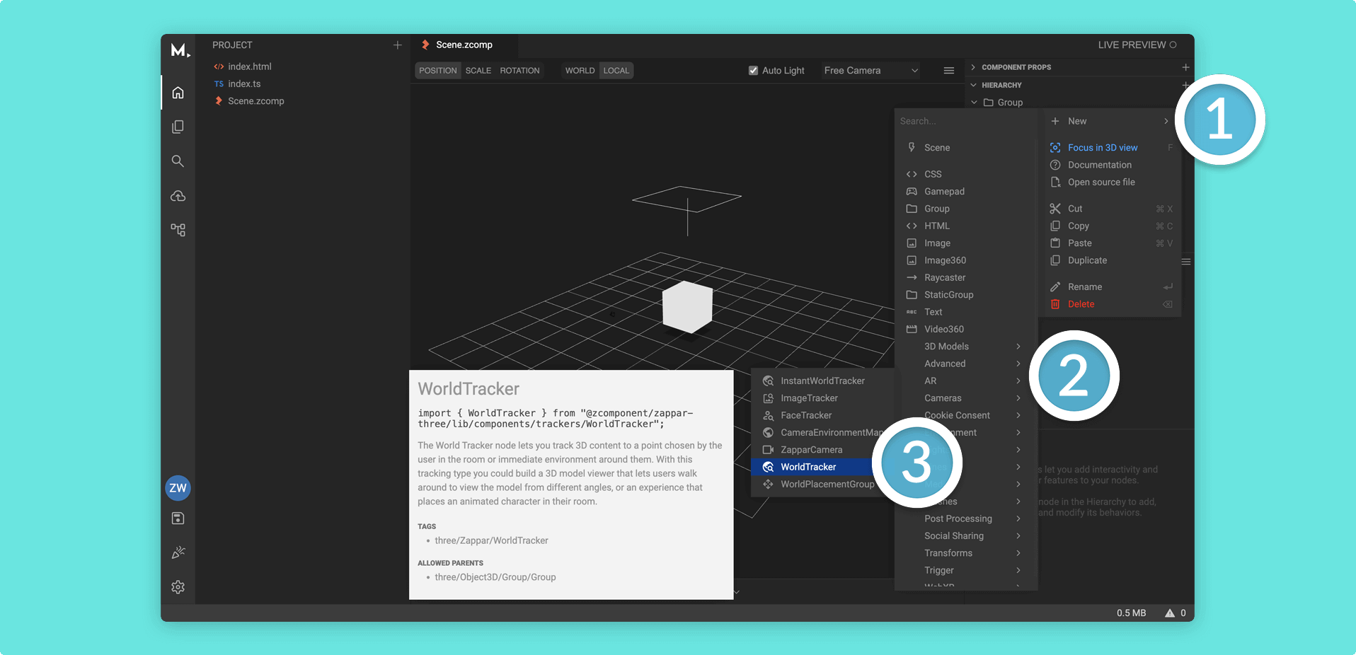

You can then add the WorldTracker
to your .zcomp
by using the following instructions:
- Click on the + (plus) icon in the Hierarchy (or right click on a Group Node)
- Find the
AR
component category and from here, selectWorldTracker

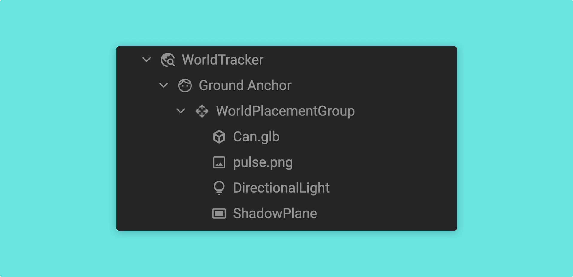

Ground Anchor Group
Section titled “Ground Anchor Group”World Trackers contain a GroundAnchorGroup
component which is used to understand and track content to a surface in your environment.

World Placement Group
Section titled “World Placement Group”Ground anchors should contain a World Placement Group
for the best user experience. The position of content placed in this group can be chosen by the user.

Tracking content to the environment
Section titled “Tracking content to the environment”When your World Tracker is in the Hierarchy, you can start adding tracked content by placing components inside of the tracker’s WorldPlacementGroup
