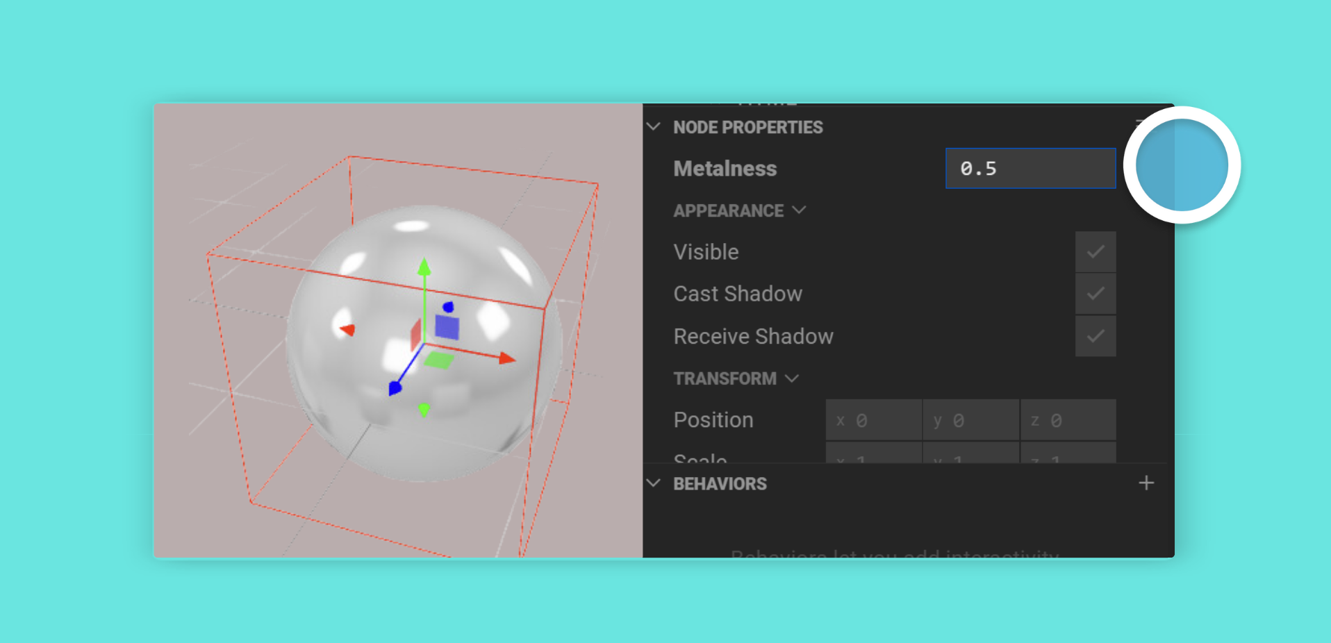

// Set metalness to 0.5this. metalness.value = 0.5;
console.log('Current metalness', this.metalness.value);Observables even work with JavaScript arrays - they deeply observe the arrays and will call registered functions if any of the elements within the array change

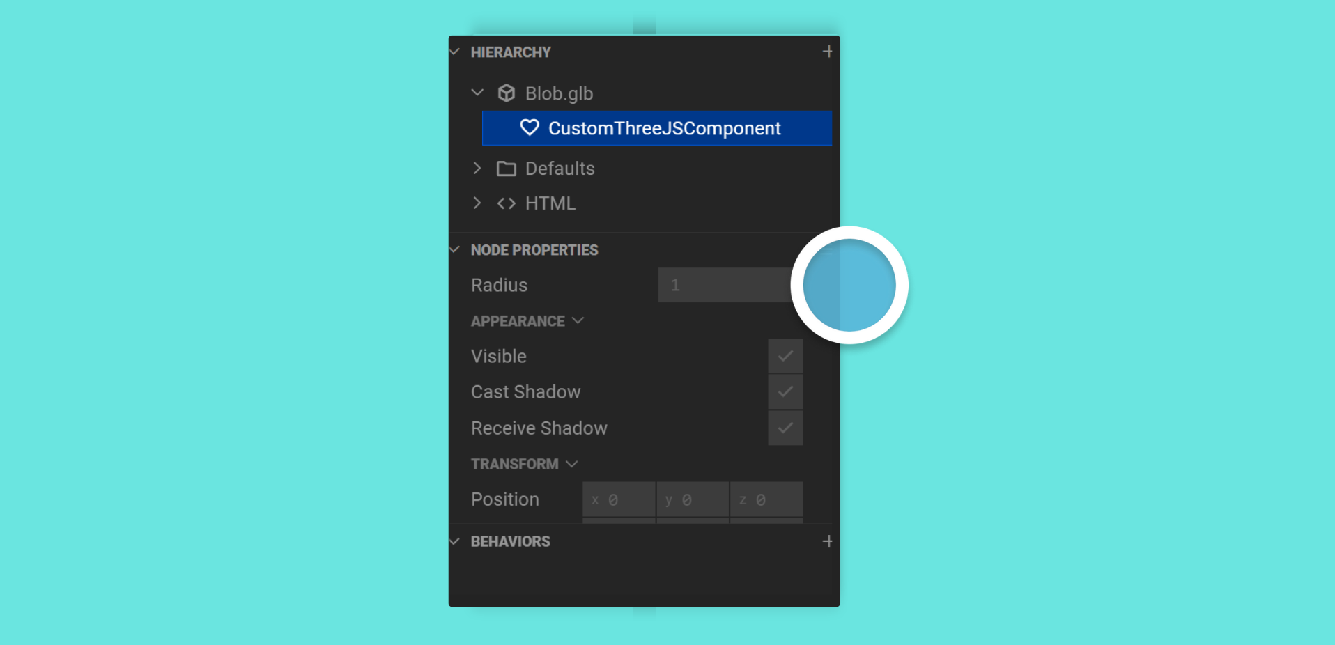

Constructor Properties
Section titled “Constructor Properties”Constructor properties are passed into the constructor of your component or behavior.
Three.js’s THREE.SphereGeometry object takes a radius option in its constructor, so let’s create and pass through a radius constructor property for our example component.
Since it’s a constructor property, whenever the user edits it in the 3D editor, Mattercraft will reload our scene, constructing our component (and thus our THREE.SphereGeometry) again with the new radius value. To keep things concise, we’ve removed the code we added earlier on this page.
interface ConstructorProps { /** * @zui * @zdefault 1 */ radius: number}
/*** @zcomponent* @zicon favorite*/export class CustomThreeJSComponent extends Group { constructor(contextManager: ContextManager, constructorProps: ConstructorProps) { super(contextManager, constructorProps);
// Construct our sphere, referencing the material const myObject = new THREE.Mesh( new THREE.SphereGeometry(constructorProps.radius ?? 1), new THREE.MeshBasicMaterial(), );
// Add our sphere to this component's Group this.element.add(myObject); }}This first change to notice is that we’ve added the details for our radius property to the ConstructorProps interface at the top of our file:
interface ConstructorProps { /** * @zui * @zdefault 1 */ radius: number}As with runtime properties, we’ve indicated to Mattercraft that we want this property to be shown in the 3D editor using the @zui annotation, and we’ve provided the default value to be shown in the input box.
Then, in our component constructor, we pass our radius constructor property into the THREE.SphereGeometry constructor function:
// Construct our sphere, referencing the materialconst myObject = new THREE.Mesh( new THREE.SphereGeometry(constructorProps.radius ?? 1), new THREE.MeshBasicMaterial(),);For most of the configurable parameters of your components and behaviors, it’s best to use runtime properties as they give the most flexibility to the user of the entity in the scene - they can be animated and changed during the experience without a reload.
For parameters that need to be passed to the constructors of objects (such as radius in our example above), constructor properties ensure the experience runs consistently.

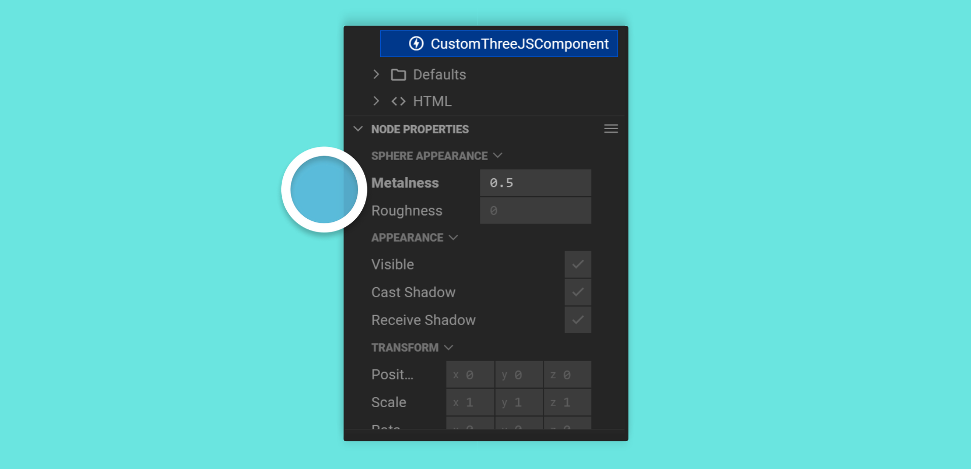

/*** @zui* @zdefault 0* @zgroup Sphere Appearance* @zgrouppriority 20*/public metalness = new Observable(0);
/*** @zui* @zdefault 0* @zgroup Sphere Appearance* @zgrouppriority 20*/public roughness = new Observable(0);

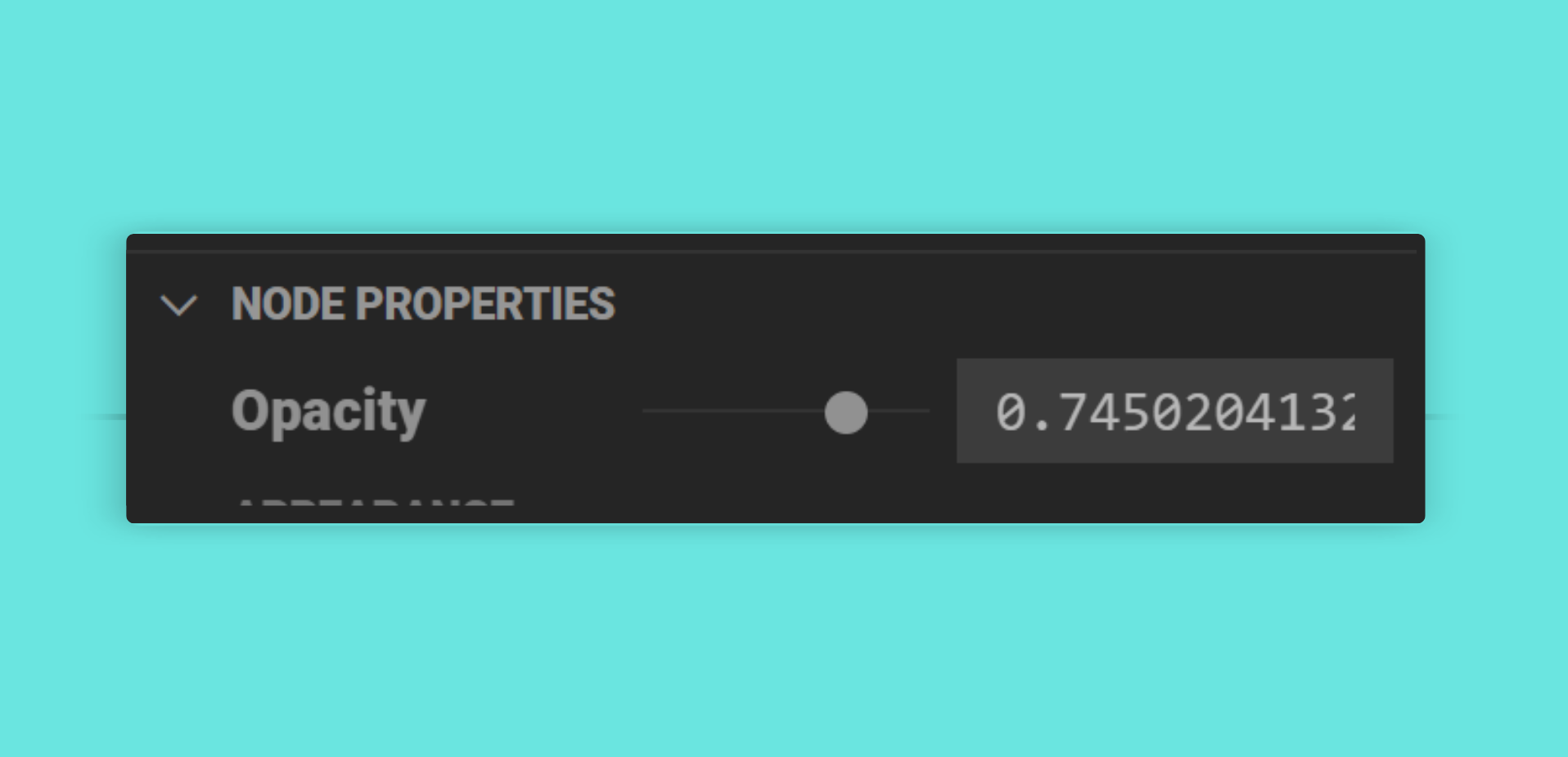

@ztype proportion
This indicates the property represents a value that goes from 0 to 1. It’s shown in the property table with a draggable slider.

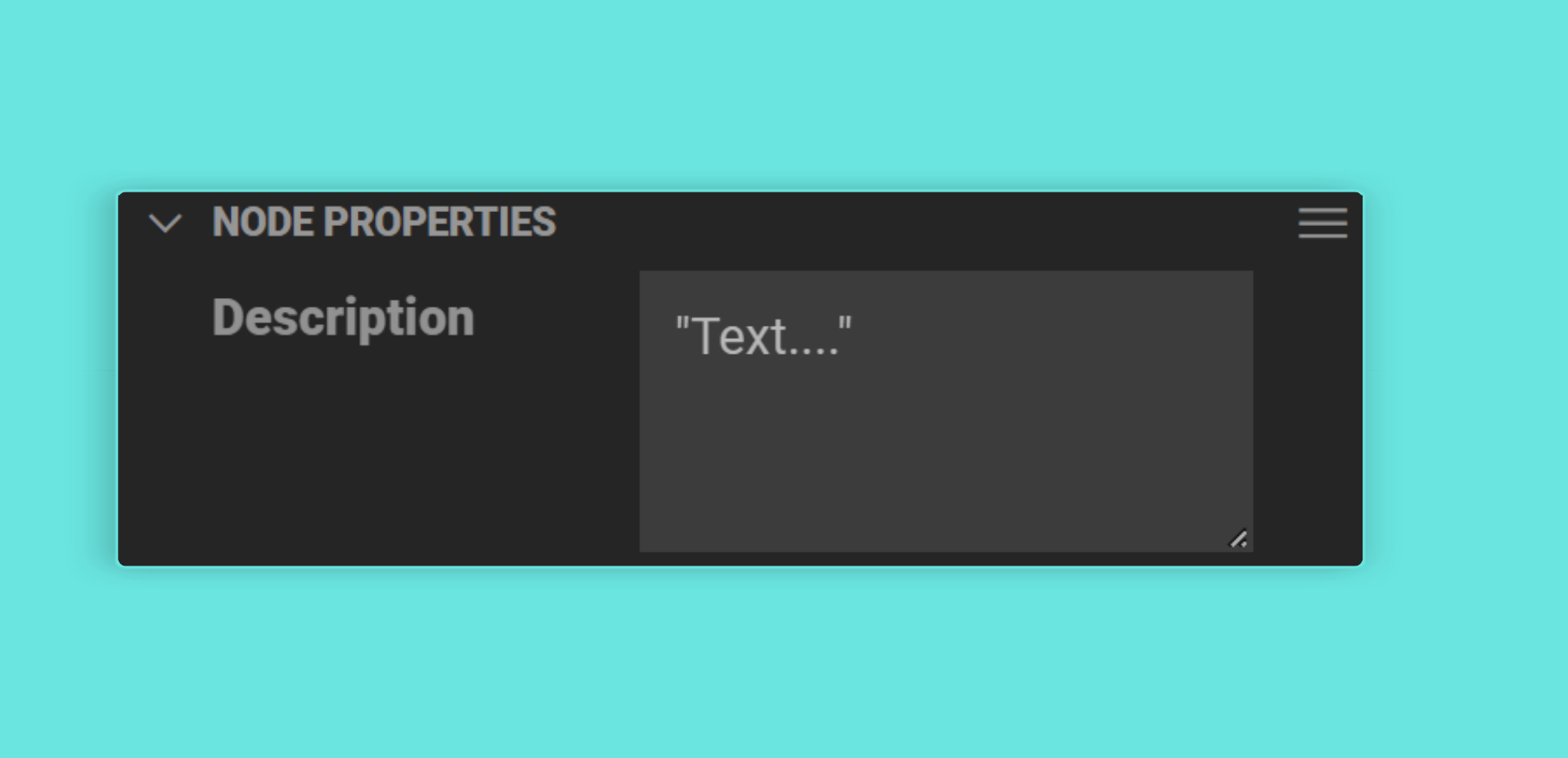

@ztype text-multiline
Shows a multi-line text input field.

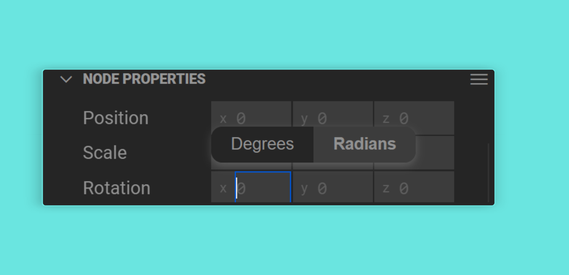

@ztype angle-radians and @ztype angle-degrees
Indicates that the property represents a value that’s either in radians or degrees. Mattercraft will show a switcher that allows the user to enter a value in the units they’re most comfortable with and will automatically convert that into the units required by the property.

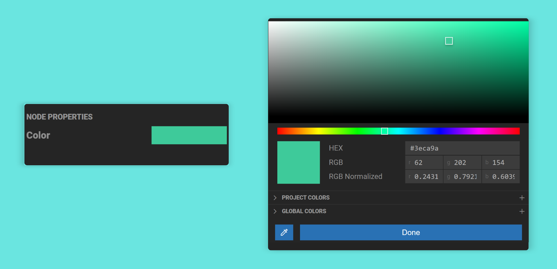

@ztype color-*
Indicates that the property represents a color. Mattercraft shows a color panel that allows the user to pick a color from a swatch or list or saved values.
The following options are supported:
| Property | Description |
color-norm-rgb or color-norm-rgba |
Represents either a 3 or 4 element array of numbers for red, green, blue and (optionally) alpha, that range between 0 and 1. |
color-unnorm-rgb or color-unnorm-rgba |
Represents either a 3 or 4 element array of numbers for red, green, blue and (optionally) alpha, that range between 0 and 255. |

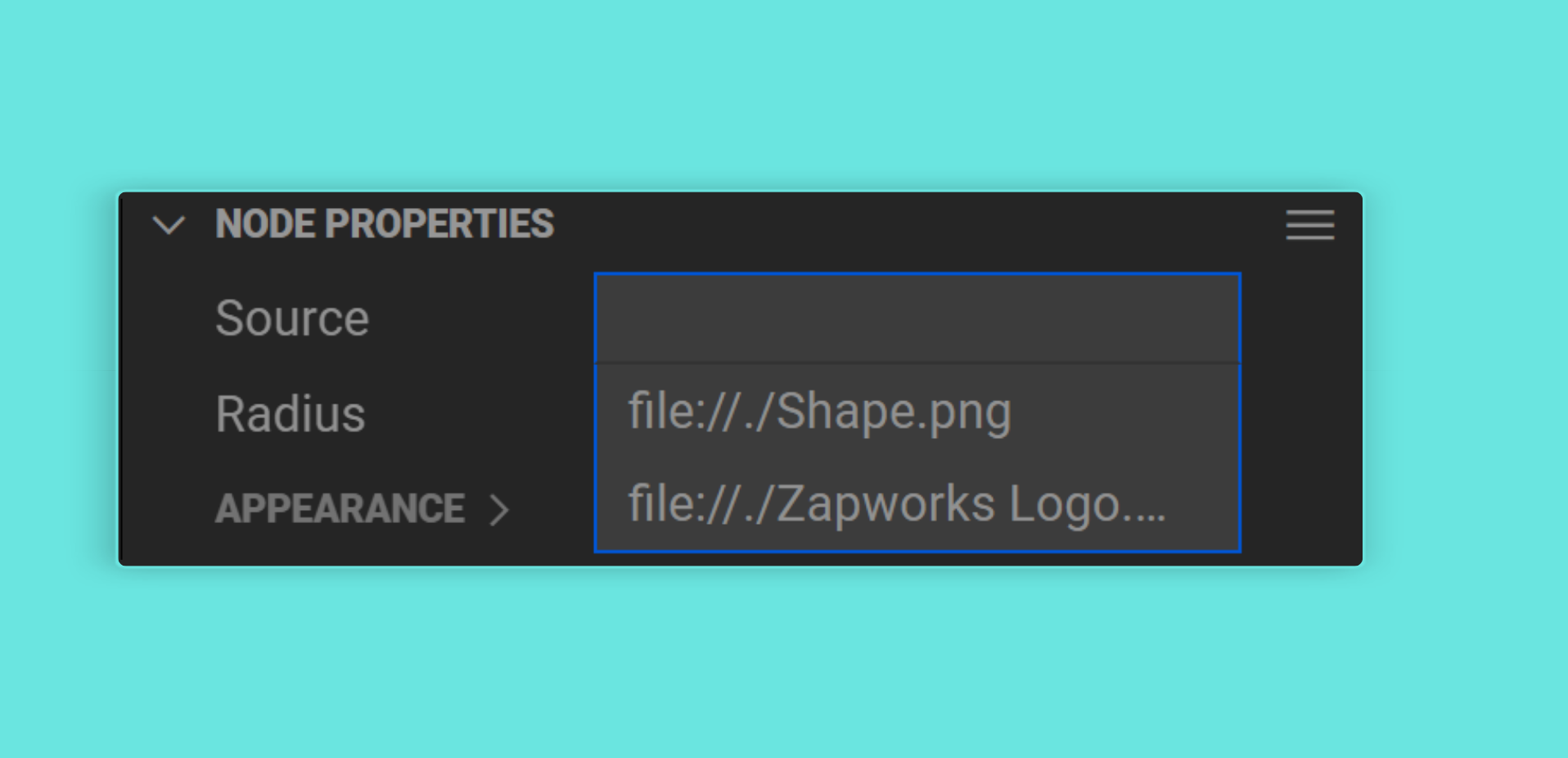

@zvalues files *.+(jpg|jpeg|png)
Autocompletes a list of files in the project that match the RegExp pattern supplied. At runtime, the value of the property will be a URL that can be used to fetch the file referenced by the property.
