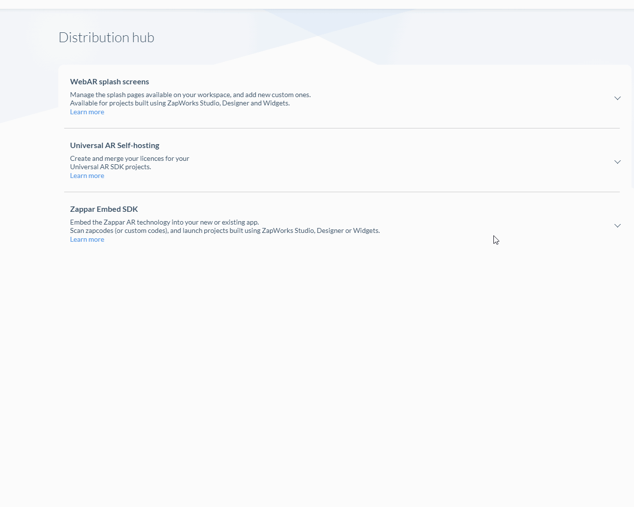

For anything else, you’ll need to register your license with ZapWorks. To register your app or website, select the Distribution hub tab on the left menu of your workspace.
In the Universal AR Self-hosting dropdown, click on the + icon to add a new license, and select the type of project you are registering i.e. a website, a native Android app or a native iOS app.
In this same modal, you’ll need to specify the identity of the project this new license will be tied to a Hostname (web), Package Name (Android), or Bundle Idenitifier (iOS), as well as a short description of your choice.
Please ensure that the identity you provide on ZapWorks exactly matches that of your project.
Clicking Create will add the license to your list allowing the app / site building process to continue.
