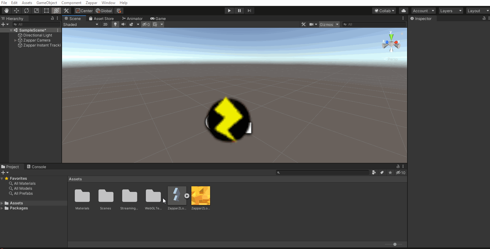

Tracking Digital Content
Section titled “Tracking Digital Content”To make the most of AR, you’ll want to track your digital content to your chosen tracking type. The steps below showcase a simple demonstration of how this can be done.
- Drag content from your Asset Panel directly on top of the tracking node in the scene Hierarchy.
- Scale, Position and Rotate the content accordingly.
