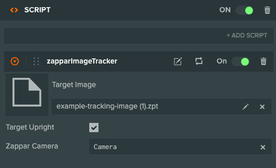

Once you’ve dragged the image tracking template into your hierarchy, you’ll have to set the ‘Target’ attribute to the ‘target file’ of the image you’d like to track.
Setting the 'Target' attribute and adding content to the Image Tracking templat
Translating content to 0.5 on the Y axis will make it sit on top of your tracking image.
This file should be a .zpt file, as it contains everything the Zappar library needs to detect and track the image in 3D space. You can generate them using the ZapWorks command-line tool like this:
