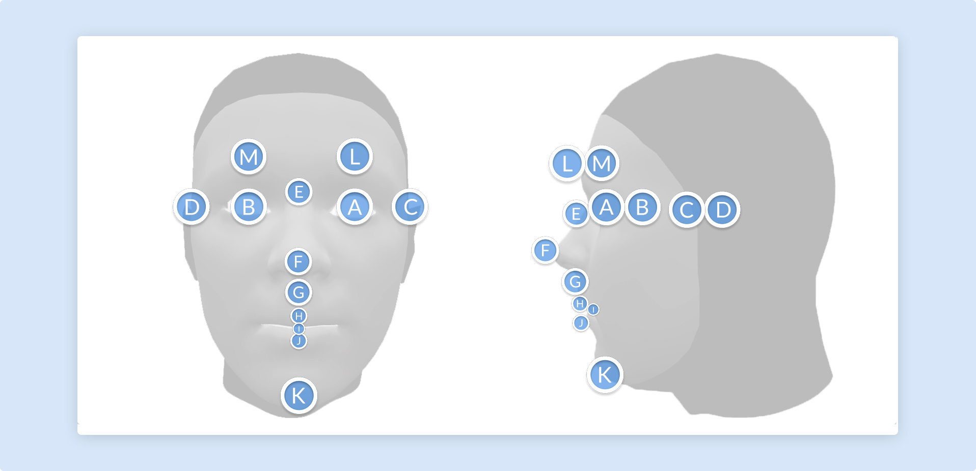

Face Landmarks
Section titled “Face Landmarks”In addition to tracking the center of the head, you can use FaceLandmarkGroup
to track content from various points on the user’s face. These landmarks will remain accurate, even as the user’s expression changes.
To track a landmark, construct a new FaceLandmarkGroup
component outside a zappar-face
entity; passing your face tracker, and the name of the landmark you’d like to track:
<a-entity zappar-face> <!-- PLACE CONTENT TO APPEAR AT THE ORIGIN (CENTER) OF THE FACE HERE --></a-entity>
<a-entity zappar-face-landmark="face: #face-anchor; target: nose-tip" id="zappar-face-landmark"> <!-- PLACE CONTENT TO APPEAR ON A FACE LANDMARK HERE --> <a-box width="0.05" height="0.05" depth="0.05" color="#4CC3D9"></a-box></a-entity>
The following landmarks are available:
Face Landmark | Diagram ID |
eye-left | A |
eye-right | B |
ear-left | C |
ear-right | D |
nose-bridge | E |
nose-tip | F |
nose-base | G |
lip-top | H |
mouth-center | I |
lip-bottom | J |
chin | K |
eyebrow-left | L |
eyebrow-right | M |
Note that ‘left’ and ‘right’ here are from the user’s perspective.
