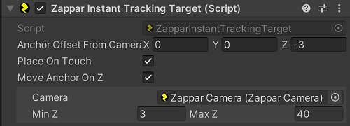

Instant Tracking Target Properties
Section titled “Instant Tracking Target Properties”Property | Description |
AnchorOffsetFromCamera | The Zappar Instant Tracking Target GameObject will keep the content in front of the camera using the AnchorOffsetFromCamera value until the user set the flag for UserHasPlace . AnchorOffsetFromCamera will offset the anchor position from the camera position based on the values set. |
PlaceOnTouch | By default, the Zappar Instant Tracking Target behaviour is mapped to user tap event (PlaceOnTouch ) and this property set to true . This is optional, you can instead set the value to false call ZapparInstantTracker.PlaceTrackerAnchor to override and customize this behaviour. |
MoveAnchorOnZ | Move the anchor along the z-direction before it’s placement, which allows to move the target along the forward facing direction of camera. The min/max Z defines how near/far away the anchor can move from camera. Note: it’s only pre-placement option. |
