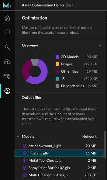

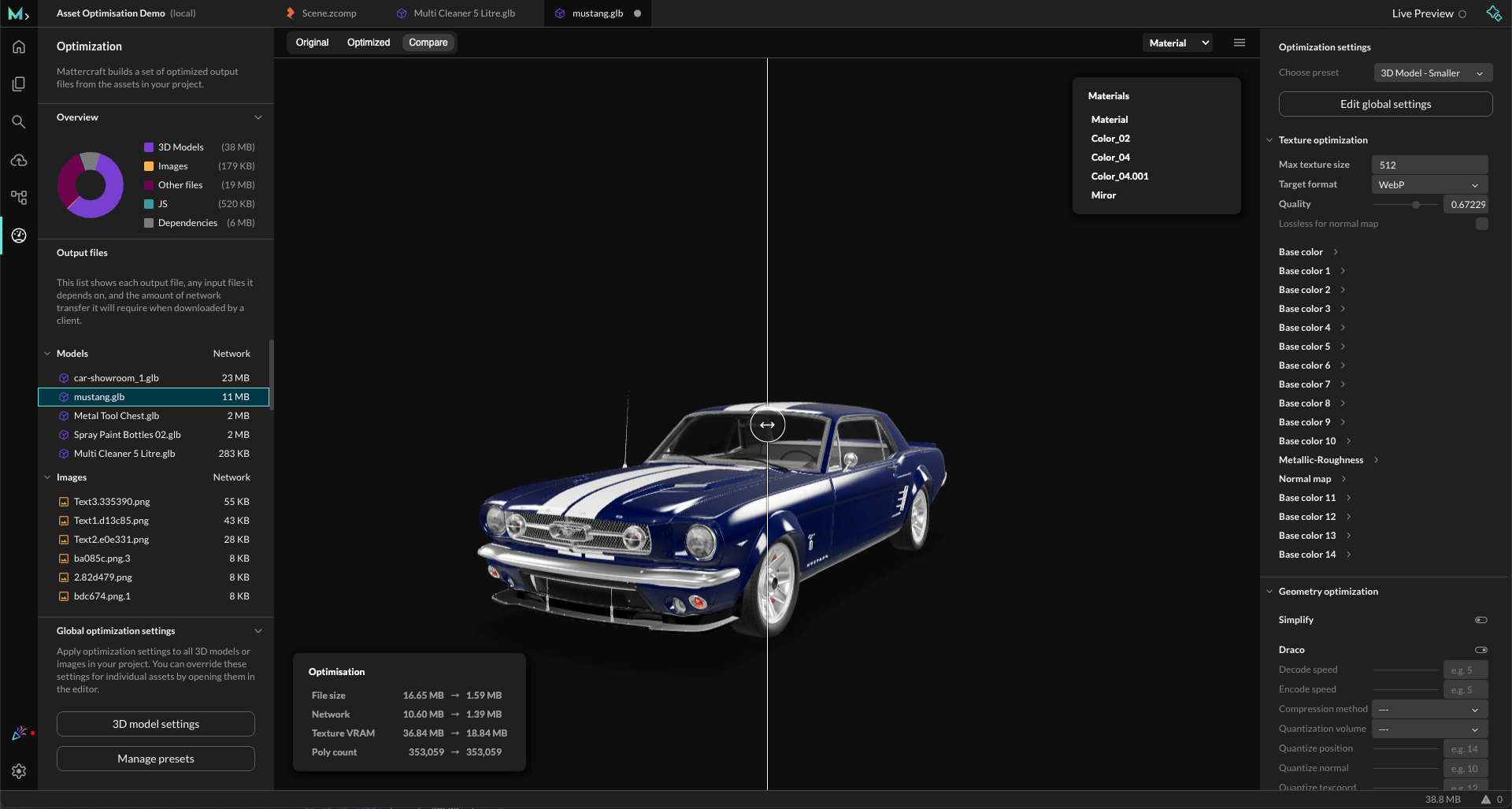

Mattercraft includes an Asset optimizer, which allows you to reduce 3D model sizes directly within the editor. This avoids the need for manual file preparation in external software.
Using the Asset optimizer
You can access the Asset optimizer either:
- By selecting a 3D model from the Project Files list, or
- From the Asset optimization tab in the left-hand sidebar.
Once open, you’ll see:
- A preview window where you can compare the original and optimized model (with a side-by-side slider).
- An overview of all assets in your project, showing file sizes and network usage.
- optimization settings for adjusting textures, geometry, and compression.
Texture optimization
- Set a maximum texture size (e.g. 512px for mobile, 1024px for desktop).
- Change the format (e.g. WebP) and adjust the quality slider.
- Ensure normal maps are kept lossless for accuracy.

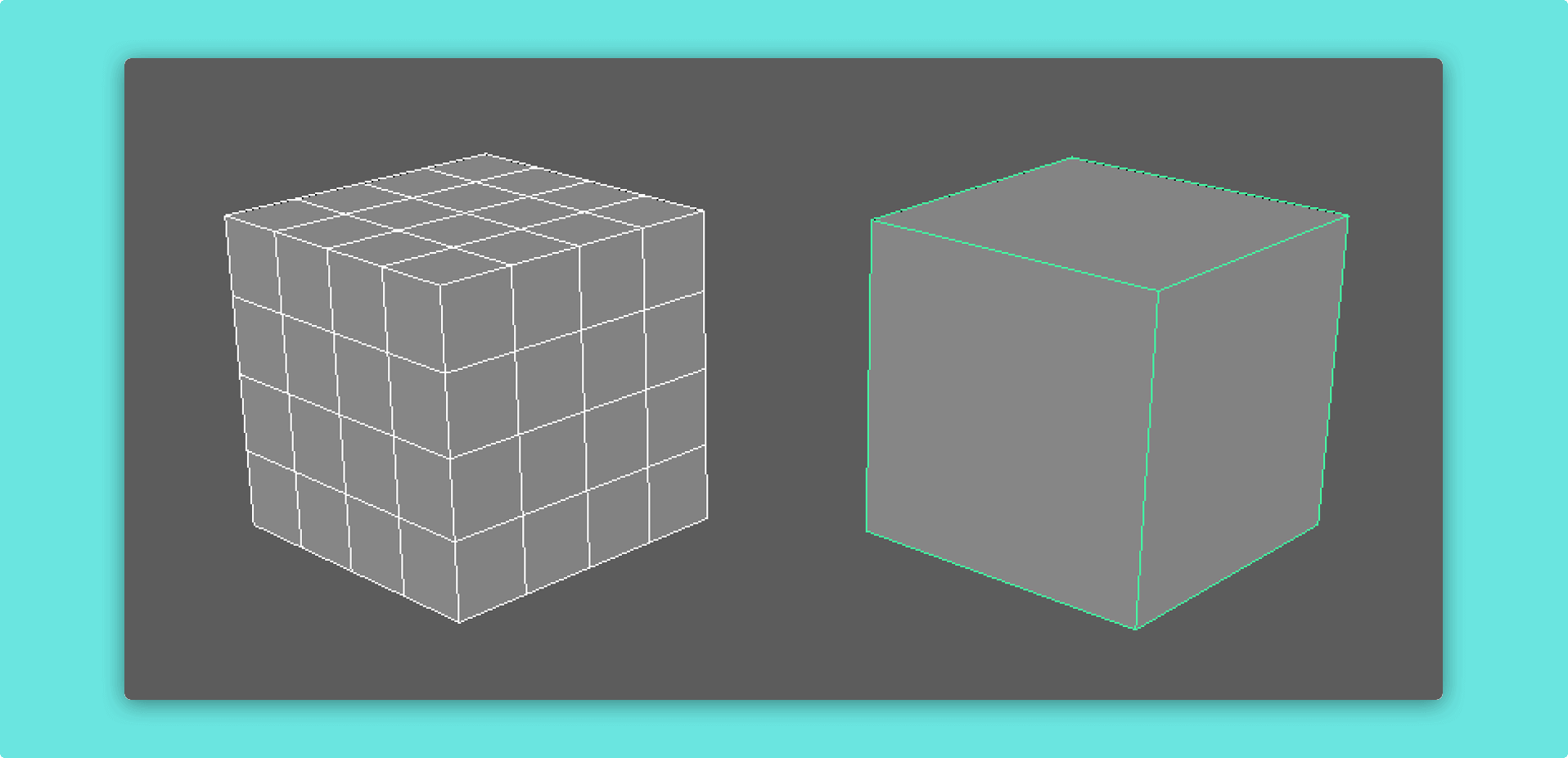

Geometry optimization
- Apply Draco compression to significantly reduce file sizes.
- Use mesh simplification and quantization to lower polygon count while maintaining quality.
- Enable welding and reordering to optimize vertex data.
Global optimization
At the bottom of the sidebar you’ll find Global optimization settings, which apply your chosen rules across all 3D models and textures in the project.
Review results
The optimizer will show you exactly how much space and network bandwidth you’ve saved. For example:
- File size reduced from 1.30 MB → 286 KB
- Network size reduced from 1.26 MB → 282 KB

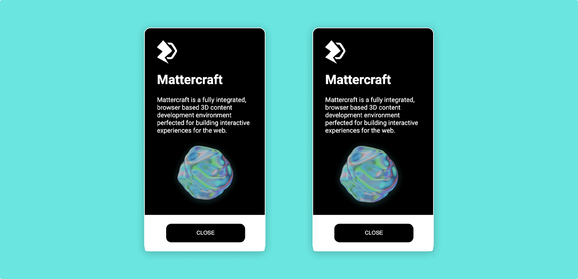

Section titled “Optimizing images”Export images at a lower resolution
The resolution of digital images is determined by their pixels per inch (PPI) setting, which sets the image’s pixel density. The higher this PPI is, the sharper the image will appear.
Reducing an image’s pixel density value will reduce its overall resolution and result in a smaller file size.
In the diagram above, the UI content on the left was exported at 1024px x 1024px, while the UI content on the right was exported at 512px x 512px. Though the latter produced a significantly lower file size, the reduction in image quality is not noticeable due to its small scale relative to the scene.

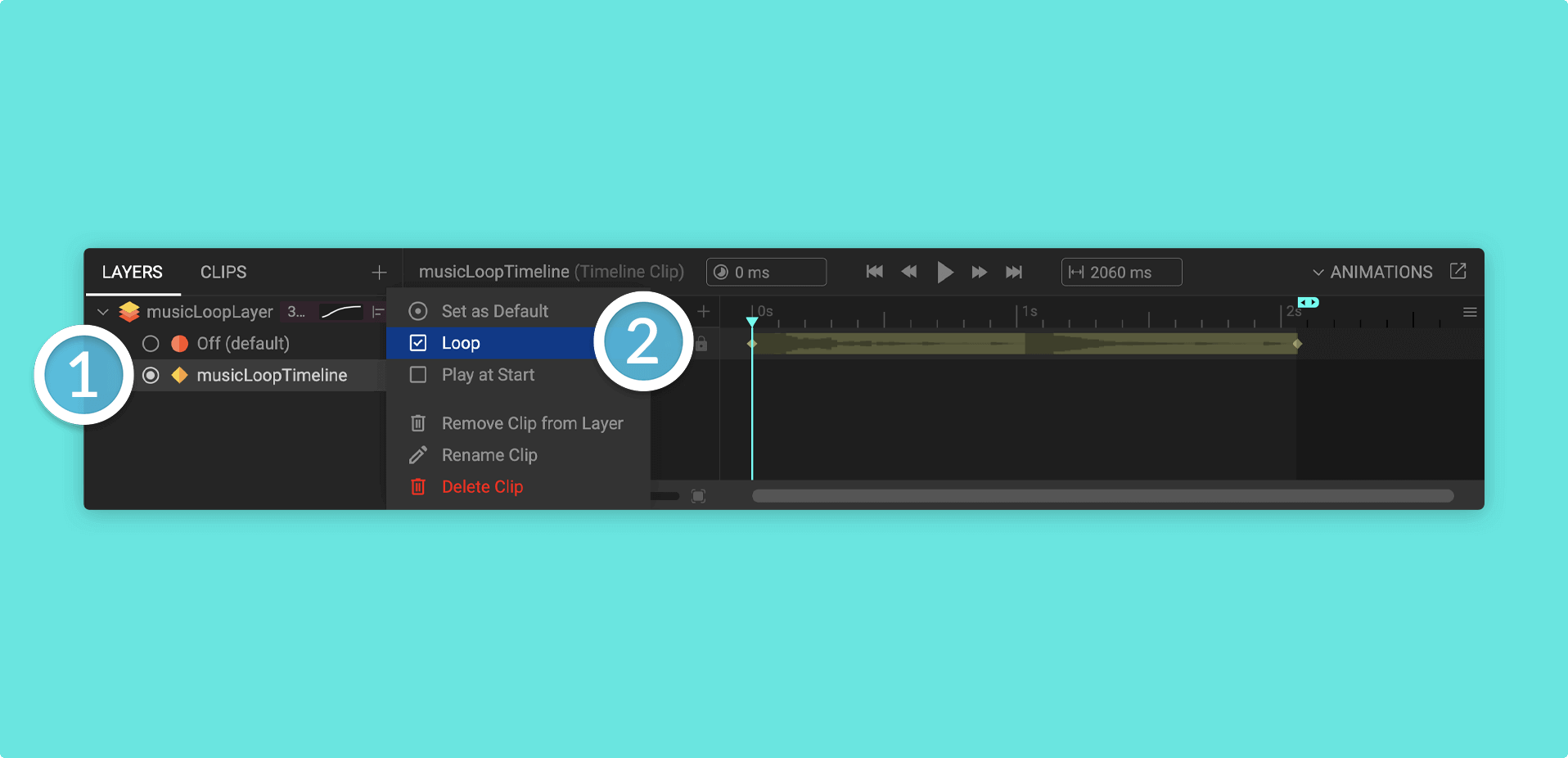

Trim long audio tracks
Long audio files that are comprised of a shorter, looping audio track can be exported as a single looped section instead. You can then use Mattercraft to loop the audio in your project.
