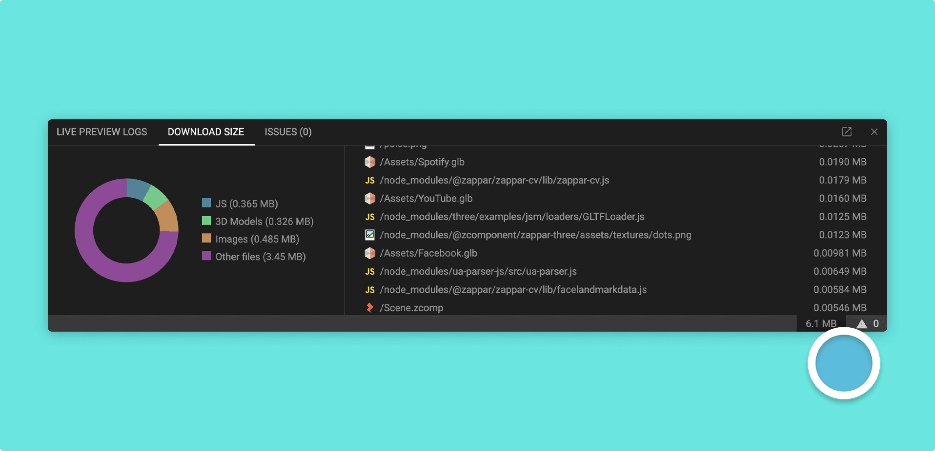

Accessing debugging features
Section titled “Accessing debugging features”To access the debugging features in Mattercraft, look for the debug panel located in the bottom right corner of the interface:
You can use the following tabs to debug your project:
| Status Bar tab | Description |
| Live Preview Logs | View messages logged from a script and allows you to see what devices are currently experiencing the project via Live Preview. |
| Download Size | Analyzes your project for insights into how much data end users are likely to download when they access your experience. |
| Issues | Shows the amount of issues in your project, along with the name of those errors and where you can find the node that caused it. |
