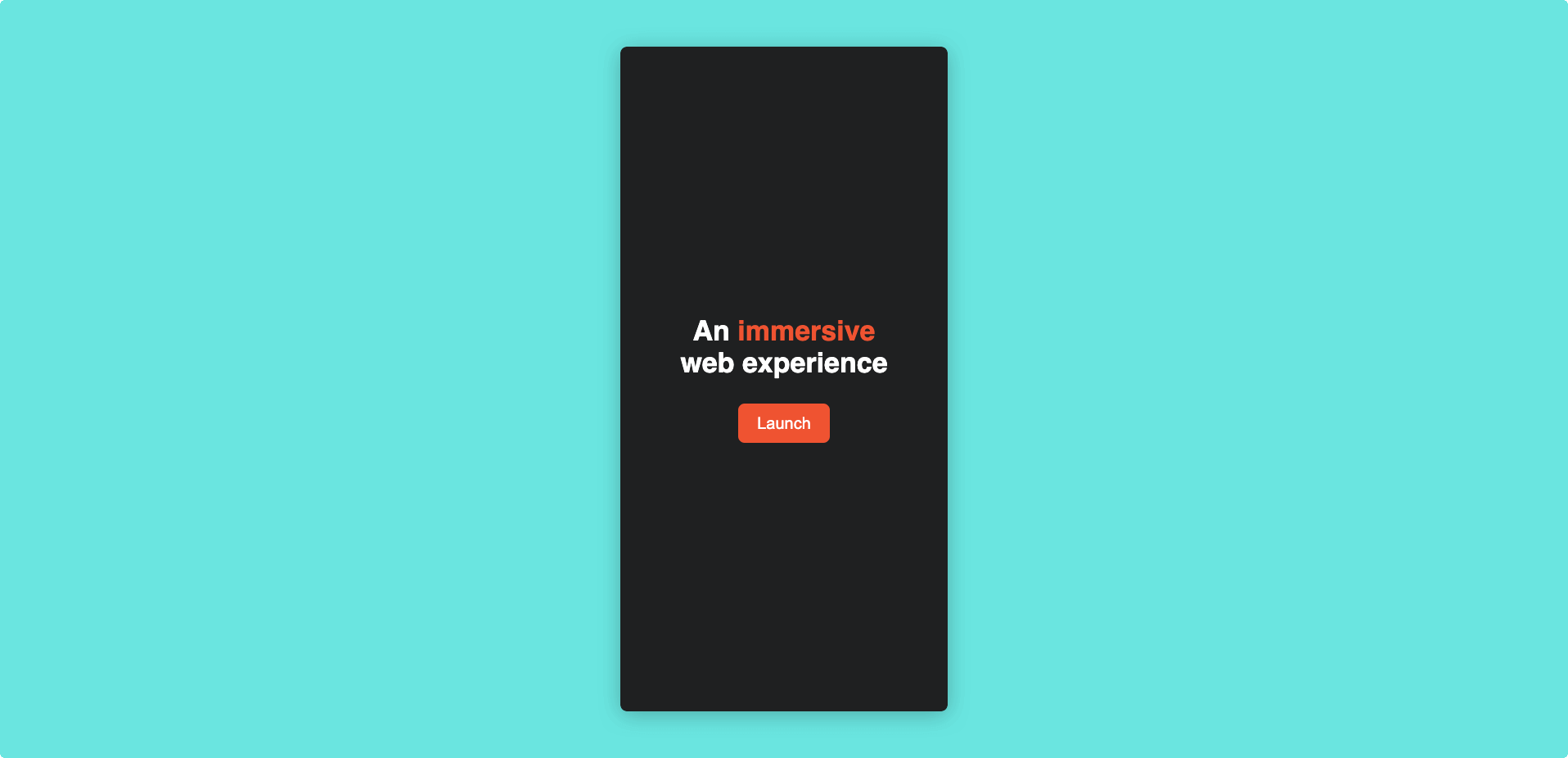

Updating the splash screen
Section titled “Updating the splash screen”The default splash screen in Mattercraft can be found in the index.html file within your project files.
To edit this splash screen, follow these steps:
- Open the
index.htmlfile - Customize the content and styling of the splash screen to your liking. You can change the text, add images, or apply CSS styles to create a visually appealing splash screen that reflects your project’s identity
- Save and preview your project to ensure that the updated splash screen appears as expected
Best Practices
Section titled “Best Practices”We always recommend updating the existing index.html file in your Mattercraft project, as this is setup perfectly for web experiences. However, you may replace this entirely if you’d like.
If you decide to replace the default
index.htmlwith one of your own, make sure that your newindex.htmlreferences theindex.tsscript file in your project. Failing to do so will hinder the project from functioning correctly.
