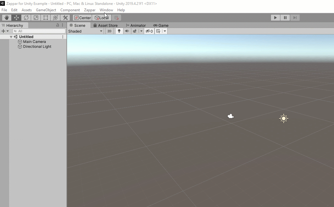

You can import the Zappar for Unity package directly from the editor by following these steps:
  1. Open the Package Manager from the Window>Package Manager in the editor interface.
  2. Locate the + button on top-left corner and select Add package from git URL...
  3. Enter the following URL: https://github.com/zappar-xr/universal-ar-unity.git
This will automatically fetch the latest version of the package from Github.

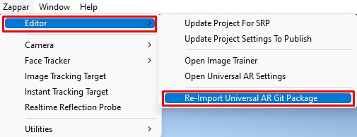

  • A new ‘Zappar’ menu entry.
In order to directly update the package with the latest version on github use the following Zappar menu option Zappar/Editor/Re-Import UAR Git Package.
