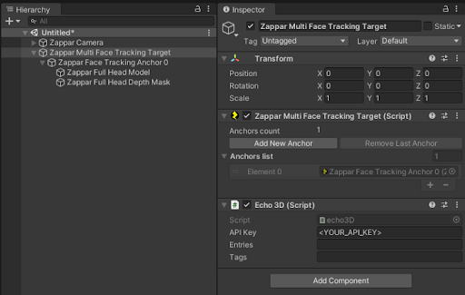

- Drag the
echo3d script
onto theZappar Tracking Target
and fill out the API key and entry ID details in the Inspector.
You can also drag the
echo3D prefab
onto the Zappar tracking type in the Hierarchy to make it a child of the tracker game object for more control.
