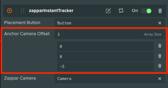

To choose the point in the user’s environment that the anchor tracks from, use the vector attribute of Instant Tracker.
The parameters passed in to this attribute correspond to the X, Y and Z coordinates (in camera space) of the point to track. Choosing a position with X and Y coordinates of zero, and a negative Z coordinate, will select a point on a surface directly in front of the center of the screen.
The group provides a coordinate system that has its origin at the point that’s been set, with the positive Y coordinate pointing up out of the surface, and the X and Z coordinates in the plane of the surface.
A typical application will offset the content each frame until the user confirms their choice of placement by tapping a button.
How far the chosen point is from the camera (i.e. how negative the Z coordinate provided to Anchor Camera Offset is) determines the scale of the coordinate system exposed by the anchor.
