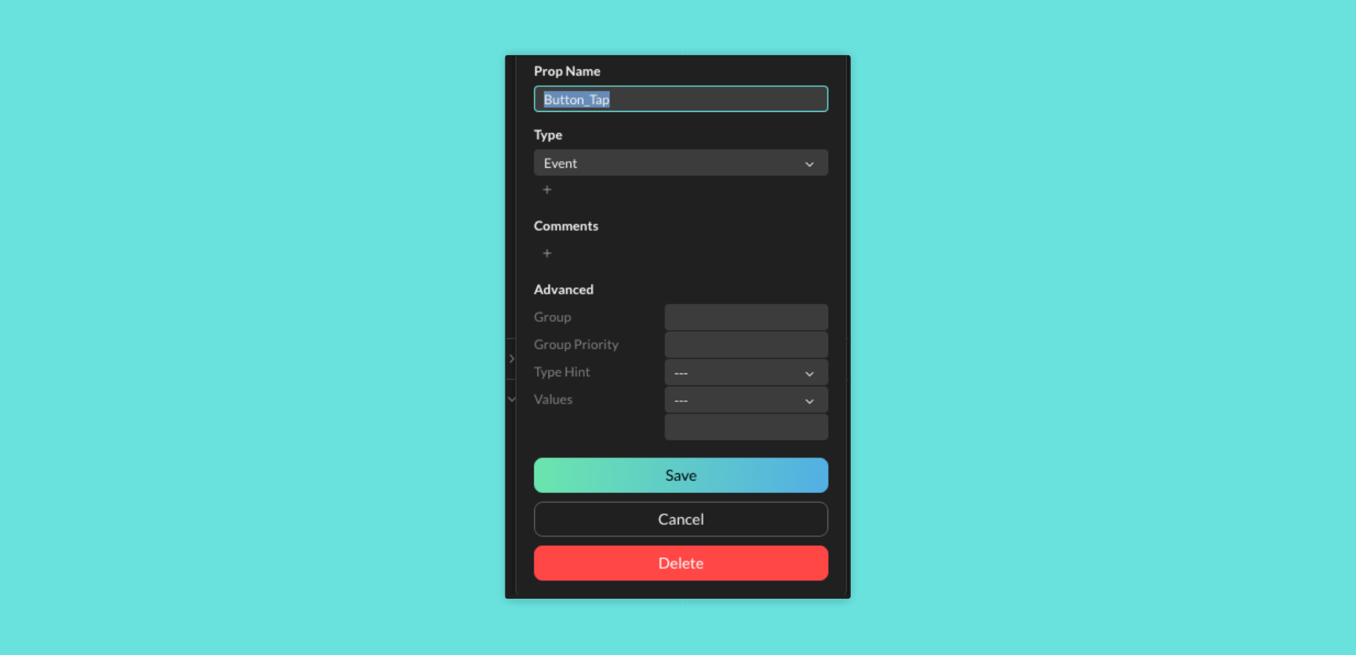

First, you’ll need to create a new Component Prop event.
  1. Go to the Component Props dropdown above the Hierarchy
  2. Click the plus (+) icon
  3. Give the custom component prop event a name (for example, Button Tap)
  4. Change the Type to Event
  5. (Optional) Update the other settings
  6. Click on Save to submit your new custom prop event
