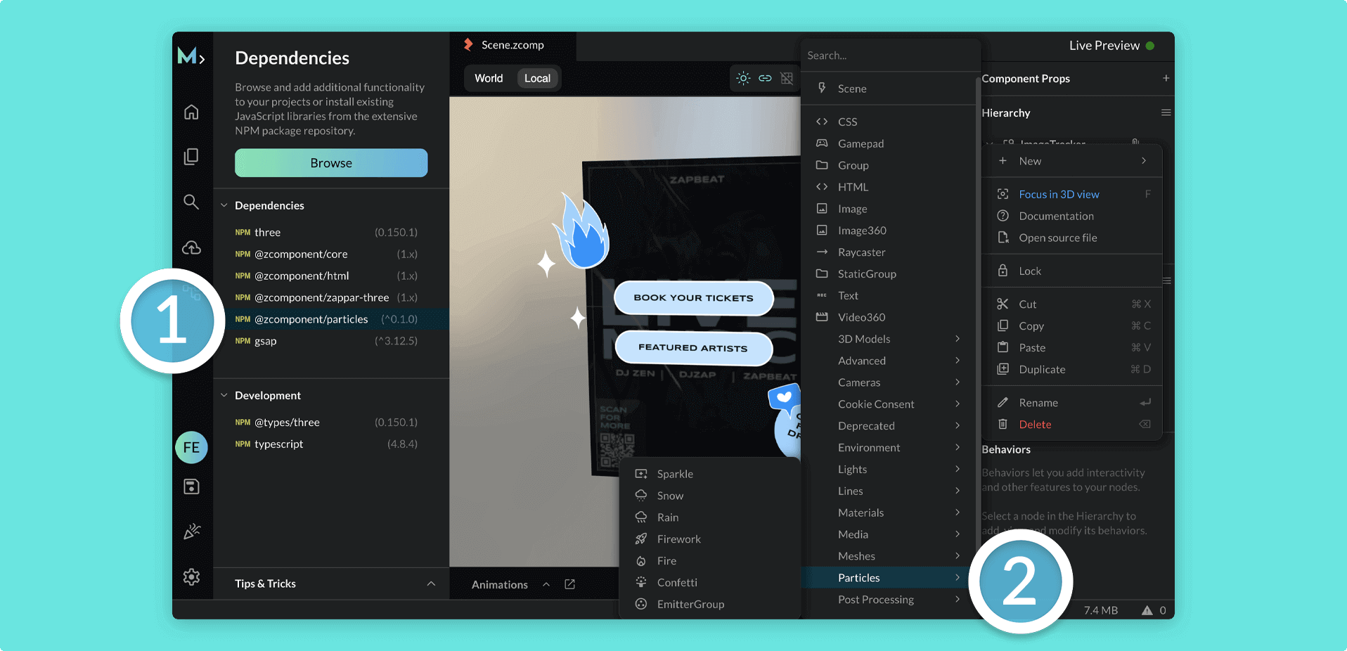

Once you have successfully installed a package into your project using the Dependencies Browser, you can start using it in your project.
Adding Add-ons to a zcomponent
Section titled “Adding Add-ons to a zcomponent”Additional Mattercraft features can be enabled as a Component or Behavior Action.
