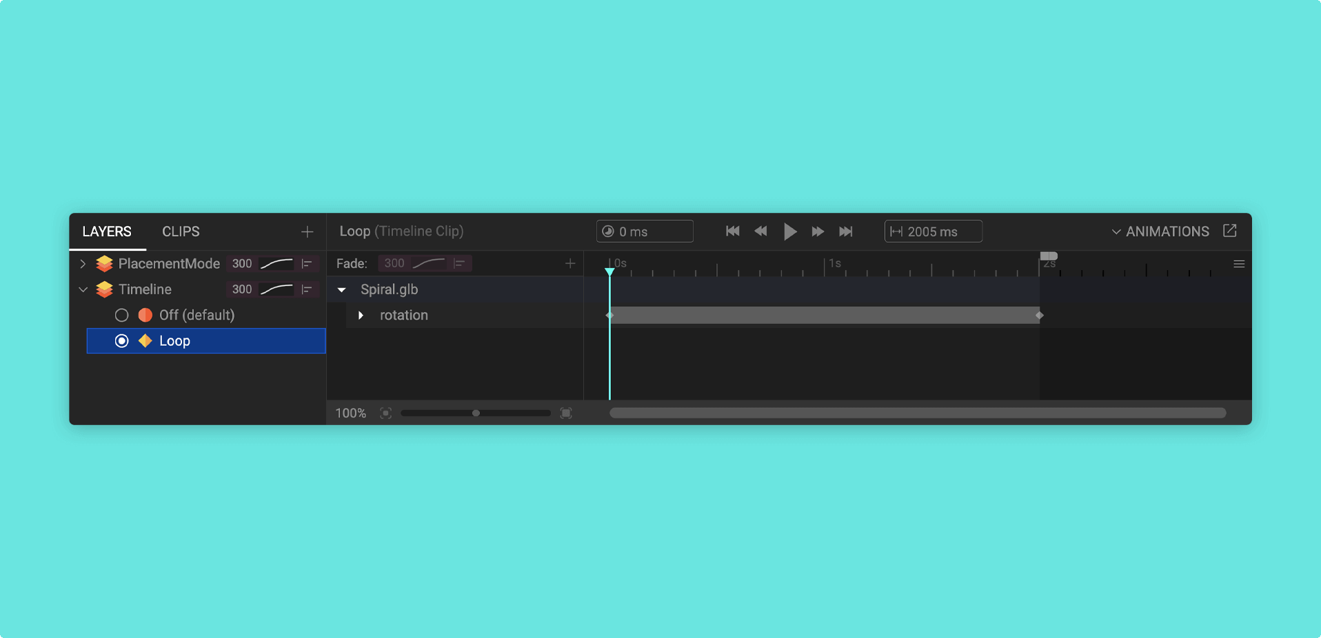

While a timeline is selected, the timeline clip editor is shown along the bottom of Mattercraft’s UI. Custom transition animations are displayed in this view.

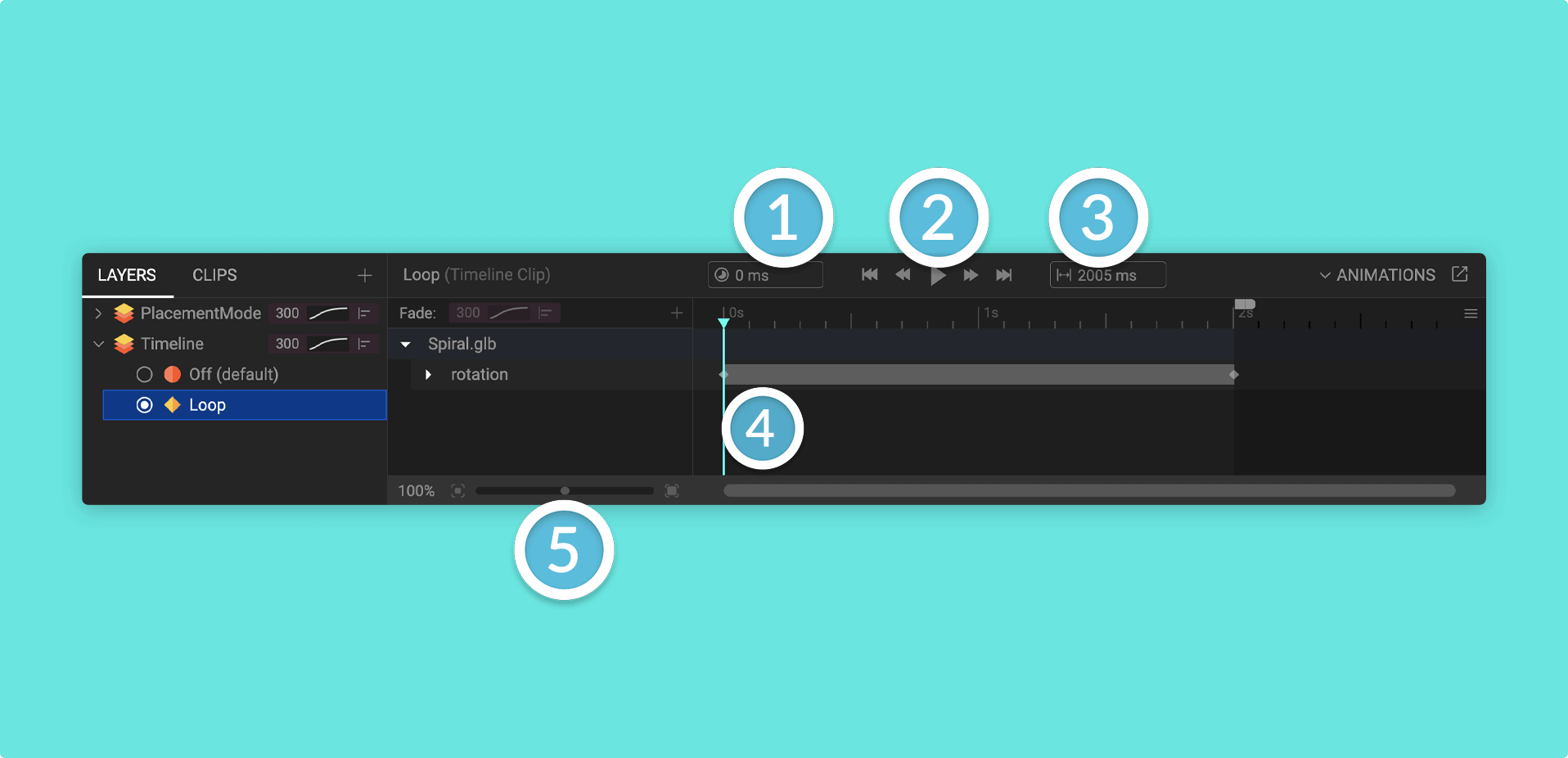

Navigating the timeline
You can navigate a timeline with the following common features:
NavigationDescription
(1) Seek bar timeThe time at which the seek bar is positioned along the timeline. Update your Settings to alter time scale in milliseconds (ms), seconds (s) or Hertz (hz).
(2) Timeline controlsTimeline controls allow you to play or pause playback, jump to the start or end of the timeline, and jump to the previous or next keyframe.
(3) Timeline lengthThe total length of the timeline. Update your Settings to alter time scale in milliseconds (ms), seconds (s) or Hertz (hz).
(4) PlayheadShows where you are focused at a point on a timeline.
(5) Zoom levelSets the zoom level of the timeline. You can traverse through the timeline with the scroll bar to the right of the zoom level.

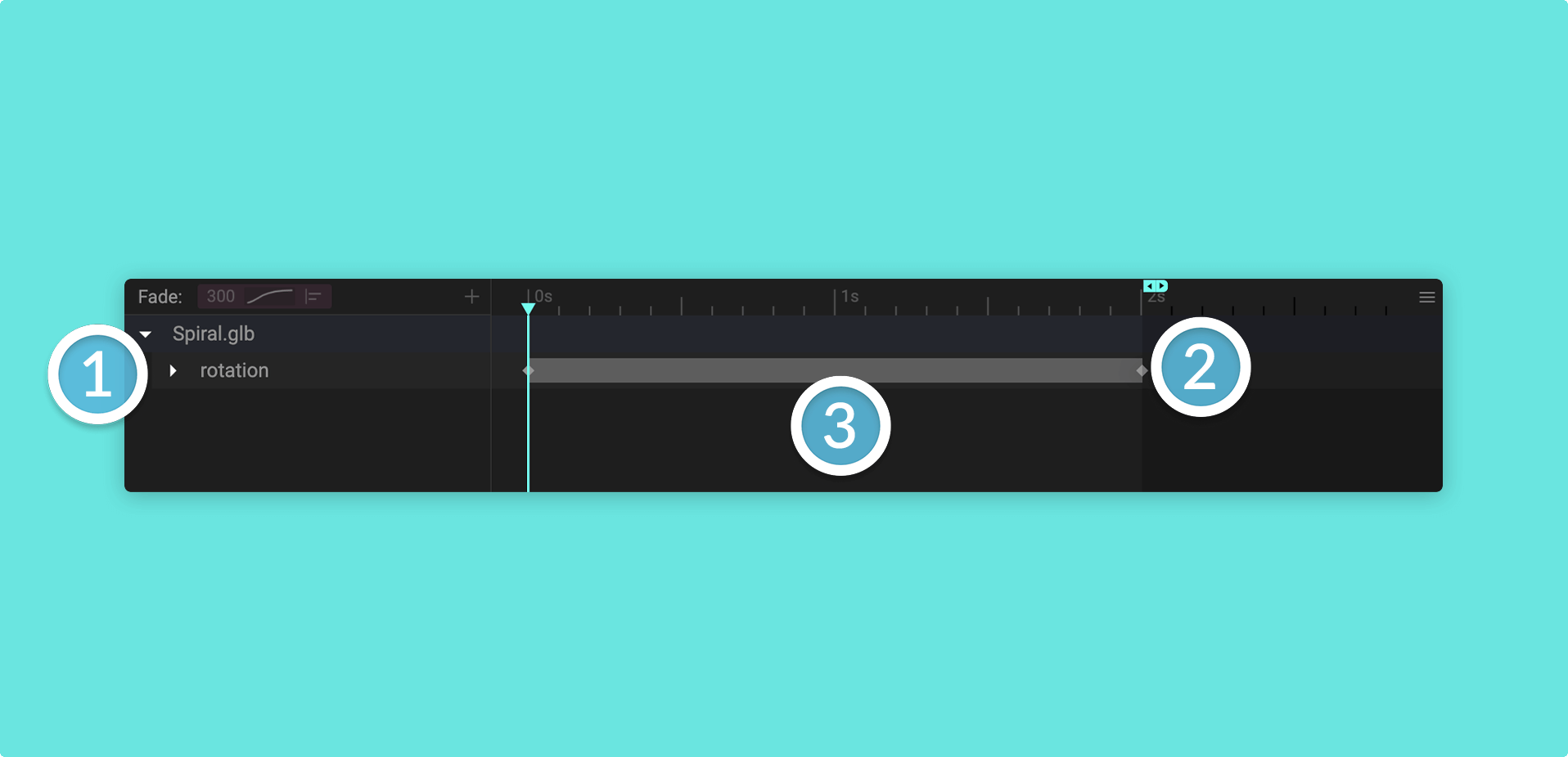

Keyframes and eases
To create transition animations on a timeline, you must add keyframes and eases to it.
Timeline clip featuresDescription
(1) Node propertiesThe nodes and properties that are being transformed.
(2) KeyframeA keyframe holds node property values at a certain point of an animation. Keyframes can be transitioned to and from other keyframes.
(3) EasingHow an animation looks as it is transitioning to the next keyframe.

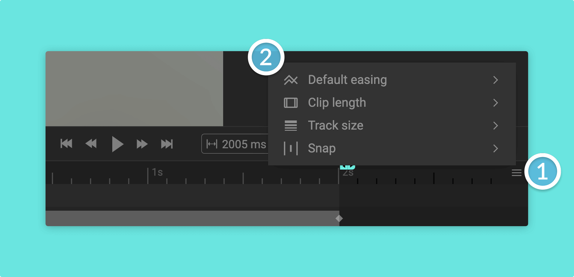

Clip settings
The clip settings are a quality of life feature to help you manage your workflow.
The entries in this menu are as follows:
Clip settingDescription
Default easingChoose a default easing type for the Left side or Right side of the timeline.
Clip lengthDescribes how the timeline decides its length. Auto will automatically make it as big as the last keyframe, Expand will make the timeline longer. Manual will allow you to dictate the end of the timeline.
Track sizeChanges how the track appears in the timeline. Default is Medium, but you can also make the track Small or Large depending on your preference.
SnapChoose if playhead or keyframes should snap to each other. Options are: Playhead to keyframes, Keyframes to playhead and Keyframes to keyframes.

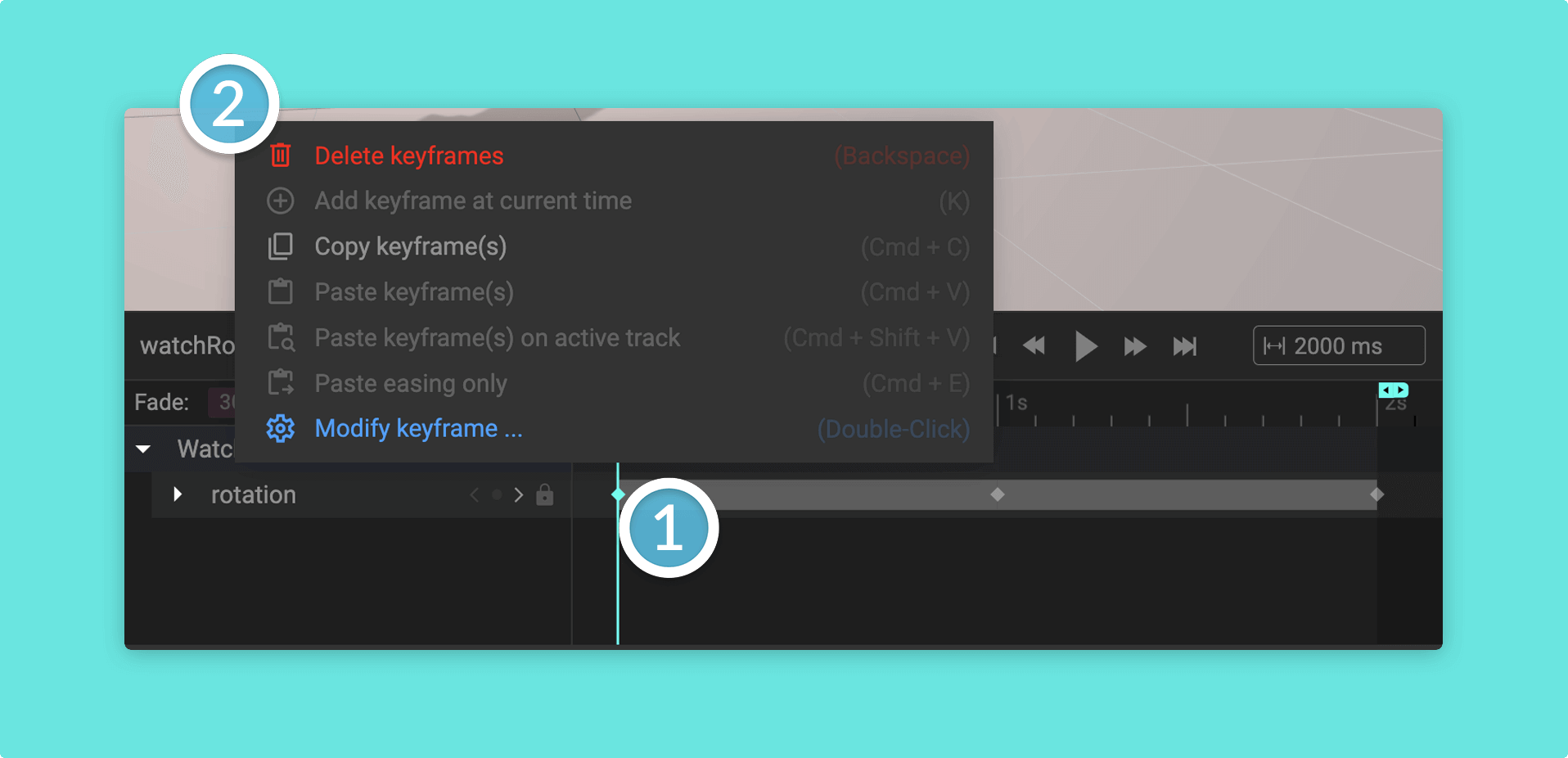

Keyframes will be automatically added to the timeline when you adjust a node’s property, but you can also create your own keyframes by right clicking on the playhead and selecting Add keyframe at current time.
As well as modifying properties, you can right-click on a keyframe or easing for the following options:
Track optionDescription
Delete keyframesRemove the keyframe from the timeline.
Add keyframe at current timeAdds a keyframe where the playhead is situated on the timeline.
Copy keyframe(s)Copy one or more keyframe(s) with their current property set. You can copy keyframes from one timeline and paste them on a different timeline.
Paste keyframe(s)Paste one or more keyframe(s) with their current property set. The keyframe(s) will be placed where the playhead is situated on the timeline. If there is more than one keyframe, the first keyframe will be placed at the playhead and the remaining keyframes will be situated relative to the playhead.
Paste keyframe(s) on active trackPaste one or more keyframe(s) with their current property set in the active timeline (this does not necessarily have to be the timeline the keyframe(s) initially exist(s) within). The keyframe(s) will be placed where the playhead is situated on the timeline. If there is more than one keyframe, the first keyframe will be placed at the playhead and the remaining keyframes will be situated relative to the playhead.
Paste easing onlyPaste the easing between two keyframes but keep the keyframe values the same.
Modify keyframeUpdate the set property values for a keyframe.
Modify easingUpdate the easing transition with the curve editor. You may use the default ease options or create your own custom easing with the easing editor to create your own transition curves.
