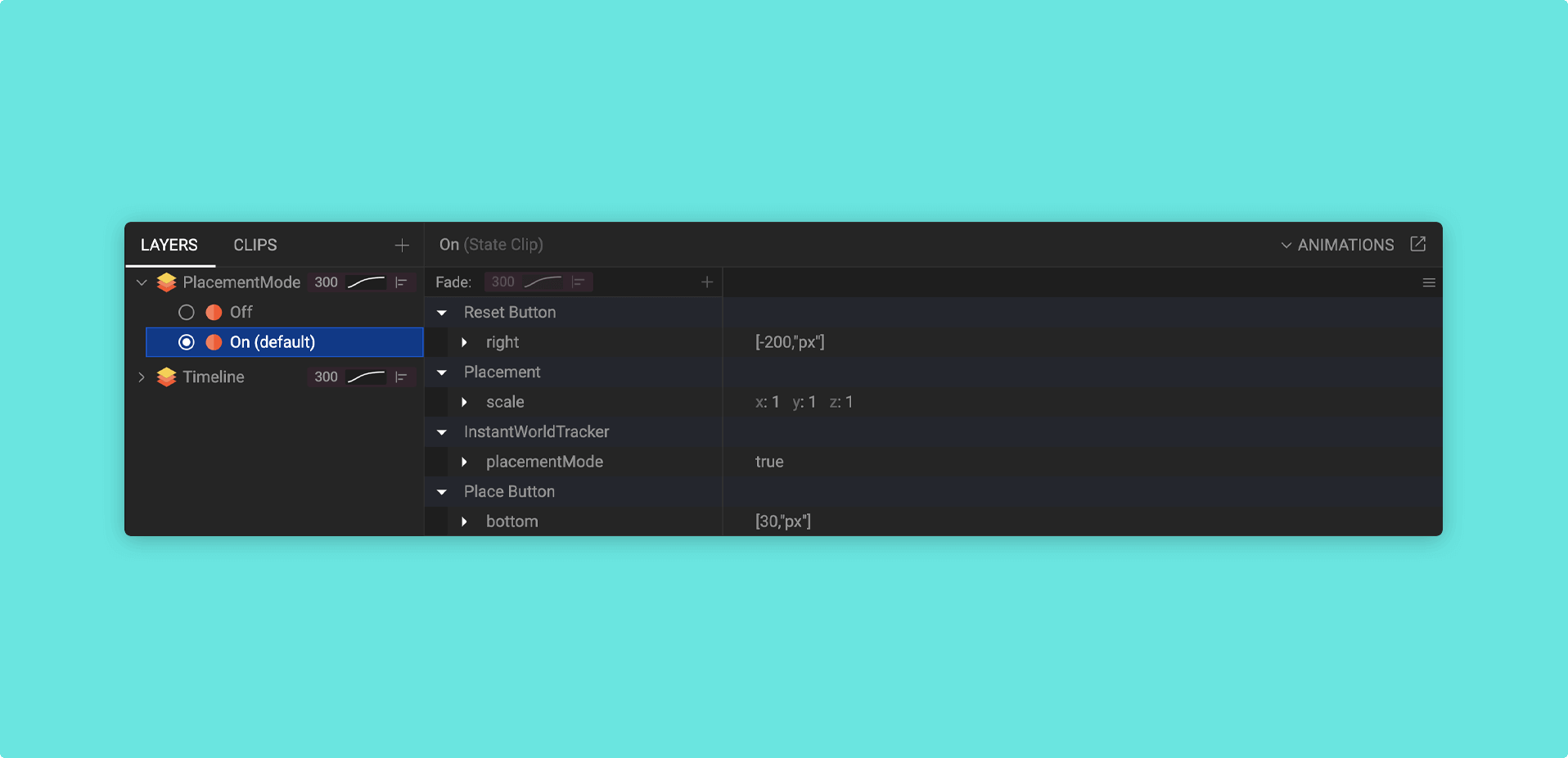

Creating a new state in a layer
To add a new state in a layer:
  1. Click on the Animations panel to open it up
  2. Click on Layers if it is not already selected
  3. Hover over your Layer until you see the 3 interactive dots
  4. Go to + Add and then New State
  5. Type in your new state’s name and then use the State Clip editor to begin altering the value of node or behavior properties

  1. Find your State in the relevant Layers or Clip tab
  2. When you find your State, click on it and the State Clip editor will open
  3. Simply adjust the values of your node properties by using the State Clip editor and the Node Properties or Behaviors Panel
