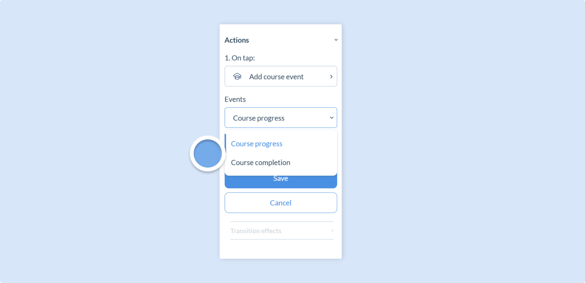

Adding Course Events
Section titled “Adding Course Events”To add course events to your experience, select a Component within the appropriate scene and use the Actions property to add a course event then select one of the two events, Course progress or Course completion.
Designer has two action types, On Tap Actions and On Finish Actions, and both can be used to trigger either of the course events.
| Action Type | Available Components | Example Course Event |
| On Tap | Buttons, Images, 3D | Answering a question with Screen UI buttons that have an on-tap action to trigger the Course progress event. |
| On Finish | Videos | Watching a video to the end to add a Course completion event. |

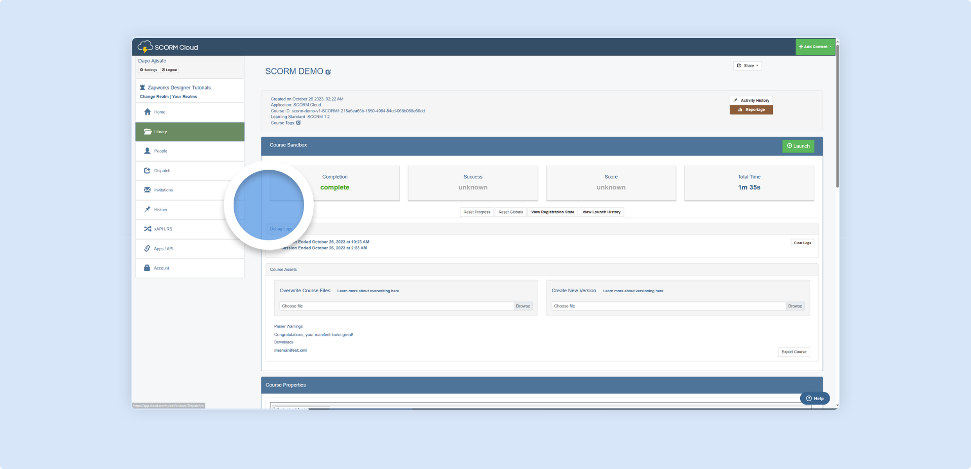

Importing into an LMS
Section titled “Importing into an LMS”Once exported, the SCORM package can be imported into any LMS for tracking. SCORM Cloud provides a free LMS for testing and if it works there, it should work in your LMS.
