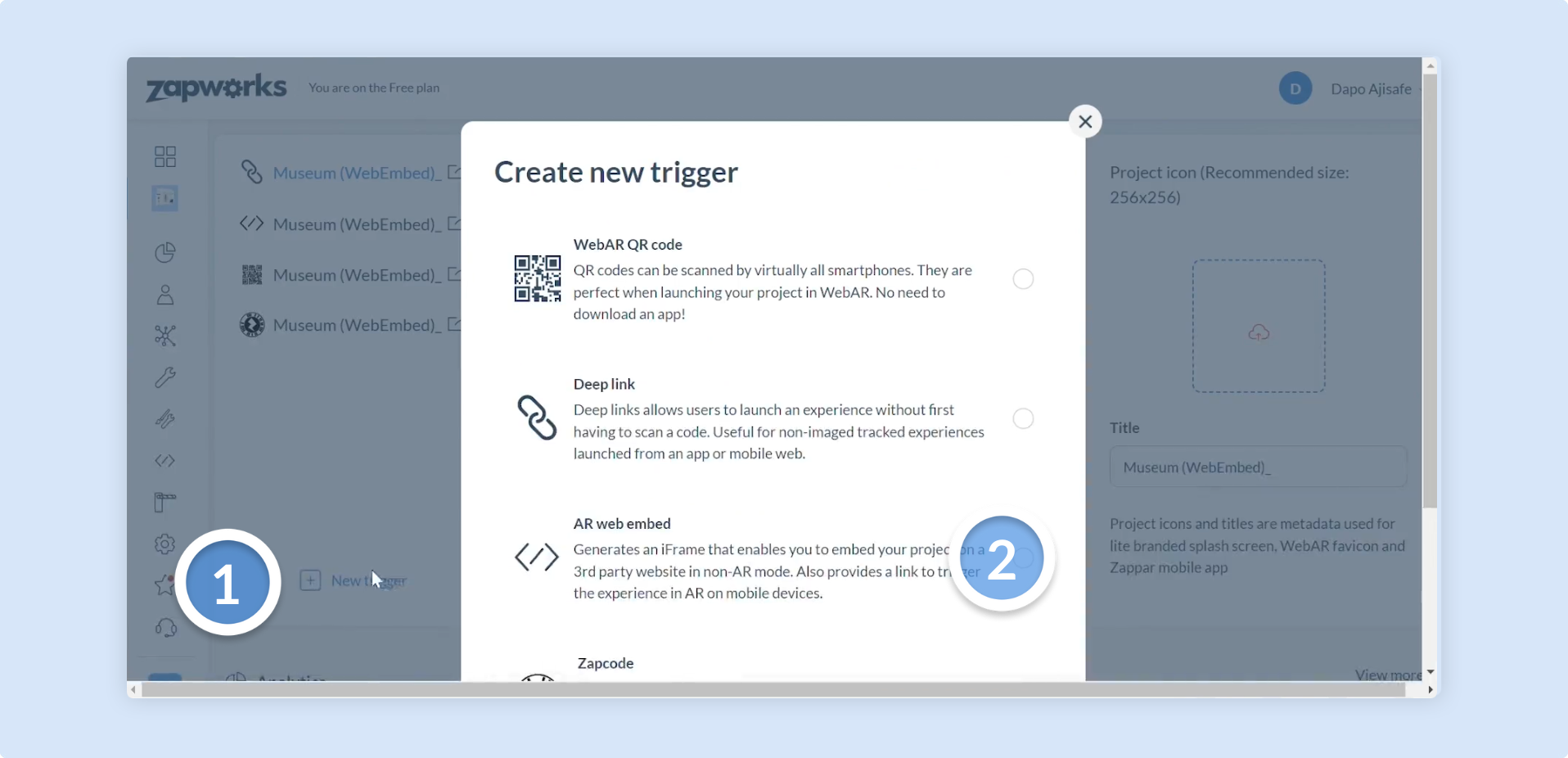

  1. While you’re in your project dashboard within the Zapworks CMS, create a new trigger and select Deep link. ![](/img/designer/ar-web-embed/embedding-into-your-site/framer instructions/framer1.png)

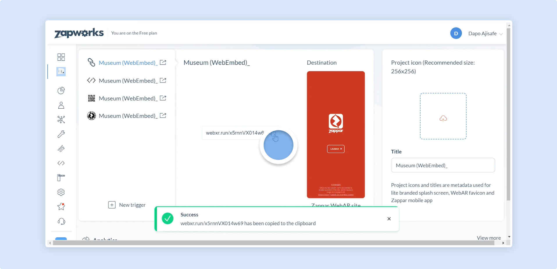

  2. Copy the Deep link trigger URL. ![](/img/designer/ar-web-embed/embedding-into-your-site/framer instructions/framer-0.png)

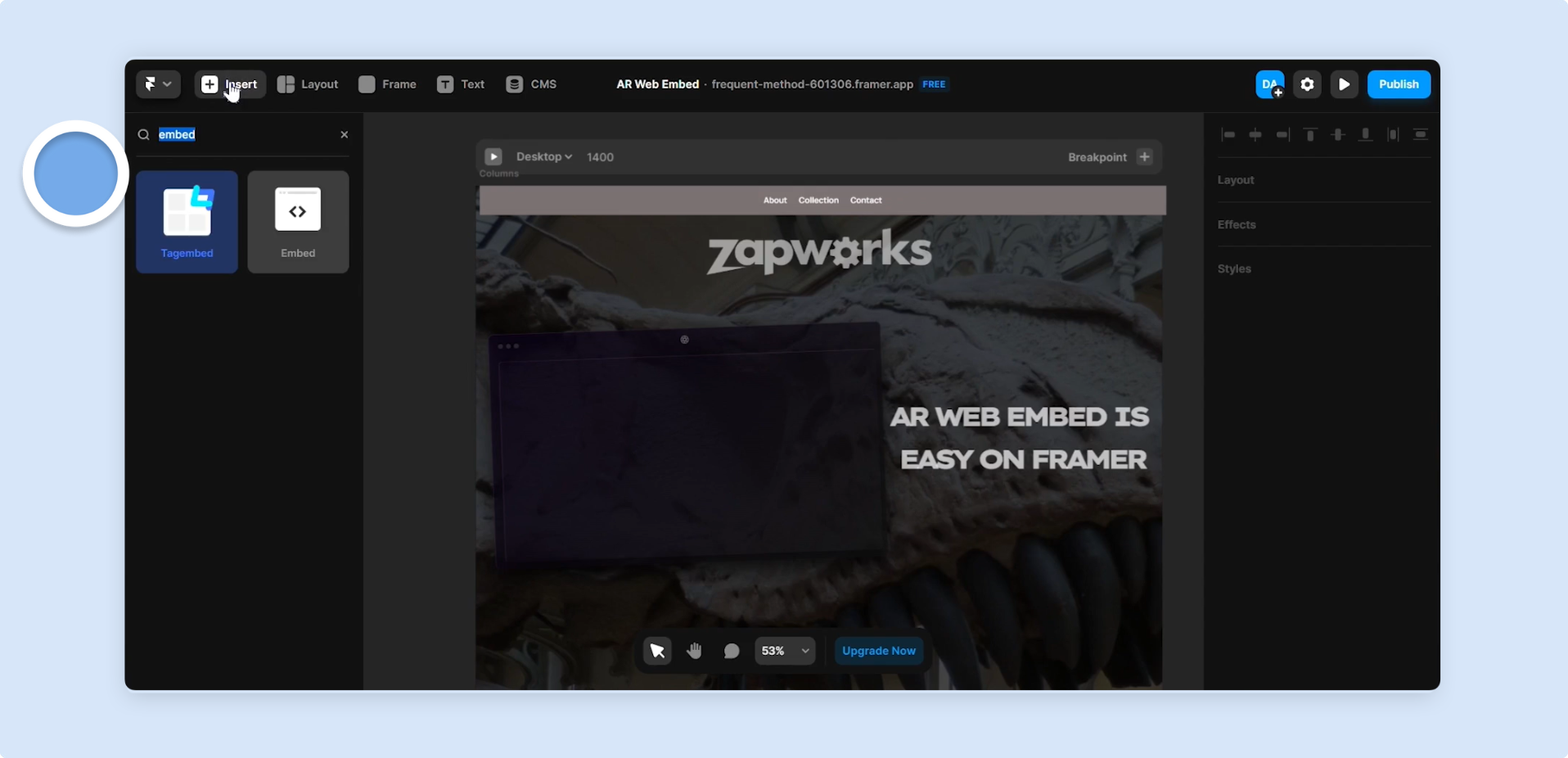

  3. In the Framer editor, on the left of the top menu panel, click on + Insert . Enter Embed in the search bar, then drag the embed component onto your page. ![](/img/designer/ar-web-embed/embedding-into-your-site/framer instructions/framer-3.png)

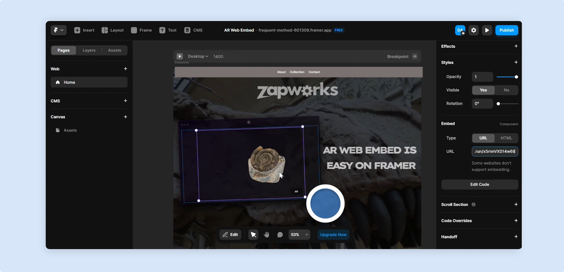

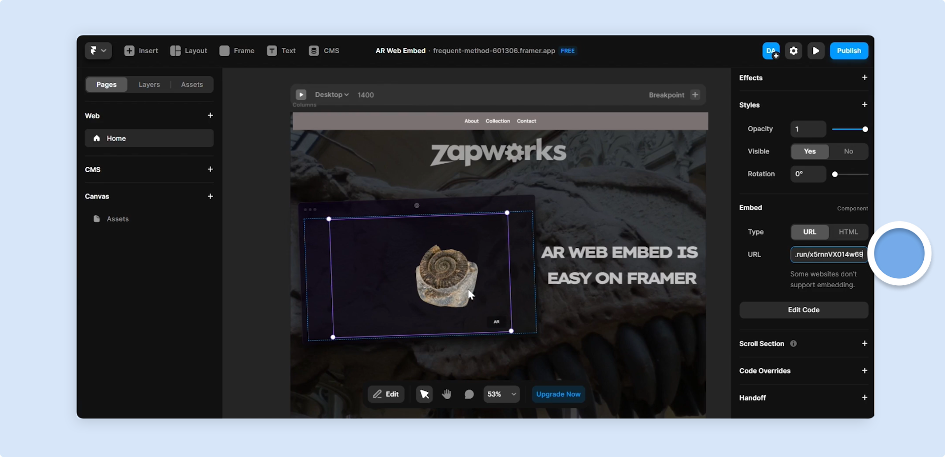

  4. In the Embed Settings panel, scroll down to the Embed section. Make sure URL is selected, paste in your Designer project’s Deep link URL, and then press enter. ![](/img/designer/ar-web-embed/embedding-into-your-site/framer instructions/framer-4.png)
  5. You can change the size of the embed component by dragging its adjustment points or using the size property in the embed settings panel. ![](/img/designer/ar-web-embed/embedding-into-your-site/framer instructions/framer-5.png)

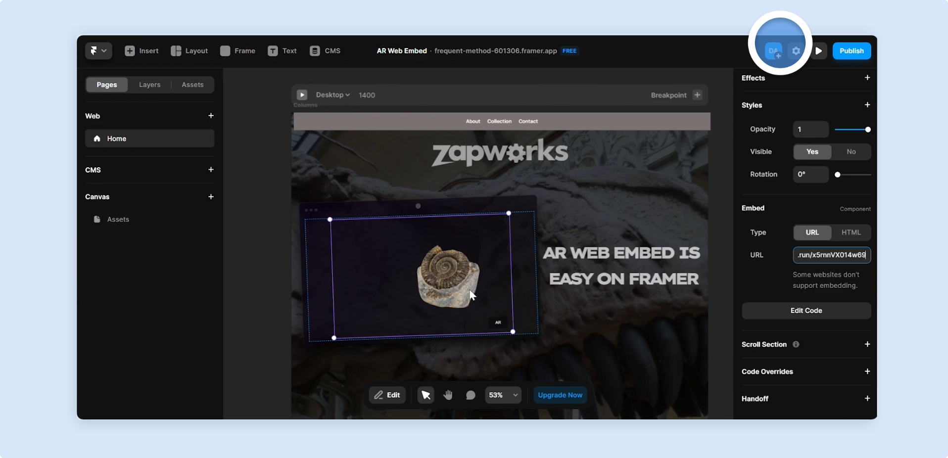

  6. Once you’re happy with the size and look of your embed, click the Play button at the top right of the editor to preview your page and interact with the embed. ![](/img/designer/ar-web-embed/embedding-into-your-site/framer instructions/framer-6.png)
