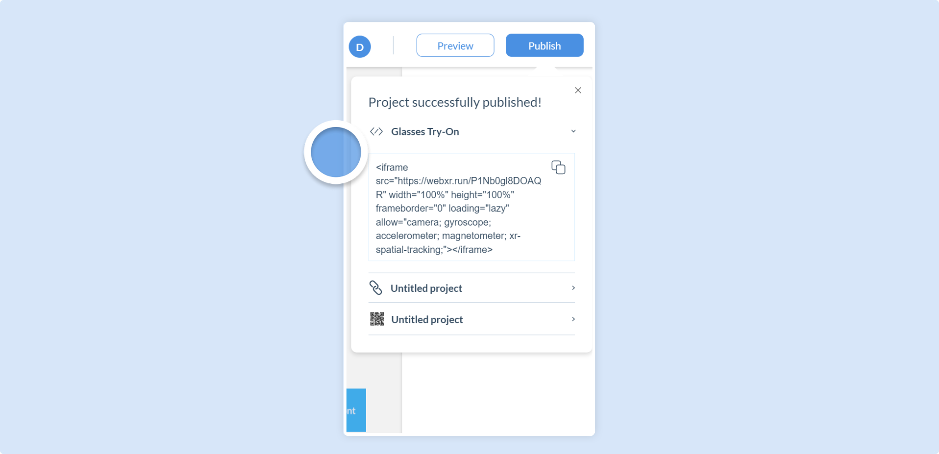

If you head back into the Designer tool and click Publish, you will see the AR Web Embed trigger appearing in the dropdown menu. From here, you can copy the iframe code.
Accessing the embed code in the Designer editor

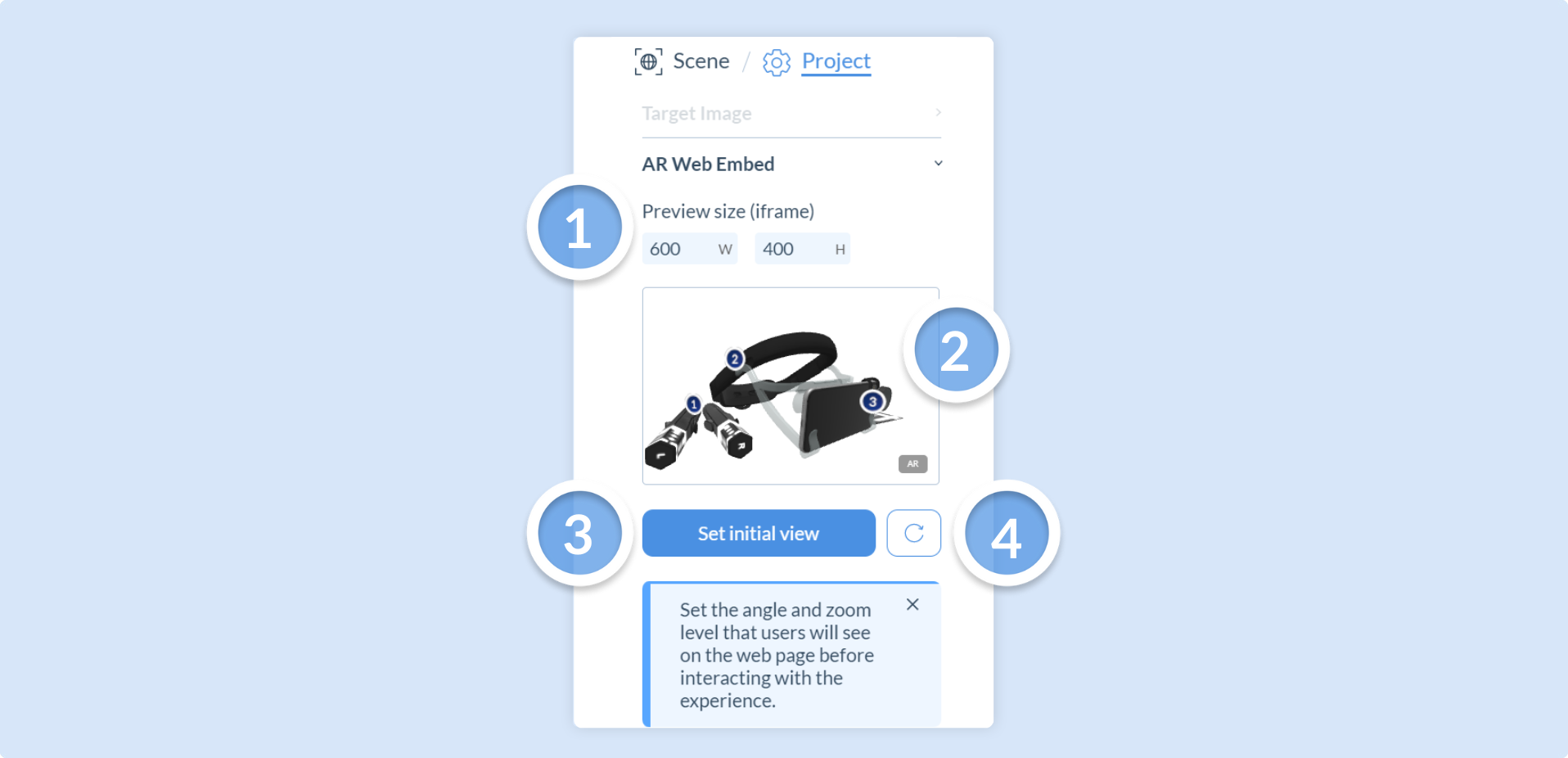

Preview Window Properties Description
Preview size (1) Set the width and height of your iframe window. You are not restricted to a certain aspect ratio and these dimensions can also be changed within the iframe code.
Embed Preview (2) A live interactive preview window of how your iframe will look and function on your site according to any properties you change in this panel.
Set initial view (3) Set your embedded content view to the camera view of your Designer project.
Reset Button (4) Reset the embed preview window back to the initial view.
Any changes made in the User Interface or User Control properties below will update the live interactive preview window above, even without publishing. This is a great way to quickly test how each property affects your embedded content. However, make sure to publish if you want to see the changes on your website.

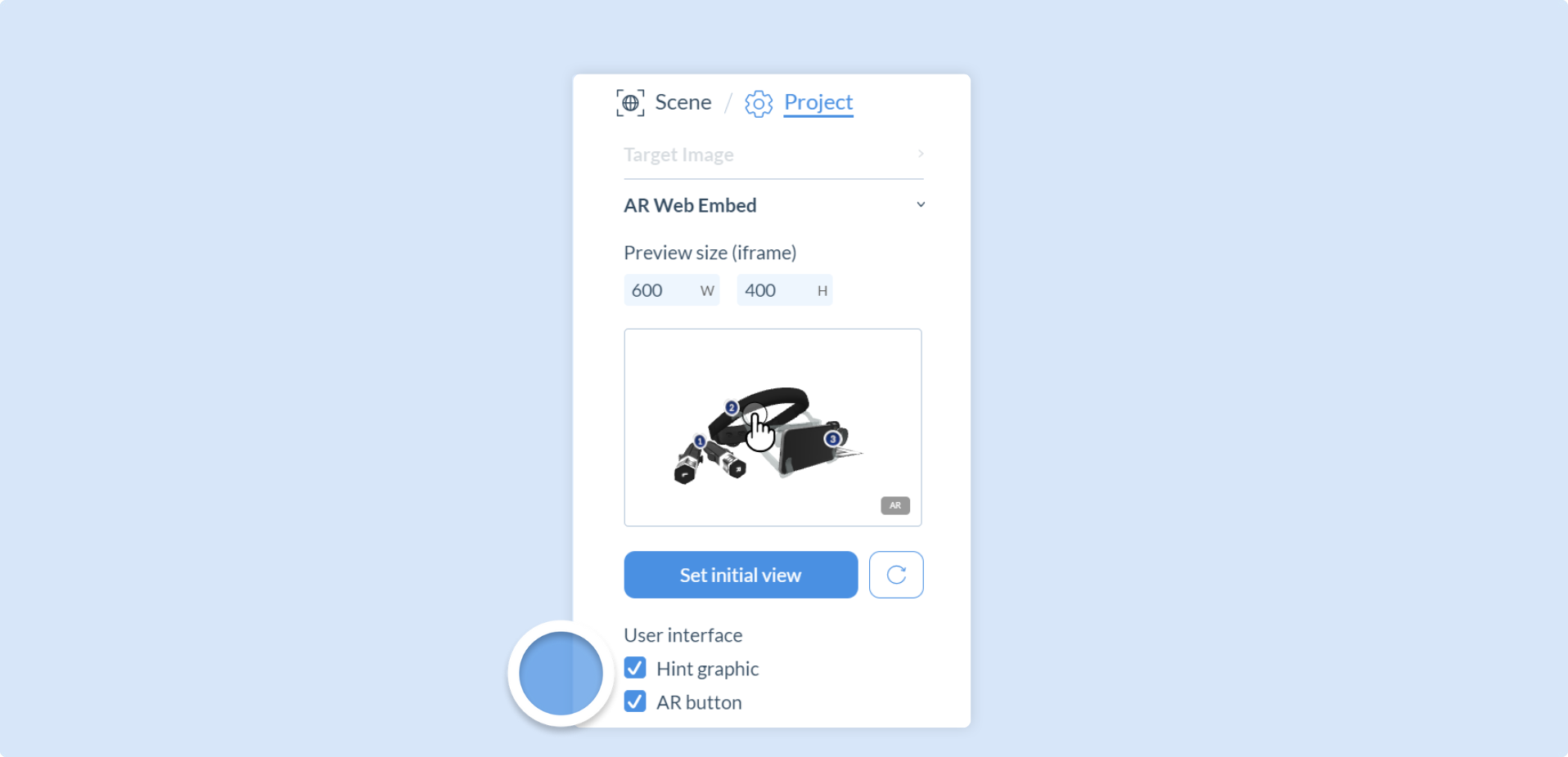

Changing User Interface properties
These properties will change specific graphic elements that appear in the embed iframe.
AR Web Embed user interface control properties
User Interface Properties Description
Hint graphic Show a little animated hand graphic to notify users that they can interact with the embedded content.
AR Button Show the AR button graphic at the bottom right that launches your embedded project in AR.

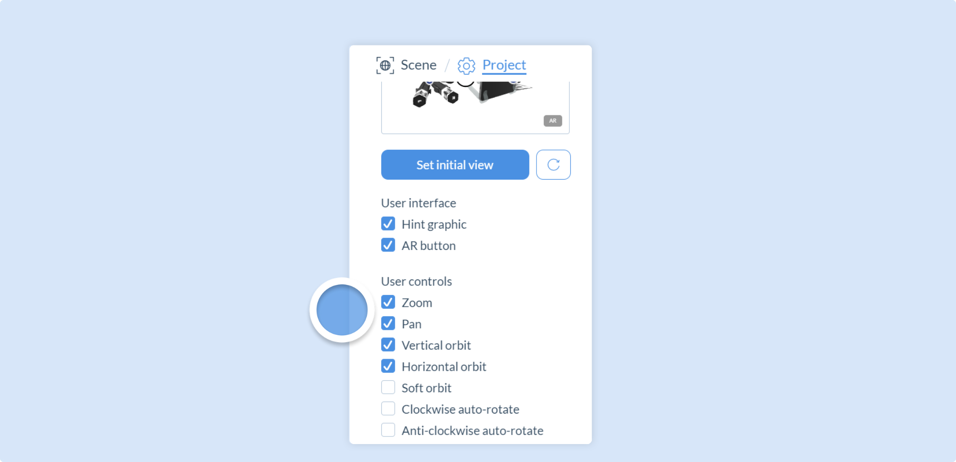

AR Web Embed user control properties
Changing User Control properties These properties will change specific control options for the embedded content in your scene to either limit certain user interactions or the general behaviour .
User Control Properties Description
Zoom Allow users to zoom in and out on your embedded content.
Pan Allow users to right-click and hold to drag around the embedded content.
Vertical orbit Allow users to rotate your embedded content vertically.
Horizontal orbit Allow users to rotate your embedded content horizontally.
Soft orbit Allow users to have a more controlled rotation on the orbits.
Clockwise auto-rotate Enable your embedded content to automatically rotate clockwise.
Anti-clockwise auto-rotate Enable your embedded content to automatically rotate anti-clockwise.
