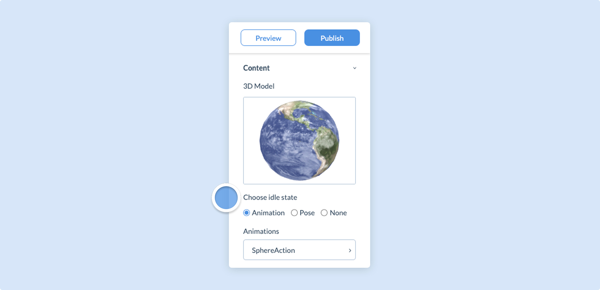

Playing an Idle Animation
Section titled “Playing an Idle Animation”If you have animations embedded in your 3D model, you might want to play an animation or set a pose without any interaction from a user.
Idle states last forever and play when no other animations are triggered.
To set an idle pose or animation, first click on your 3D component in the scene if it is not already selected. Then, find the Project Properties panel to the right of the canvas and make sure that the Content drop-down option is selected. From here, you are able to choose your 3D model’s idle state:
Idle State | Description |
Animation | Automatically plays and loops the chosen animation. |
Pose | Sets the initial pose of the 3D model with your animation frame of choice. This pose will always be static. |
None | No animation selected. |
