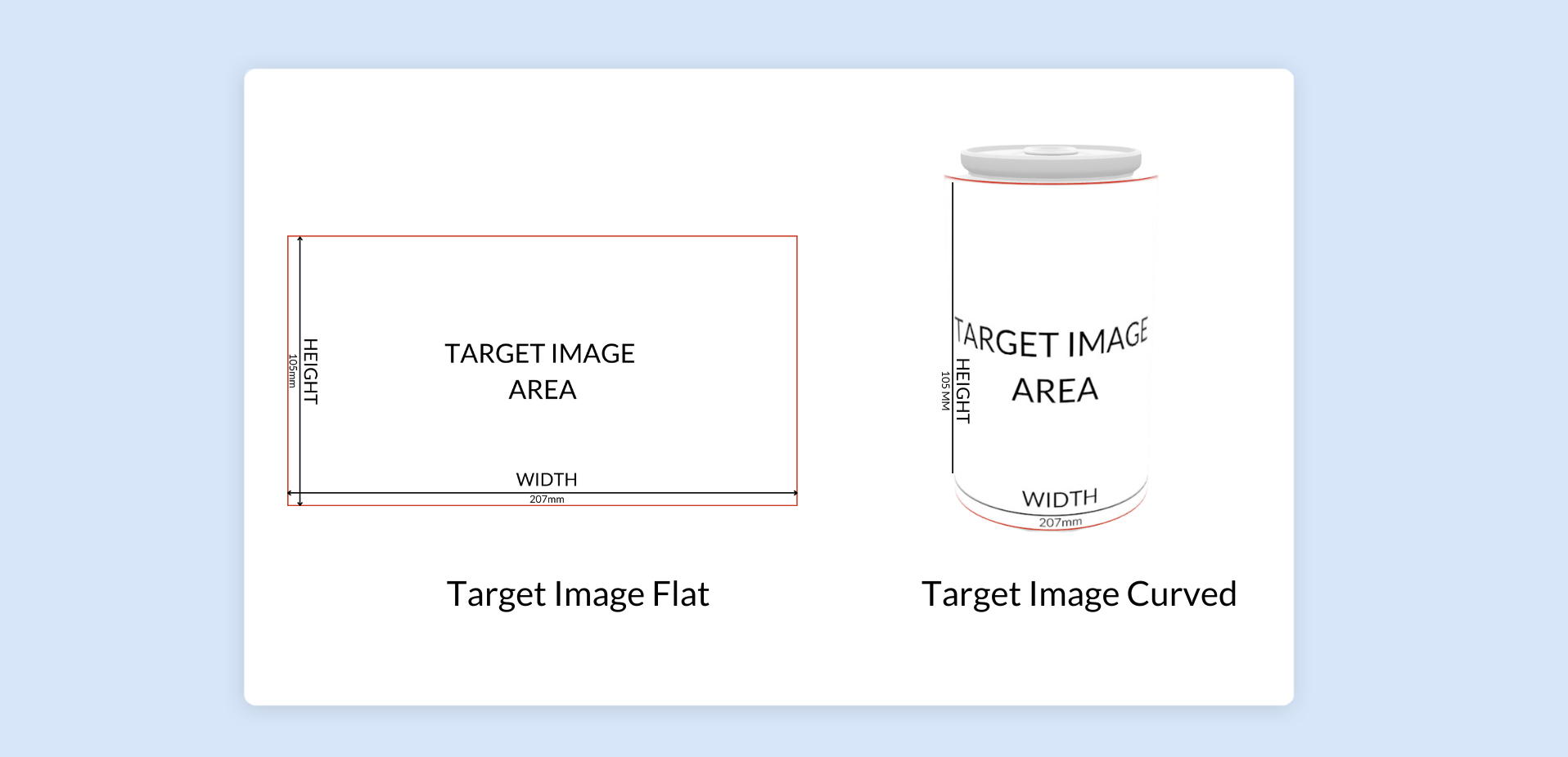

Curved image trainer dimensions for a fully wrapped target image
When curving your target image, it is important to consider the key dimensions: height, width, and the radius or circumference of the object where you plan to place the image. Ensure that the dimensions of your target image align with the specific area where it will be attached to the object.
For example, let’s consider a standard 330ml can with the dimensions 207mm (width) x 112mm (height). Suppose you have a target image that you want to fully wrap around the can, but only cover a certain height of the can’s body. In this case, the target image’s dimensions may be 207mm (width) x 45mm (height).
To ensure a seamless wrap of your components, such as a video around the can, you would enter 207mm for both the width and circumference in the Curved Image Trainer. Avoid using the height dimension of the target image in this scenario, as it does not match the true height of the object, which would result in a slightly incomplete wrap.
Ensure that the components you use in your experience have the appropriate aspect ratio and resolution to be curved correctly on the intended part of the target image.

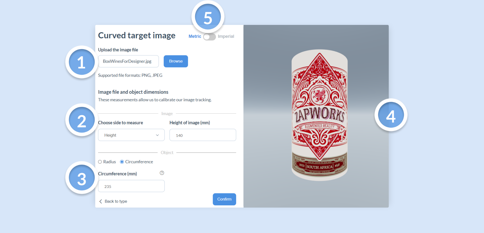

Section titled “Creating Your Curved Target Image”Once you have uploaded your target image, you can enter the dimensions for both the target image and the object it will be on. There is also an interactive Target image preview window that will show the curved target image with the associated dimensions.
| Section | Instruction |
| (1) Upload the image file | Click the Browse button to navigate your local files and select your target image. |
| (2) Image file dimensions | Choose which side of the image you want to measure. Select either Height or Width from the dropdown menu. Then enter the corresponding dimension of the image in the input box provided. |
| (3) Object dimensions | Specify which measurement you want to use for the dimension of the object: Radius or Circumference and enter the measurement in the input box. |
| (4) Curved target image preview window | As you change the dimensions, you will see your target image curving accordingly. Interact with this window by clicking and dragging the target image. |
| (5) Metric or Imperial toggle | Use this toggle to change the measurement units between millimeters (mm) and inches (in). |
Make sure you press Enter on your keyboard to confirm the dimensions.

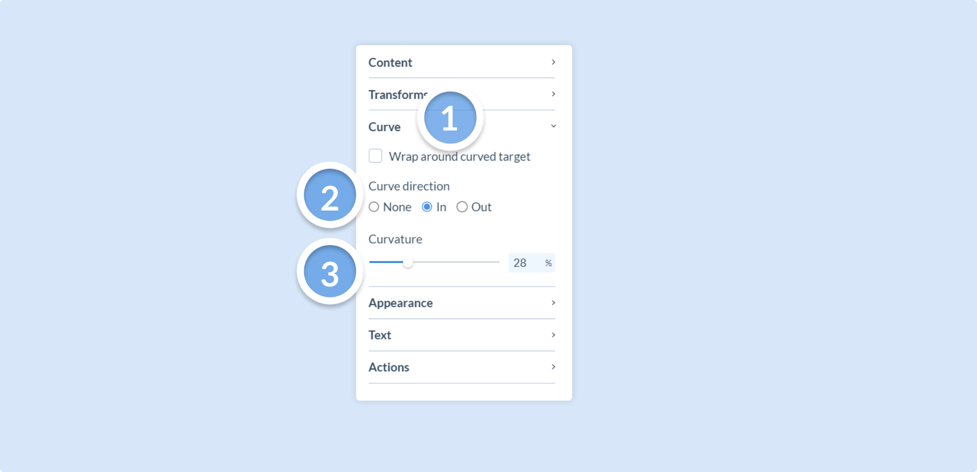

Section titled “Adding Curved Components”Although your target image will be curved, your Components will not be by default. To place them around your curved target image, there is a Curve property in the Project Properties panel when you select any Component, except for 3D and Applets.
The Curve property has a few options to easily modify the curvature of Components, they are described in the table below.
| Property | Description |
| (1) Wrap around curved target | Checkbox to enable or disable wrapping the media component around the curved target. Changes the transform gizmo for curving. |
| (2) Curve direction | Alter the curve direction for the media component. Options include None, In, and Out. |
| (3) Curvature | A percentage slider to adjust the amount of curvature applied to Components. |
If the Wrap around curved target checkbox is checked, the options above are unavailable for modification, but you can still scale, position and rotate the Component, relative to the target image.
