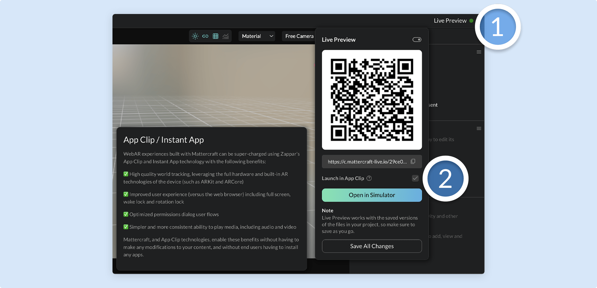

In Mattercraft, the Live Preview pop-up provides an option that allows you to test your project in the App Clip as you’re working on it, with the full set of benefits of the Live Preview feature.

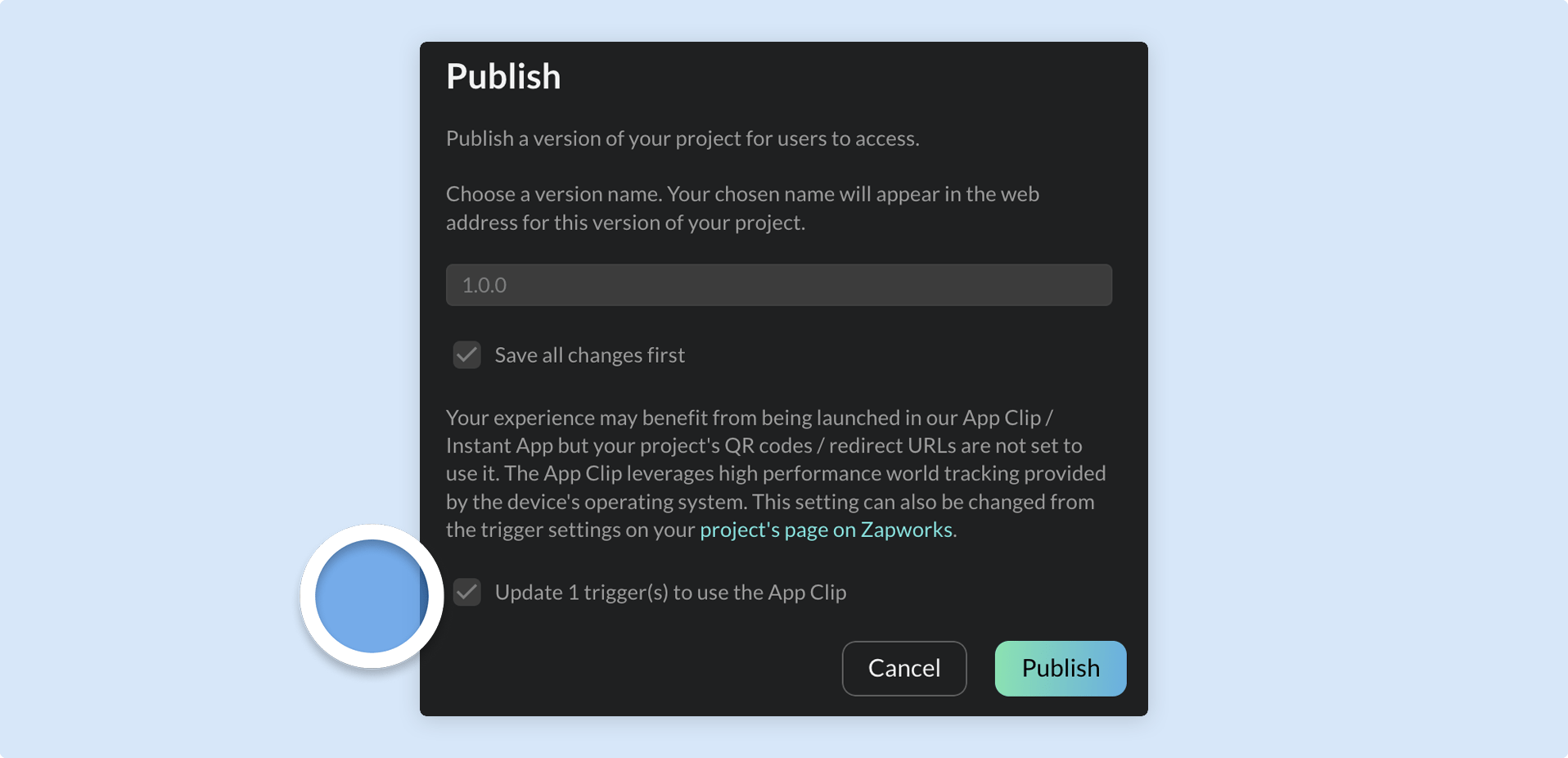

When you publish a project in Mattercraft that may benefit from being launched in the App Clip, Mattercraft will give you the option to automatically update your project’s triggers to use it.

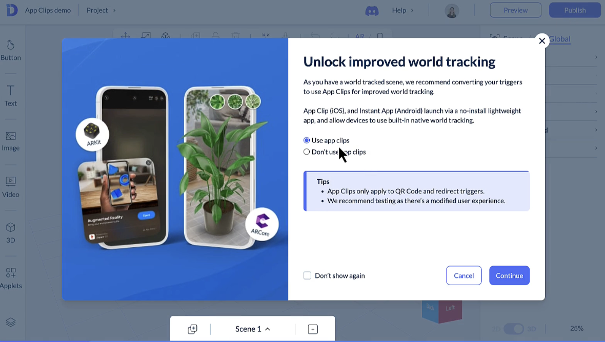

Designer will automatically suggest enabling App Clips for projects containing a world tracked scene, but it’s worth noting, for projects only containing image or face tracking, regular WebAR is still your best bet.
