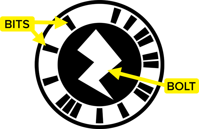

Section titled “Customising your Zapcode”One of the key benefits of zapcodes is that the design of the code is more appealing to the viewer than the industrial, purely functional design of traditional barcodes.
However, the default black & white style might not be the best choice for every design. Before trying out different designs, it’s important to understand what’s happening when a zapcode is being scanned with Zappar.

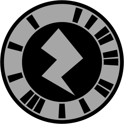

Bit Extension
Section titled “Bit Extension”Another useful thing to note is that the ring around the outside is purely aesthetic, so these two zapcodes are both valid:

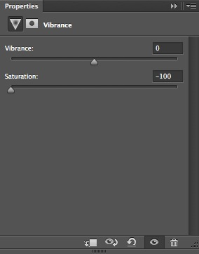

Section titled “Integrated Design”Now let’s take a look at how we can use this knowledge to deeply integrate the zapcode into some artwork. This is the front cover of our ‘Little Book of Zaps’, and the character on the front is sporting an unconventional looking code. This code has 3 main colours (which are close enough to two when viewed in grayscale” ).
