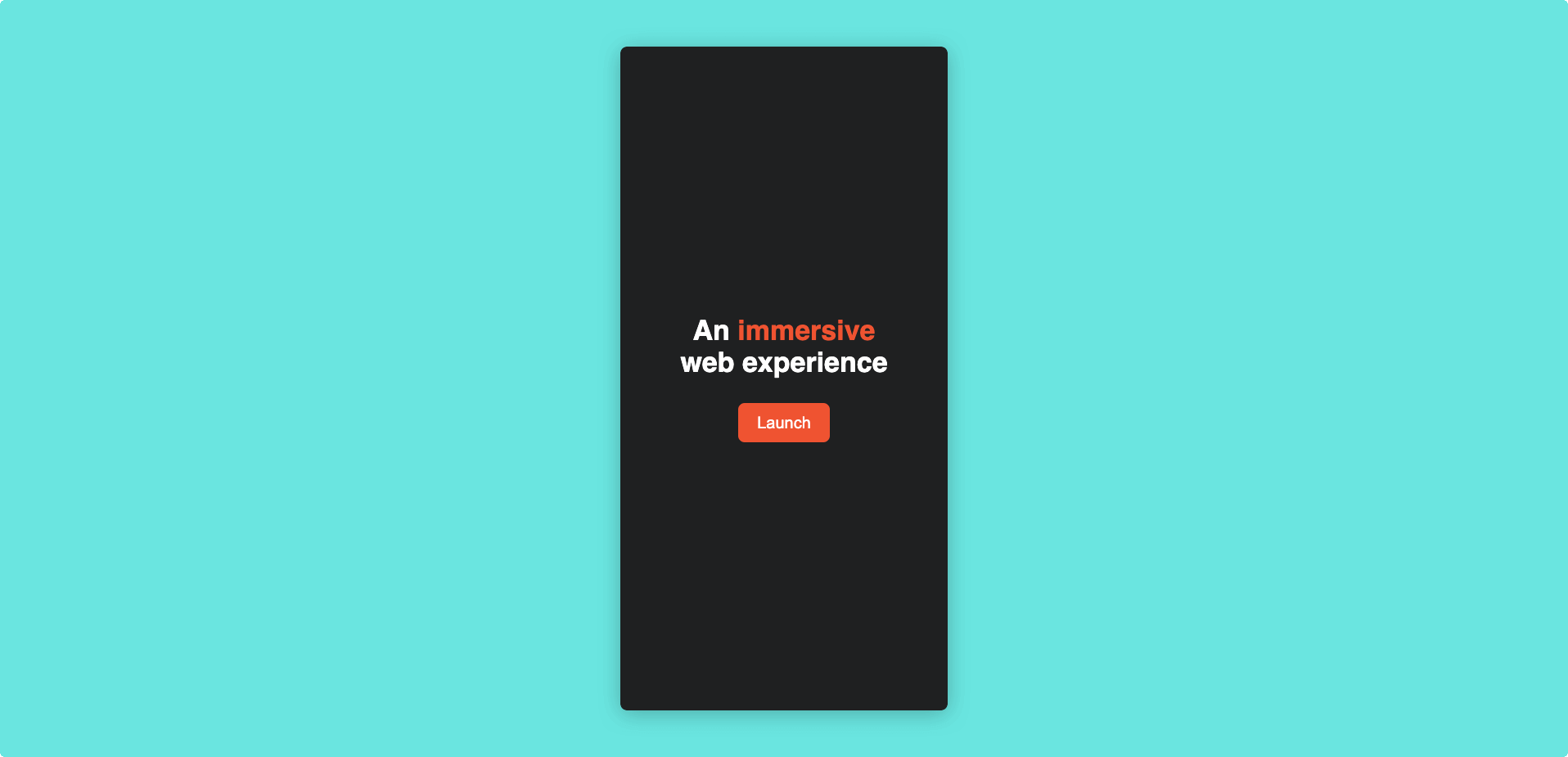

The default splash screen provided by Mattercraft
By default, Mattercraft provides a splash screen that appears when your project loads. However, you can easily update or replace it with your own custom design to match your brand or project's theme.

The default splash screen in Mattercraft can be found in the index.html file within your project files.
Customizing the default splash screen
To edit this splash screen, follow these steps:
  1. Open the index.html file
  2. Customize the content and styling of the splash screen to your liking. You can change the text, add images, or apply CSS styles to create a visually appealing splash screen that reflects your project's identity
  3. Save and preview your project to ensure that the updated splash screen appears as expected
