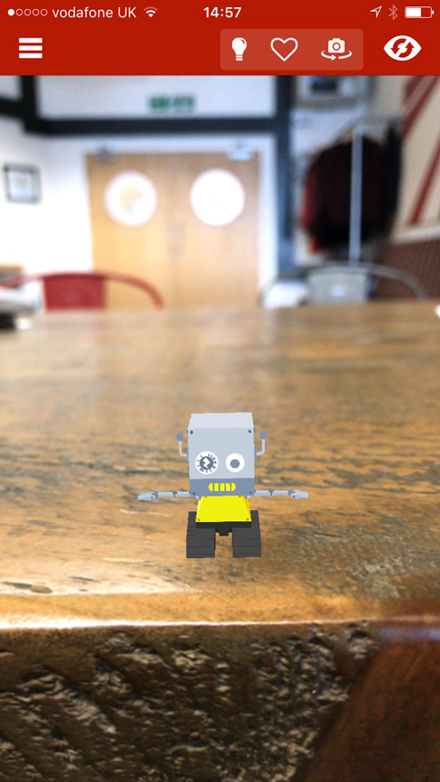

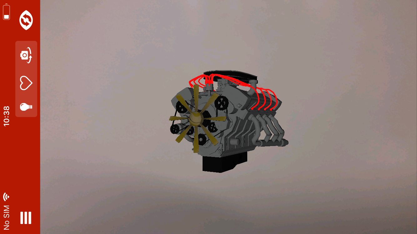

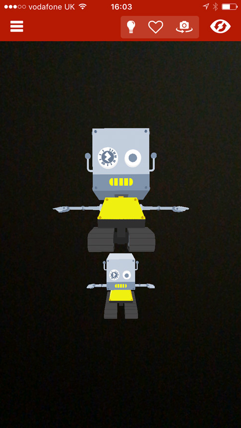

Test #3 - Tracking image
Section titled “Test #3 - Tracking image”Tracking image required - you can find the image to print at the top of this page.
This code tests the ability to track content to an image.
Success:
Without the tracking image in the device’s camera view, there should be a message stating ‘Tracking image not seen’.
When the tracking image is in the device’s camera view, a 3D model of a robot should appear tracked to the tracking image along with a green transparent plane and a message stating ‘Tracking image seen’.
Failure:
The tracking image fails to be detected in the device’s camera view.

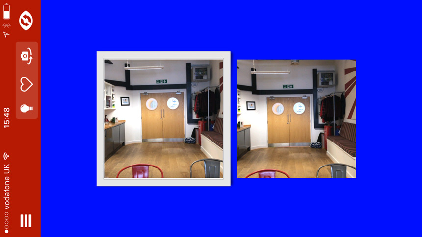

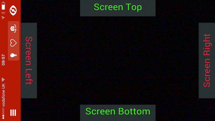

Test #4 - Screen relative
Section titled “Test #4 - Screen relative”Please hold your device in landscape orientation for this test.
This code tests content relative to the device’s screen.
Success:
You should see the following labels appear on the screen. Note that the background is black because the device has been placed camera facing down on a table, you should see the camera feed in the background.
Failure:
The labels do not appear as shown in the screenshot above.

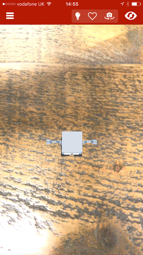

Test #11 - 3D model
Section titled “Test #11 - 3D model”This code tests the ability to display 3D models with animations.
Success:
A 3D model of a robot should appear on the screen and wave.
Failure:
The 3D model does not appear or the waving animation does not play.

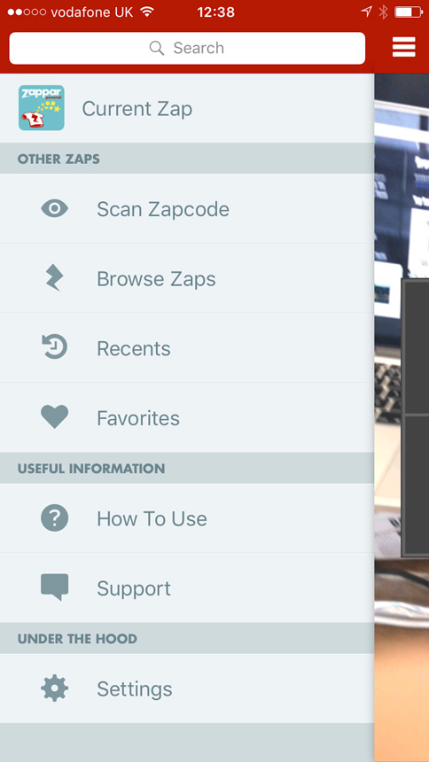

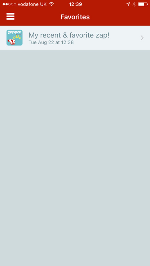

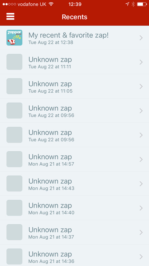

Test #16 - Recents & Favorites
Section titled “Test #16 - Recents & Favorites”This code tests the ability to add an icon and name to your zap to identify it.
Success:
After scanning the code and pressing the ‘Recents’ menu option in the Zappar app (located within the burger menu in the top left) you should see the experience called ‘My recent & favorite zap!’ along with an icon.
Pressing the heart icon after scanning the code will add it to the ‘Favorites’ menu section with the same name and icon.
Failure:
The icon and name do not appear.

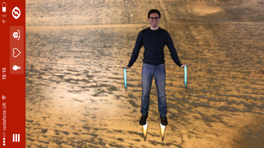

Test #24 - Alpha video
Section titled “Test #24 - Alpha video”Please hold your device in landscape orientation for this test.
The code tests the ability to display video with areas of transparency.
Success:
A video of one of our founders will play, including areas of transparency. Note this video has no sound.
Failure:
The video does not play or render correctly.

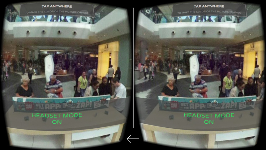

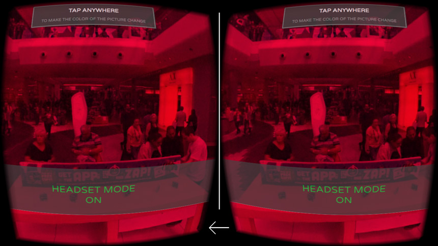

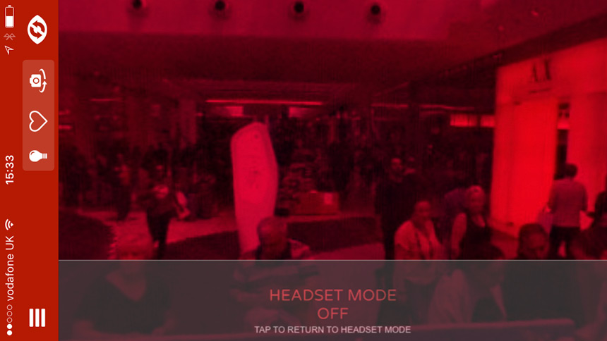

Test #28 - VR
Section titled “Test #28 - VR”Please hold your device in landscape orientation for this test.
This code tests VR capabilities.
Success:
The experience should launch in headset mode (for use within a google cardboard or similar).
Pressing anywhere on the screen while in headset mode (besides the back arrow in the bottom center) should change the color of the environment to red.
Pressing the back arrow in the bottom center should switch to normal viewing mode.
Pressing the ‘return to headset mode’ prompt when in normal viewing mode should return to headset mode.
Failure:
Any of the above interactions or viewing modes do not work as shown.
Test #29 - Camera texture
Section titled “Test #29 - Camera texture”Please hold your device in landscape orientation for this test.
This code tests the ability to use the device’s camera feed as a texture.
Success:
A box showing the camera feed should appear on the right with a white picture frame box on the left.
Pressing on the camera feed box should apply the current frame of the camera feed onto the picture frame. This step can be repeated to update the picture frame.
Failure:
The camera feed does not display on the right-hand side or the picture frame box is not updated when tapping on the camera feed.
Test #30 - Camera transform
Section titled “Test #30 - Camera transform”This code tests the ability to set a focal length of a perspective projection. It’s a bit like the “zoom” factor in a real camera.
Success:
There should be two 3D models of a robot with the one on top appearing closer/larger than the one beneath.
Failure:
The 3D models do not appear as shown above.
Test #31 - Screen size constrain
Section titled “Test #31 - Screen size constrain”Please hold your device in landscape orientation for this test.
This code tests the ability to scale content to always fit between two defined values.
Success:
The plane on the left (without the screen size constrain) should appear to move backward and forward while the one on the right (with the screen size constrain) should appear stationary.
Failure:
The two planes do not behave as stated above.

Test #39 - PBR material test
Section titled “Test #39 - PBR material test”This code tests whether a model with a PBR material will render correctly.
Success:
The 3D model is displayed on the device’s screen, as shown below.
The model uses an opacity map, the bottom of the model should appear transparent.
Failure:
The 3D model is only partially rendered, or not at all.
