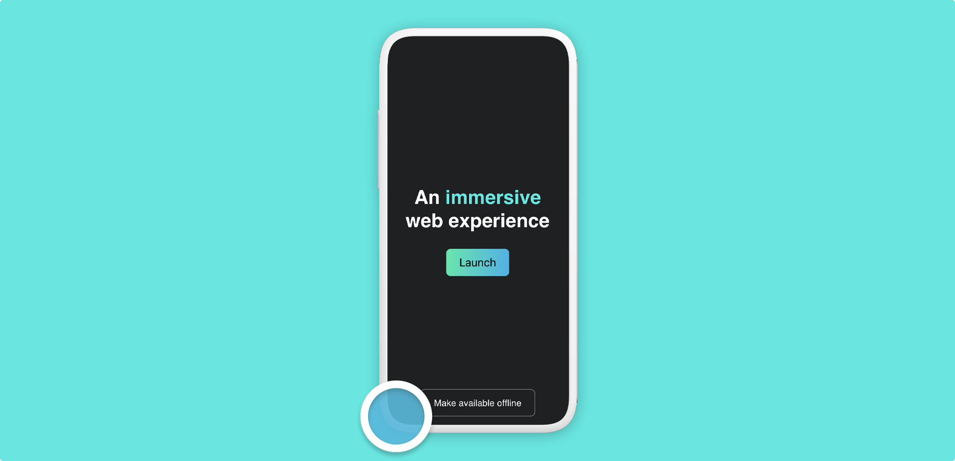

End User Experience
When an end user first visits an experience that has Offline Mode enabled, the browser will proactively download and cache the project’s files and assets. An on-screen user interface is shown to notify the user of the progress and completion of this process.
A custom Offline Mode user interface
One the download is complete, that page can be accessed by the user later, even if they don’t have a network connection on their device, or if their connection is slow.

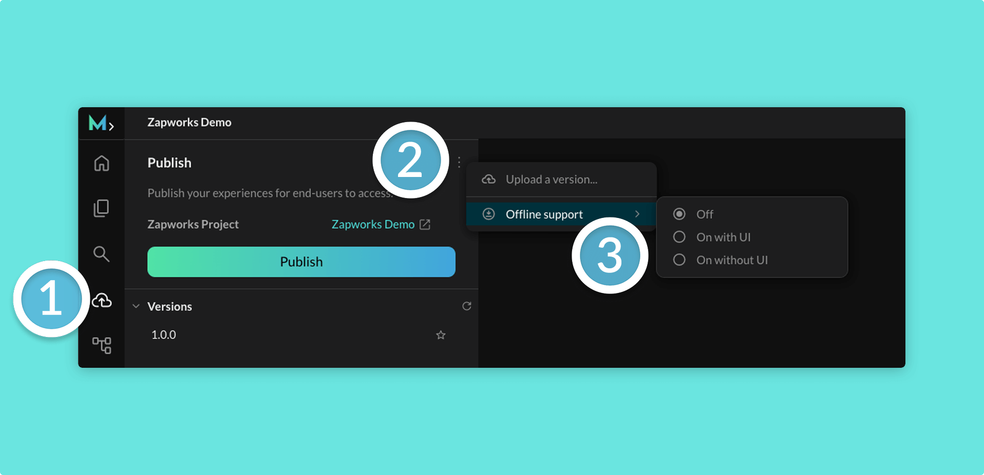

Enabling Offline Mode
Offline Mode can be enabled from the Publish tab’s menu:
Offline Mode options via the Publish tab in the Left Menu
There are three settings for Offline Mode:
Setting Description
Off No attempt is made to make the experience available offline. This is the default setting.
On with UI When users visit the page, the experience will attempt to download the necessary files and assets for offline access. A simple on-screen user interface will be shown to the user, both to indicate the status of the download and when there is an update to the site that requires a reload of the page.
On without UI Support for Offline Mode is provided by Mattercraft, but no default user interface will be shown to the user to indicate status. With this option, we highly suggest adding custom UI of your own.
